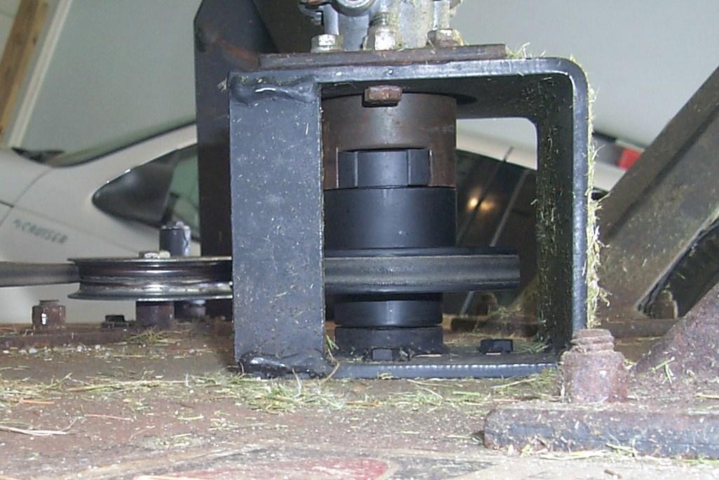

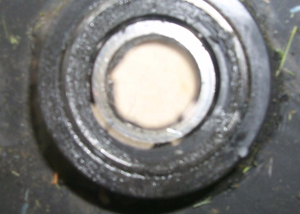

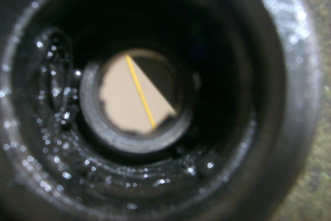

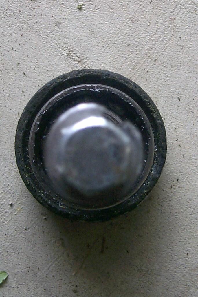

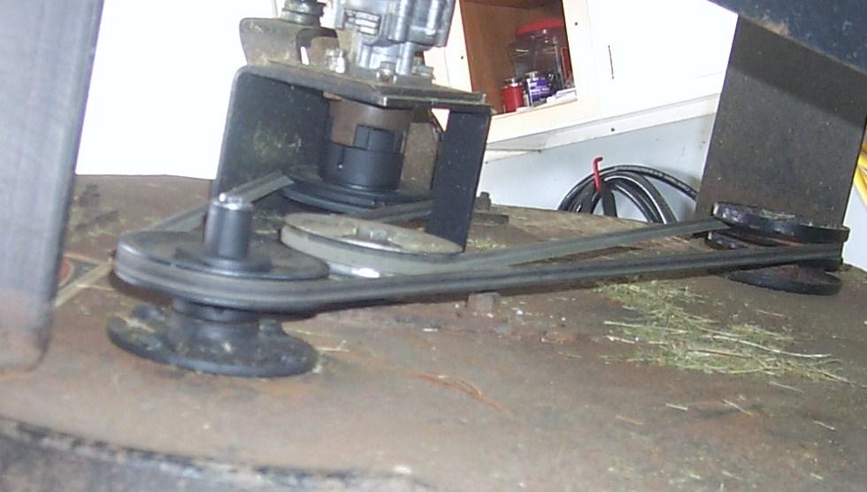

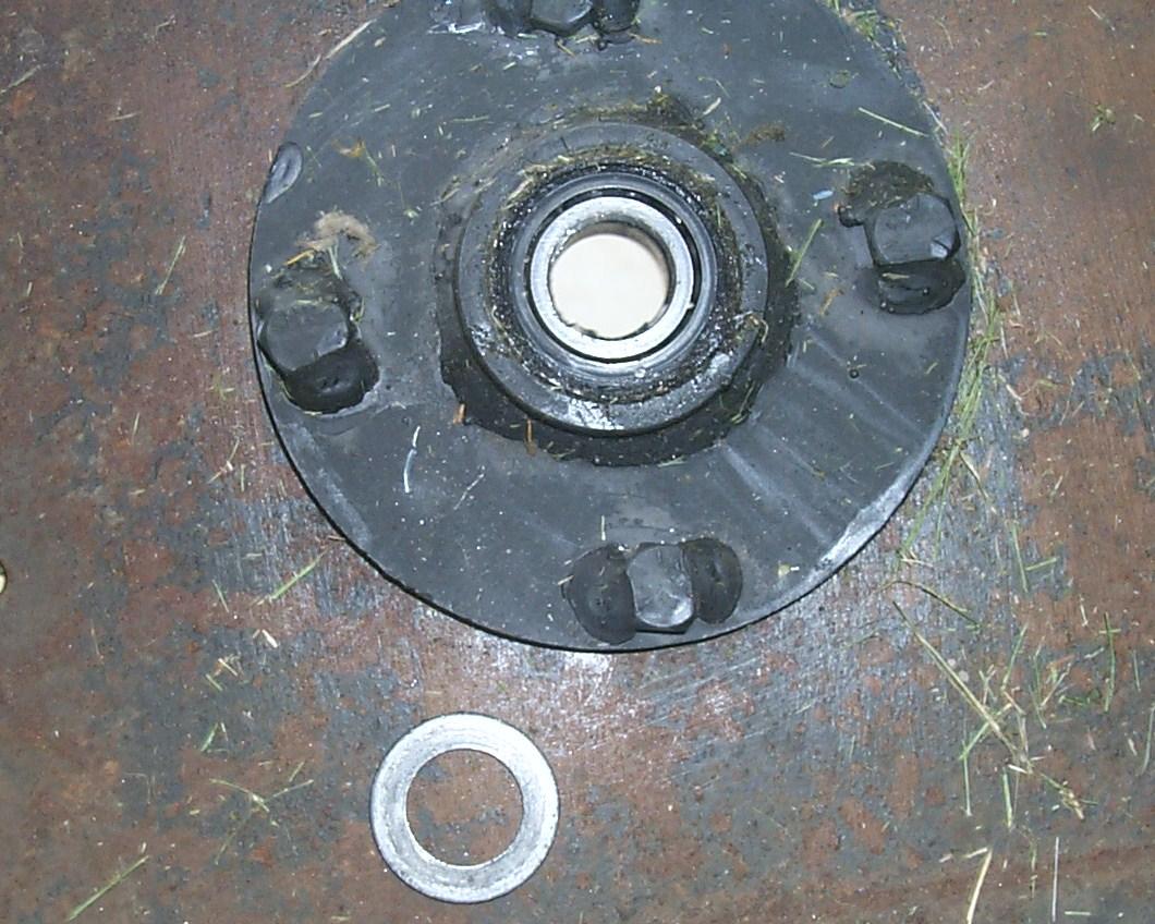

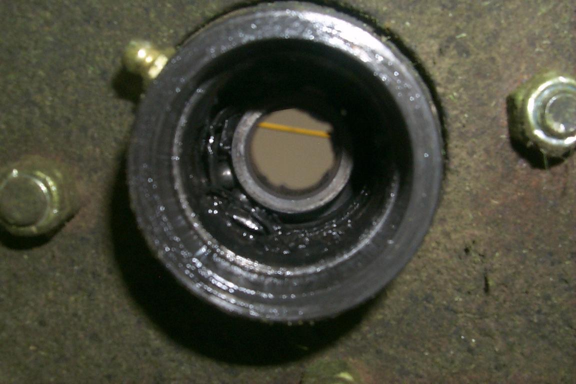

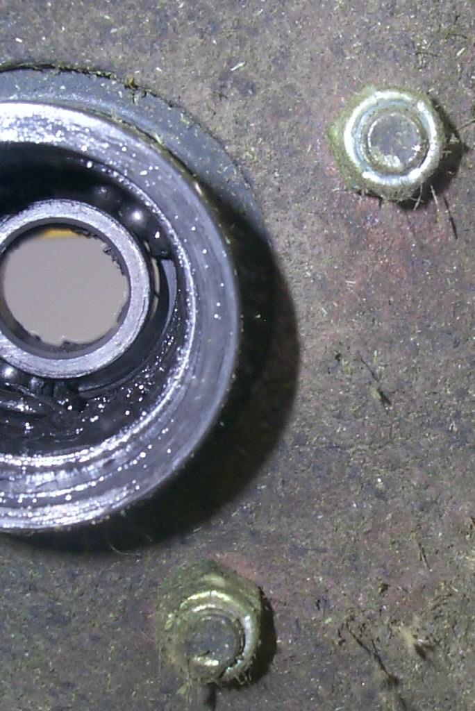

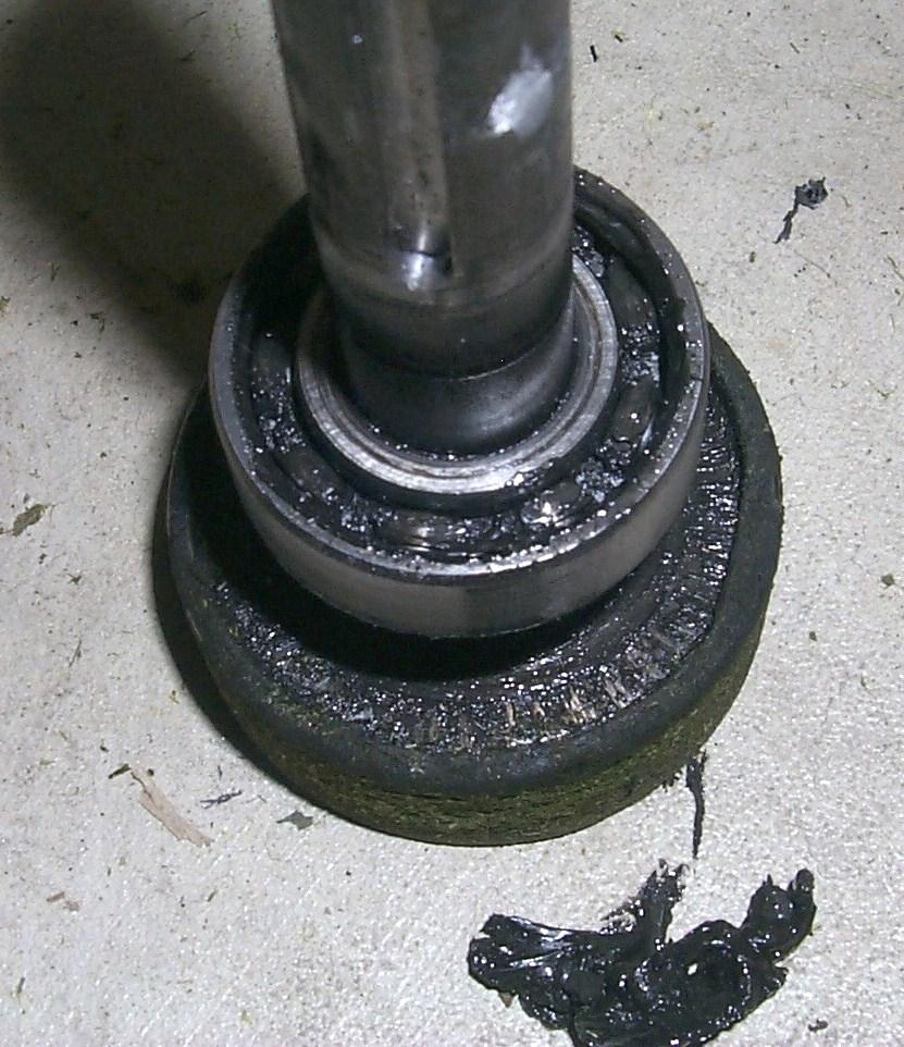

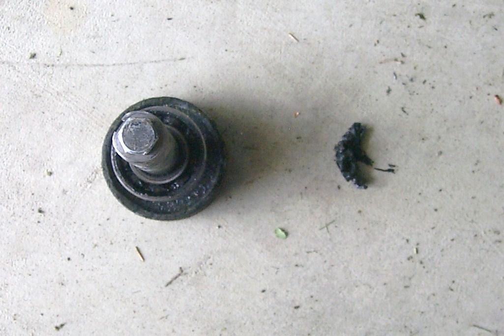

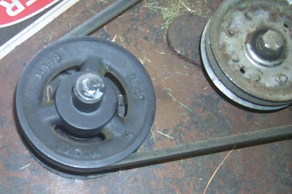

A couple weeks ago I put out $250 to PT for the center and outside spindle.
This was for the complete unit.
After install, I mowed and everything went good. Taking another members suggestion, before and after mowing I do a "wobble" check, by grasping the blade to see if any side to side movement.
The second time out with the "New" parts, I thought I heard a strange (not the usual) sound. After about 10 minutes of mowing, removed the cover (belt, pulleys) turned the PTO back on for approx. 5 seconds, and notice the outside spindle pulley, now and then, wobble about an 1/8 inch out of line. Also, the "wobble test" confirmed movement also.
Took spindle apart to check bearings...viola...junk - trash - broken!
Called PT, Terry said he would send a whole new unit to me right away, and for me to send the old back to PT.
Will update when I get the new, install, and test.

Did you grease those bearings? If you over grease them, there is the potential to blow out the seal(s). Since discovering they were sealed bearings (and finding a blown seal in a bad bearing), I changed my procedures.
I now grease only lightly by hand, stopping if it feels like the cavity might be full. I never use my air operated grease gun on the spindles. The grease serves no lubrication purpose, but probably does help heat transfer and may help prevent corrosion inside the spindle housing.

SnowRidge,
Yes.
2 to 3 pumps with a manual grease gun.
To put the unit on, you have to remove the zerk fitting. Though I did not use a light to look into the hole of the fitting, it did not look like it had much grease if any in there.
That is why I put the 2 to 3 pumps with the manual gun.

That wouldn't hurt it. I wondered if you might have pumped it full.
They come without any grease in them, AFAIK (sorry, JJ ;)). Obviously a bad bearing from the git go, or bad machining of the housing/spindle by the supplier.

Were those bearings sealed bearings to begin with, or just plain? As you were installing the bearings, did you spin them to see if they had grease in them. If they are full of grease, they don't spin very well, while a bearing with no grease will spin quite freely. Some bearings come with 2 grease seals and others with one. The open side goes to the inside of the spindle. If you have true sealed bearings, there is no reason to put grease in the spindle. except to keep the shaft and inside walls from rusting, and maybe keeping water out. Over greasing is also a big problem. A lot of people squirt grease in there ever so many hours. When that spindle is full and more grease is put in, the excess is pushed out the ends , top or bottom.
Sometimes what you think is bad bearings, is, the round spindle is not round anymore. The bearing and unbalanced blade will beat or wear it out of round. You can sometimes fix or use the spindle by drilling a hole and installing a set screw to keep the bearing from wobbling. My complete spindle cost around $85. I used to keep spare spindles in the truck, one short and one long, so I could change it out in the field. I would rebuild the other spindle later.

Several owners have looked for another source. No luck so far, but if you catch them early, it's just a bearing change. Doing the "wobble test" works. I caught one as it was about to go out.

There is something that I am not seeing. That is the sleeve that goes over the spindle inbetween the bearings to keep them from being coompressed to much, and if not there, then I kow why the unit failed. If not there, and you tighten down the nets and bolt to much , you can expect failure.
/ Belt for 48" deck #139
No sleeve is needed. The design of the bearing housing and the spindle locates the bearings properly.
