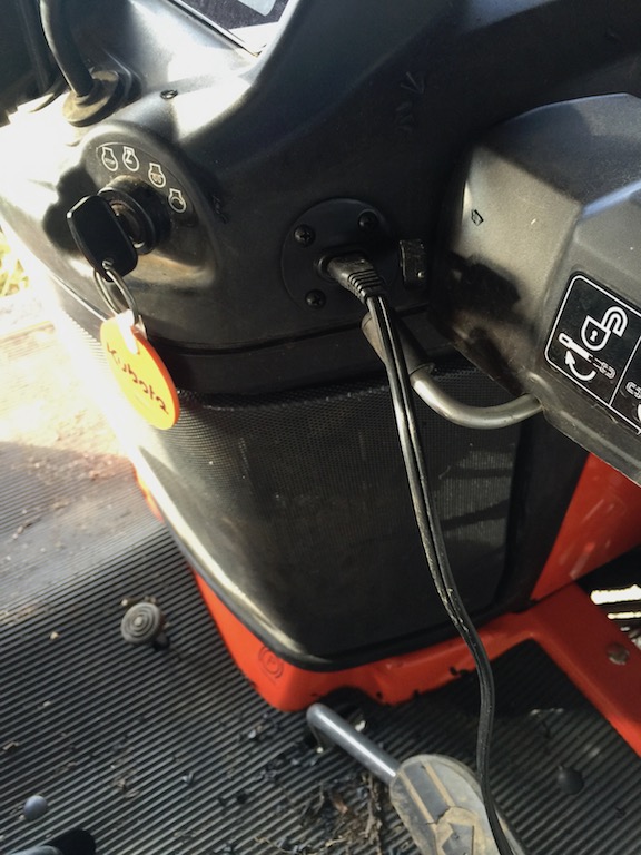

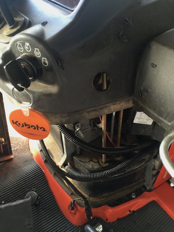

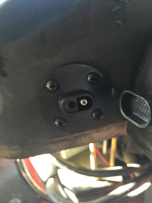

This is what I did. Permanently connected leads to the battery that came with the battery tender and installed a quick disconnect panel on my dash.

I also put a 12v male plug on my trickle charger and a 12v socket on my tractor. I can move the charger to anything that has a 12v hot socket and charge away.
