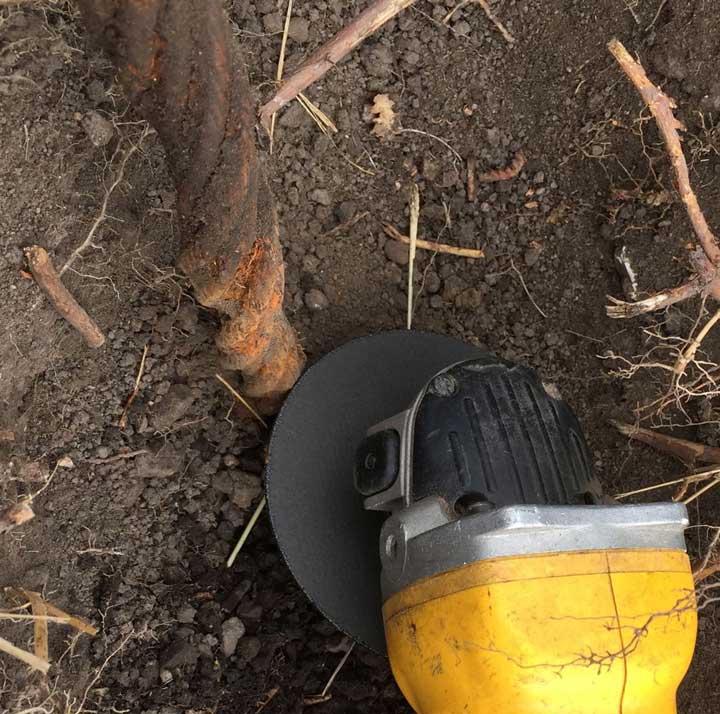

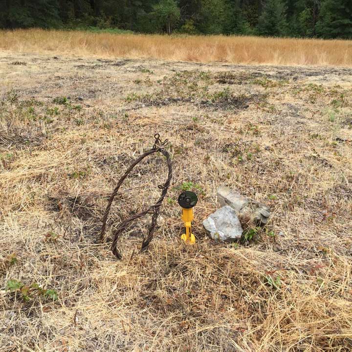

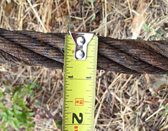

A thread was posted regarding ways to cut logging cable. Here is a test using a 10 year old DeWalt 18volt angle grinder. It stands to reason that the technology has improved in 10 years but I have never used anything but my old DeWalts. My batteries are 4 years old and past their prime. My batteries were 2.4Ah when new, and the new batteries have more capacity. A 4.8Ah battery would (in general) run twice as long as a 2.4Ah.
There is a tangle of rigging buried underground here. I mow this field twice a year and in between, I forget that I planned to cut that cable out of the ground. The 27HP tractor that I have can't pull it out. Today is the day to cut it out.

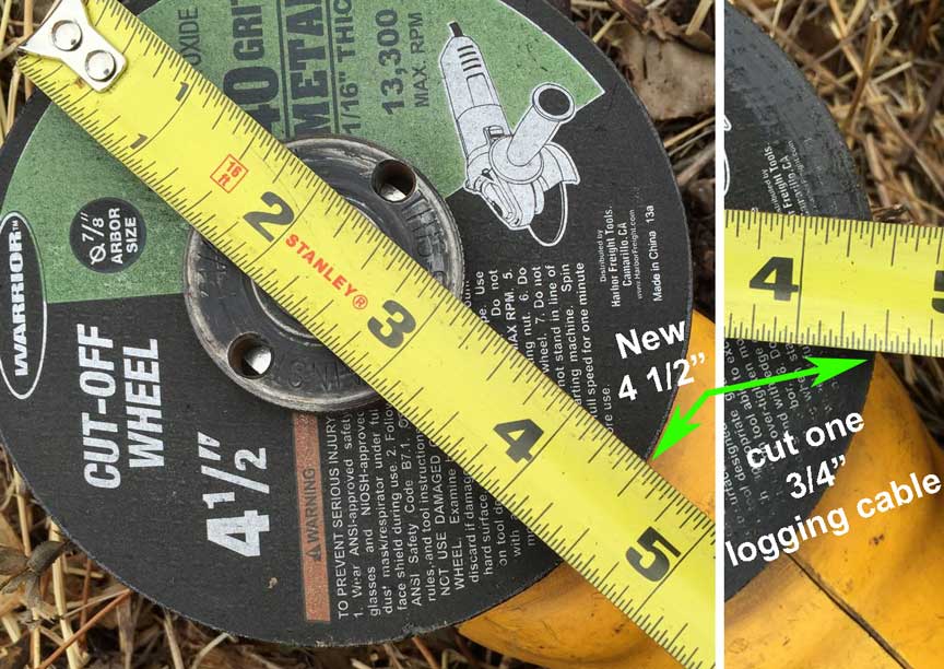

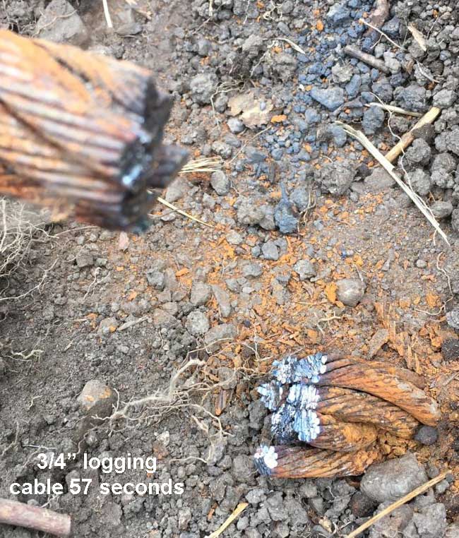

It took 57 seconds to cut 3/4" logging cable, and it used 1/16" of a 4 1/2" harbor freight abrasive cutoff disc. I don't know how many cables I could cut with one battery, I suppose between 10 and 20. And if you made no mistakes, the 4 1/2" abrasive disc might be down to 3 3/4" or so after 10 cables.
As the cable cuts, you can sometimes choose the best way such that it springs open and doesn't grab the disc. The strands can be under a lot of tension. If it's not cooperating you have to go at it from a different angle.

One way to help lessen damage to the thin cutoff blades is to position the grinder so the material being cut will pull the grinder forward (throwing sparks at the user's hand) if it snags. Don't apply excessive pressure and let the disc do the work. With the material being cut is positioned to throw sparks to the side, or away from the operator, the tool's movement is greater when it catches.

I've got a lot of time using skinny wheels, they really eat through material but need a great deal of respect. Since the best ones are the 6" Metabo .0625", they are quite fragile and side loads or binding will grenade them. Also, you want to have a very firm grip on the grinder, if it gets away from you it can do severe structural damage to a hand and a heavy welding glove won't even slow it down. Look at each cut as if it were a chainsaw in wood; will it close up and bind or twist and bind? If so, change your approach and or block or clamp so it can't bind.
