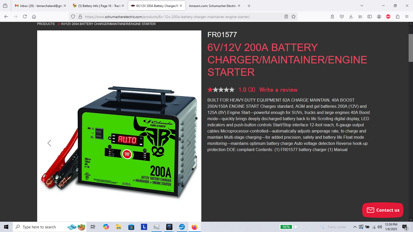

The big roll about charger look impressive but when you get right down to it, most of them do not have much or any benefit over the small battery chargers.
same capacity it a small simple carry around size,
same capacity in a small simple carry around size,
Agree. Something like a 2/10/50 seems sufficient for automotive use. Worst case leave it on the battery for a short while, set on 50, to put some energy into the deficient battery.
The starting assist shouldn't come entirely from the charger, rather the charger and battery should both contribute to the starting effort.
I picked up a big rolling one recently. Mostly because I wanted one with the manual knobs & no smart electronics. Makes doing things like using it to test starters or power electronics projects easier. Realized it only does 20@ on 6v though, which is annoying. Half the reason for it was the 6v antique bulldozer.
Would have gotten a non rolling unit with smart charging like the one pictured otherwise.
