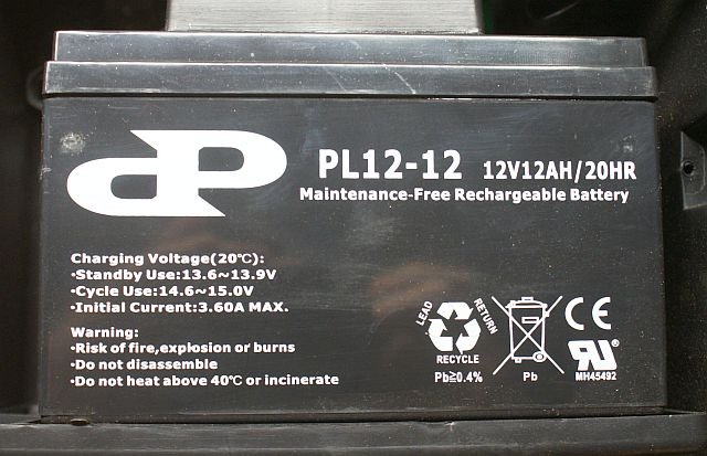

Well...the proof is in the pudding they say.
Remember me saying no matter what car battery I used, a new 700CCA or one out of a running car I could run tractor for hours and never get over about 13V.
Today I bought a 300 Everstart Walmart $39.95 mower battery. Tractor fired right up and running 14.54 volts. Headlights, tail spotlight on it drops to about 13v...but still bright. I shut it off, restarted several times it's like night & day. I even started with lights on...fired right up.
No it may not make sense, all I know is I'm happy and it works great. I just need to fabricate a holder for the smaller battery.

No, no matter, the larger auto battery was never charging properly. That is the science. Just because it was tested good means nothing. Your just hadn't damaged the battery. Your system charges the lower capacity battery way better than the larger battery hence better performance. The larger battery would ultimately die if it wasn't charged long enough.
Amp hour means nothing if you crank and engine starts quickly. If it takes 10 tries, and the engine uses up what power is stored, it ain't cranking. Yes you have to match the battery to the charging system for best performance.

By match I mean it should be as original for application as possible. I'm finding out a 20 amp charging system isn't a match for a high CCA battery.
No different than putting a 1/2 hp pump in a 500 ft deep well.
Again...only trying to help others by my many hours trial & error. I know what works.
Oh BS. There is no such thing as a battery being matched to a charging system.

"Matching" is not the answer to charging a battery.
I'm sorry. It's an innovative idea, but probably incorrect.
There is a minimum size (ampacity) battery required to turn the starter and start the engine. Any larger capacity battery will simply do the same thing for a longer time. "Matching" the charging system to the battery capacity is not real.
Everything you are seeing and measuring could also be due to a large battery that is able to develop cell voltage, but is not able to store much of a charge (amperage) in those cells. A possible cause for that is something in one or more cells is not allowing the plates to use their full area to store charge. The plates may not be properly isolated, there could be uneven sulphation due to how it was stored, or it may simply be one or more cells have a low amount or acidity of electrolyte.
Science starts with the simplest theory that explains the facts. A poorly built battery makes more physical sense than the electrical matching idea.

Charging a battery in it simplest terms is a combination of amps and voltage. Voltage needs to match the battety (in this case 12 volts), amps determines how quickly the battery will be charged. This is where matching does come into play and my disagreement with rScotty.
If you are relying on solely on the charging system of the motor, the battery and charging system need to be matched.
Frequent undercharged could lead to a state where the battery is consistently not getting a full charge and develops weak cells thus not being able to accept or hold a full charge.
so again unless regularly connecting an external battery charge to an oversized CcA battery, you are probably better off match the CCA’s to the motor requirements to start it (via mfg recommendations) which will result it it matching the charging system installed on the machine.
If a charging system is rated at 10 amps. It puts out approximately 10 amps for every operating hour at the rated voltage. If the 300CCA battery is totally depleted, it needs 30 hours of run time to charge as an example.
