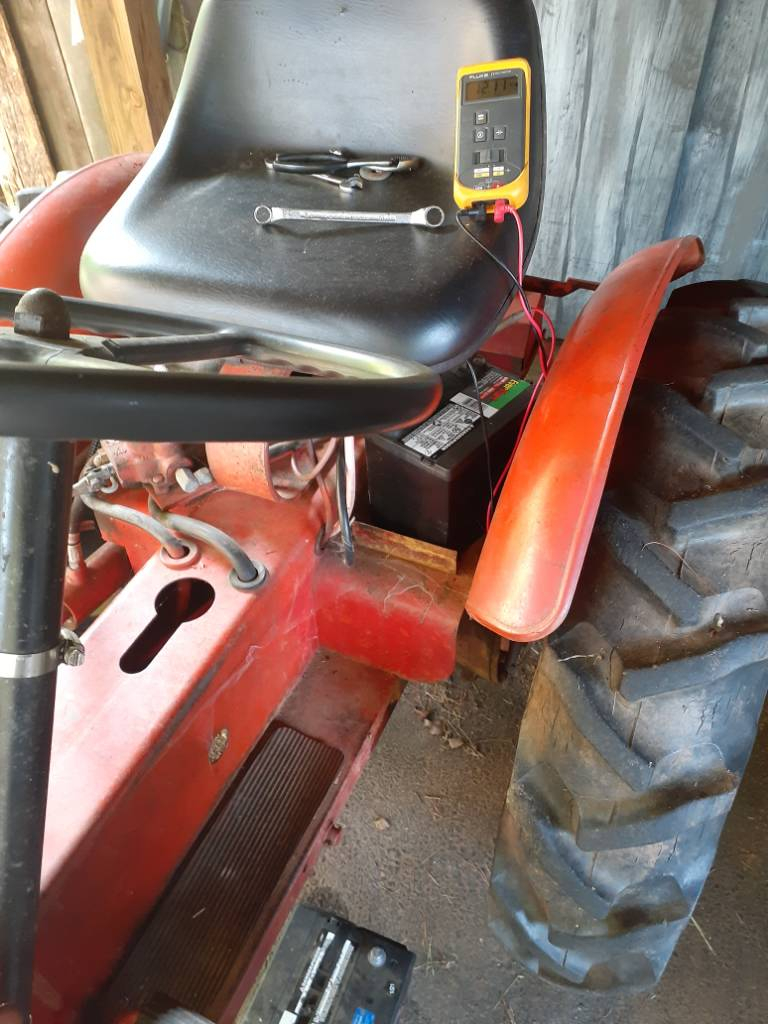

I have my granddad's Economy Power King tractor he bought brand new and a Cub Cadet garden tractor, both have same Kohler engine and about same vintage (1976,1979).
Economy came with a car battery, by that I mean a top post (12"x8"x7"). For years it's been hard starting, so I installed a new 700CCA battery. Still hard starting (I rebuilt carb, all new ignition, no help). Basically choke...crank, fiddling with throttle finally it will start. Many times out somewhere I'd park so I could get it rolling & pop start it.
Although battery was new, I had it professionally checked, it was good and actually measured 717CCA.
All ground connections cleaned, cables fine, solenoid & starter fine, the charging stator ok, I even replaced the diode/regulator module. Motor wide open I was lucky getting 13 volts at battery.

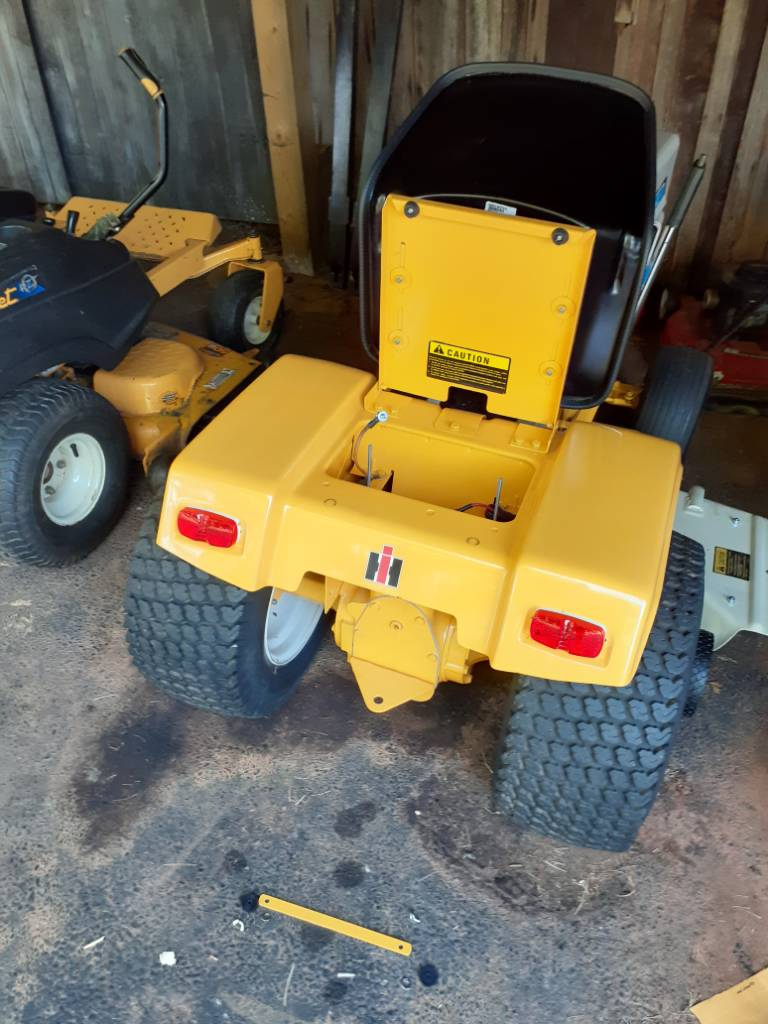

Cub Cadet has a new mower battery. It's a 300CCA (8"×6"×5"). It starts fantastically, choke and fires right up then choke off.
OK...today my GLOVES came off .
Both tractors haven't been run in a few weeks, so the surface charge was a little low. Here are the measurements at the battery using Fluke meter:
Economy, 700CCA battery:
12.45v static
11.30v cranking
12.70 full throttle (slowly climbing to
about 13v max. after 10 minutes)
Cub, 300 CCA battery:
12.14v static
9.91v cranking
14.20v full throttle
Then I put the little battery in the Power King:
Economy, using the 300CCA battery:
12.17v static
11.12v cranking
14.13v full throttle
With the small battery it starts, runs better. Of course lights are brighter.
I understand now it's more of a match to the charging system. Apparently the more than double cranking amp battery just wasn't able to spin motor over like you would think which doesn't make sense.
Everything has to match. The larger 70's top post car batteries must have been available with about 300CCA. How weird is that?

Changing battery solved the problem though! Changing back to large battery the problem reappeared.
What's going on is the stator+diode/regulator system is not able to keep the 700CCA battery charged and running like that voltage is low.
Using 300CCA battery the stator+diode/reg module is matched. It now runs at just over 14 volts, keeping battery charged and since the voltage is a little more cranks better.
I've spent many hours of experimentation and if I were to use large battery in Cub it would act like the Economy over time. Battery is so large I'd have to fabricate some way mounting it. It would crank Cub fine at first, but the Cubs same charging system wouldn't be able to restore that battery. Over time same thing, lower voltage gradually, lower running voltage (dim lights), until hard starting. Higher voltage means faster cranking, hotter spark, brighter lights, etc.
I'm telling all this hoping it may help someone. Over the years I've discovered some things you think would be an improvement like higher CCA battery may have opposite effect.

I posted only trying to help. As I said I had the new battery professionally tested. One thing I forgot to mention which eliminates the large battery and science theory is I replaced that with a known good car battery.
Same results! At first it started tractor great so I thought my troubles were over, but nope...same results, a downward spiral of ever slower cranking.
That's why I said in title how weird they are!
Logically the higher cranking amp battery would start better, more capacity, etc. which I'm sure it is.
Reality is the small battery starts Cub so well, now it starts Economy well.
Bottom line is it all has to match apparently, and maybe help someone.

By match I mean it should be as original for application as possible. I'm finding out a 20 amp charging system isn't a match for a high CCA battery.
No different than putting a 1/2 hp pump in a 500 ft deep well.
Again...only trying to help others by my many hours trial & error. I know what works.
