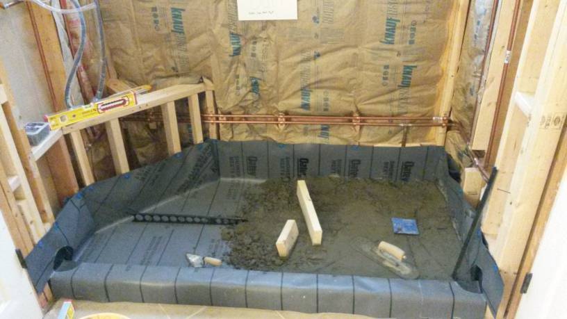

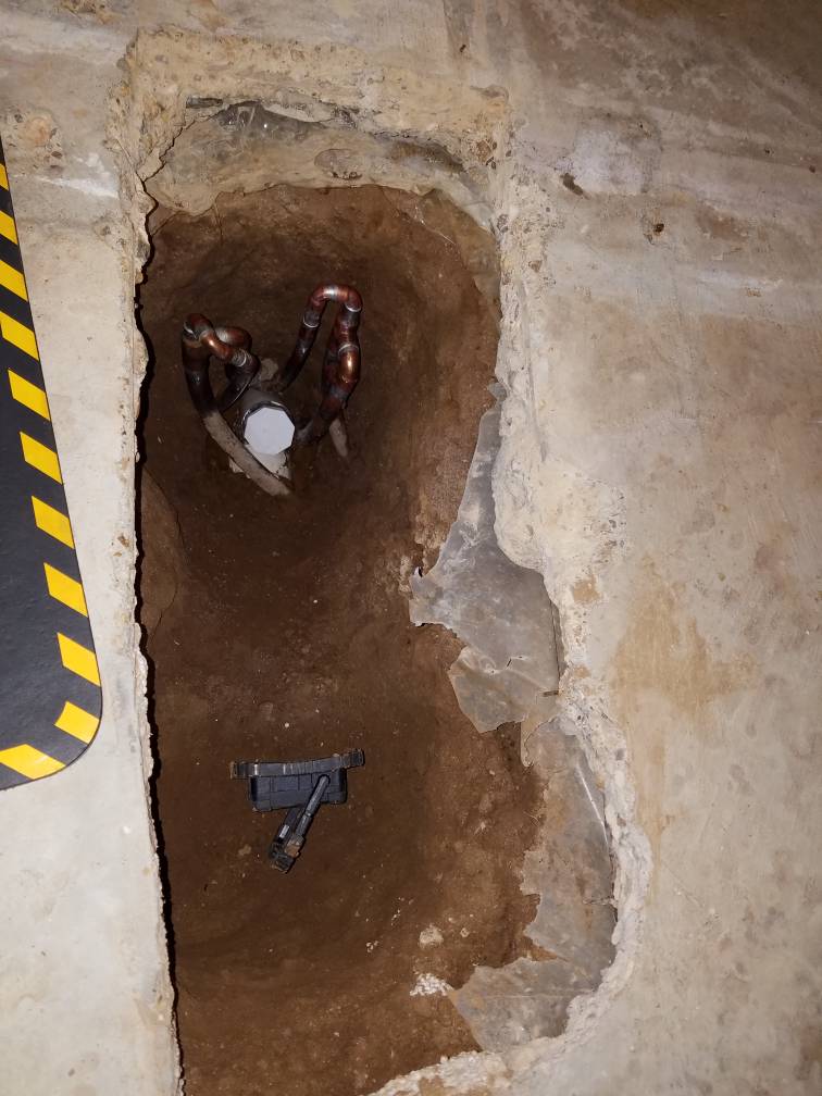

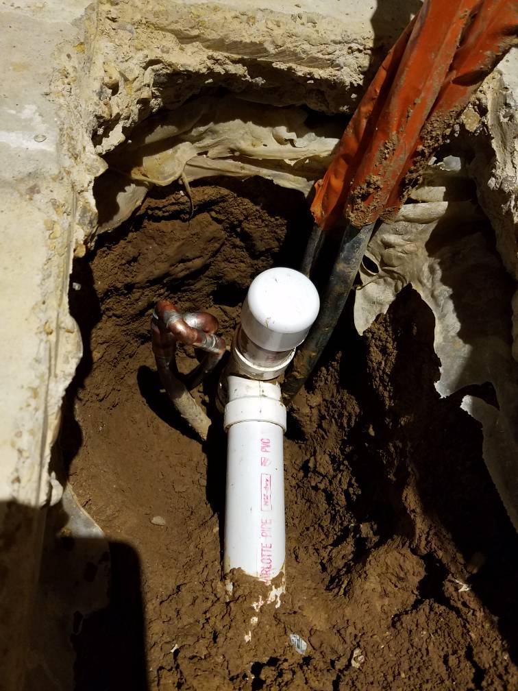

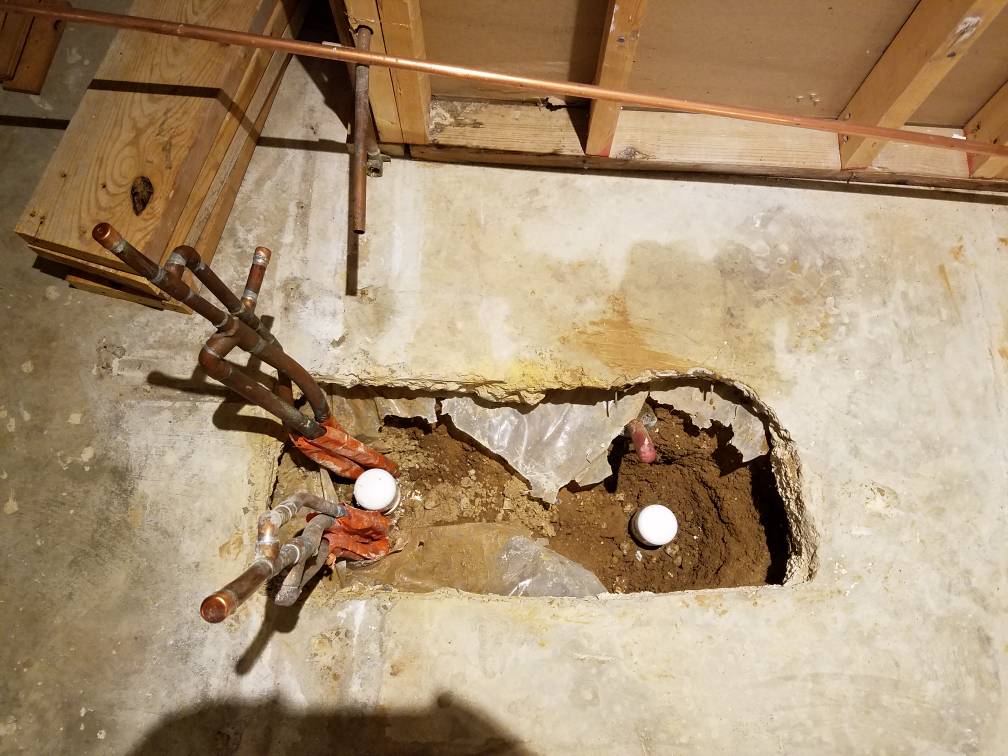

Here's the latest. Capped the drain and vent. Probably going to do the copper 1 side at a time while I'm on 2nd shift and the wife is at work and kids at daycare. I did the concrete saw and jack hammer part while they were away today. 20190223_225027.jpeg
/ Bathroom Re-model concrete foundation #22
Don't want to be captain obvious but make shure you rap pipes with Styrofoam before you pour concrete. Great work.:thumbsup::drink:
/ Bathroom Re-model concrete foundation #23
Be sure the copper is not in contact with any concrete. The concrete will corrode the copper.
In your case I'd stay with copper since it's whats there and is a small job, but keep PEX in mind for other plumbing work.

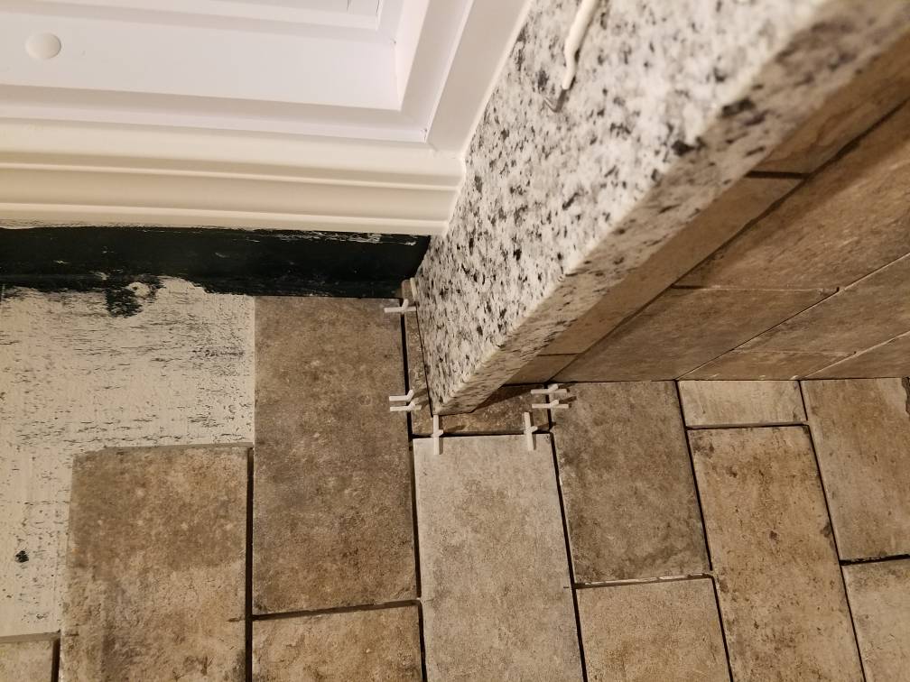

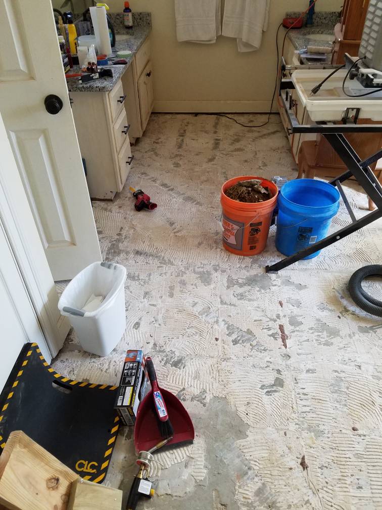

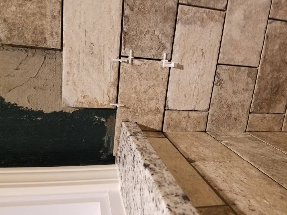

I think you put down alot of tile?
Would you use self leveling goop over this thinset left after removing 2 layers of tile? Or just thinset and tile over it?

Forgot picture for when I said "this thinset left behind"20190224_094510.jpeg

I hope you put proper insulation around those copper pipes going through the slab. Concrete will eat up copper, fast...
They were there from when the house was built. I hope they did too.
Yes I understand the lime in the concrete will eat up copper.
I do plan to cover up the copper pipes I modify to sit below floor level, so the concrete doesn't touch it.

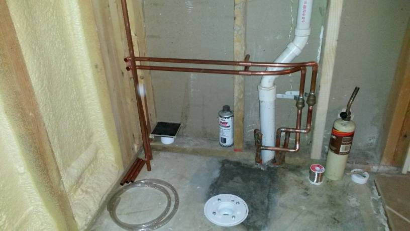

Got the hot water side ready today. Pretty much duplicated what was already there, just 3 feet shorter.
I am thinking actually putting concrete over this will be the last thing I do. I will leave it uncovered to monitor my handiwork until I feel confident to seal it up forever.20190224_222339.jpeg

Eddie Walker, would you use self leveling compound over this or just tile over it?
I think you have done ALOT of remodels and tiling, figured you would know the best way.
I have used the self leveling compound once. Its expensive for what you get and kinda a pain, but it did exactly what I needed.20190224_094510.jpeg
/ Bathroom Re-model concrete foundation #33
I have used the self leveling compound once. Its expensive for what you get and kinda a pain, but it did exactly what I needed.View attachment 593663
I would scrape and/or grind it all off. For a big area like yours, renting a floor grinder would get 90 percent of it off in a few hours. Then the areas around the cabinets would have to be done by a smaller grinder, or chisel end on a SDS rotary hammer.

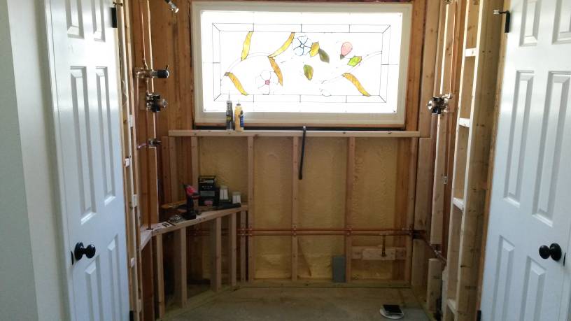

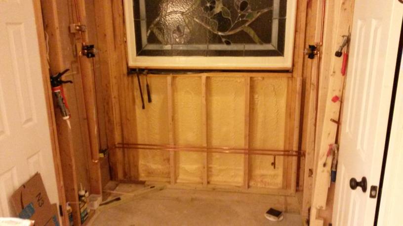

This is what's left of the shower I removed. Plugged the drain/vent off where it teed off. Shortened the copper pipes below grade.
Been framing, wiring, sheetrocking and painting.

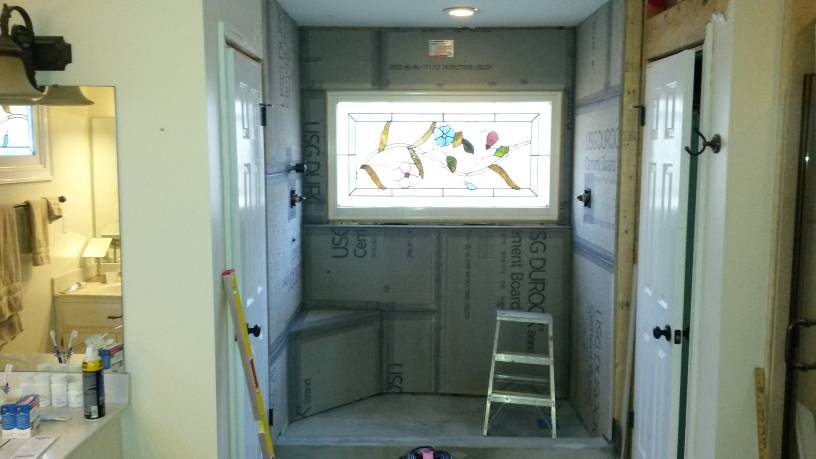

We just finished up doing our master bath, original from house build in 1985, sorely in need of a gut job. Glad wife didn't see that wall insert/display thing, or I'd have been doing that too ! :D
Wife and I did about everything but the glass door on the shower.
enhance
Doors I built (had a stain glass panel made for it)
enhance
enhance
enhance
enhance
