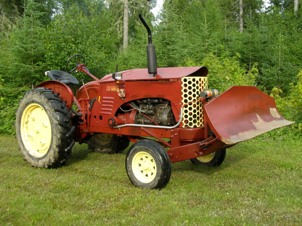

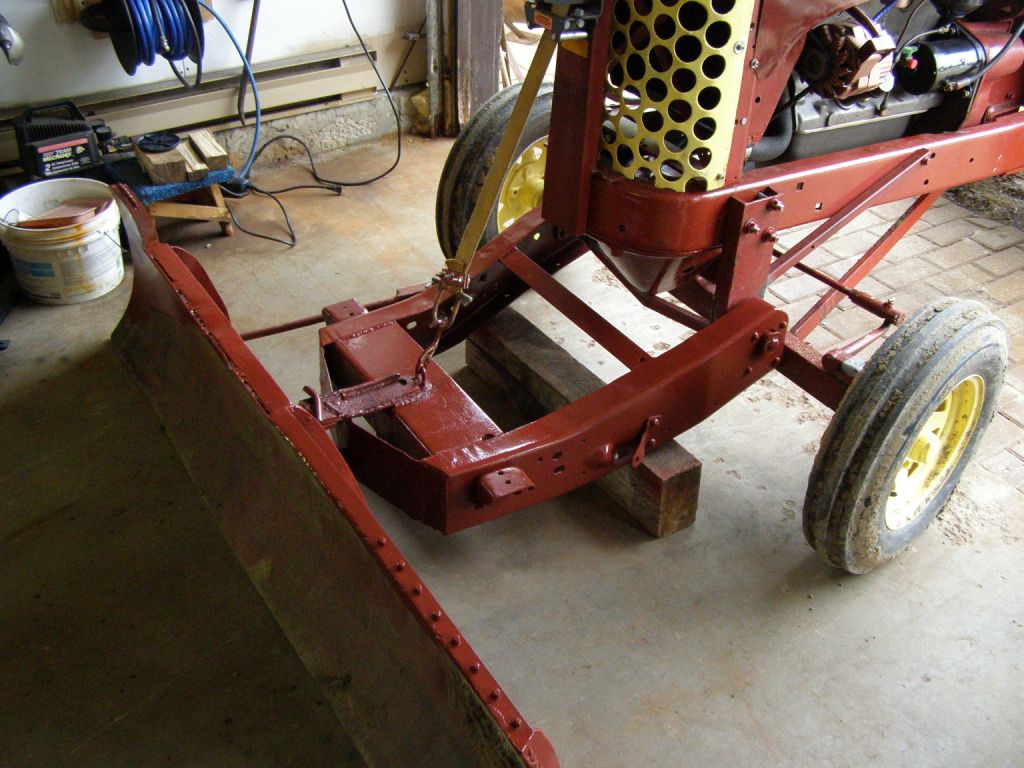

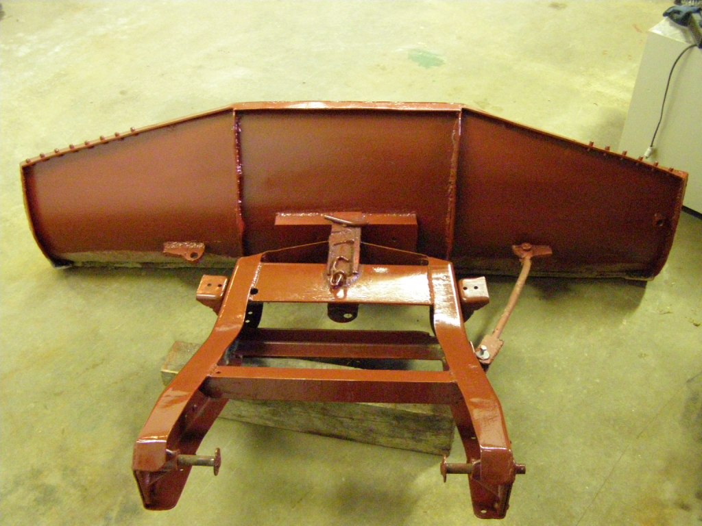

After being rushed into trying to build something for last winter and having attempt # 1 fail miserably, attempt # 2 barely make it through the winter, I am at attempt # 3 which seems to be the right direction.

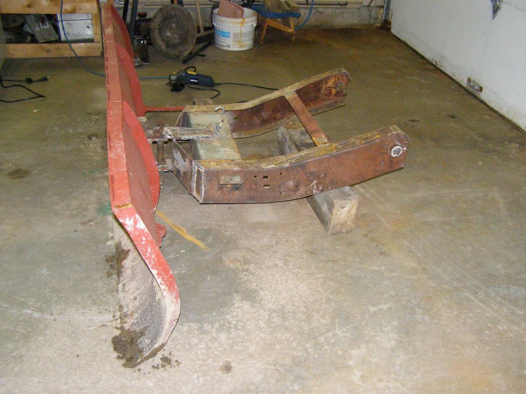

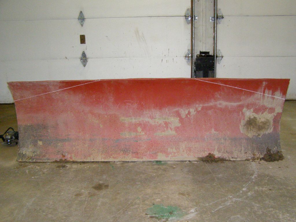

My Dad found a blade in a friend's yard. It had been an "on again off again" project for the guy - you could see the different attempts made on it over time, but the pivot plates were out of alignment and not parallel with the cutting edge. The blade form itself was excellent in curve, looking like the original idea was right on target, able to roll the material it is pushing.

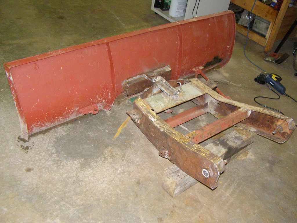

The next thing was to adapt it to my 1947 Massey Harris Model 20. With lots of scrap metal in the yard to choose from, I found the best thing to use once I realized it was 2 matched sections from a Chevy truck frame, 1/2 of a radio rack base, some 2" angle, 3" x 1/2" plate and 4" channel iron. Also some other bits and pieces like 3/4" and 1" pipe, 3/4" round bar, 1" round bar.
I don't have photos of it going together, but closer to complete photos, below.

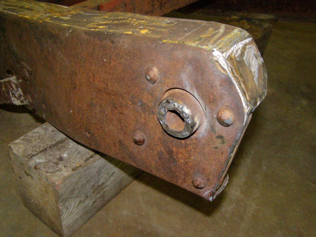

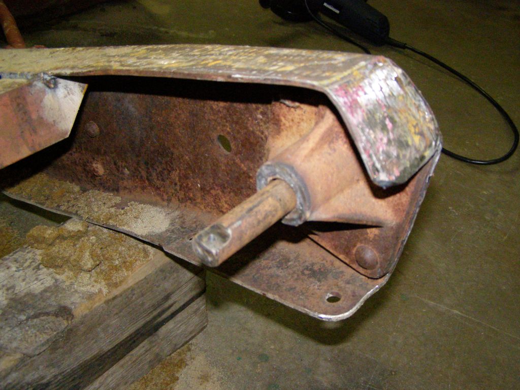

The 2 sections of truck frame are cut from the front of a 4 wheel drive truck, flipped upside down, with the rack base plate welded in across the front of the assembly, 2" angle welded across for bracing underneath and near the back, plate steel added out as a "nose" to give room for the blade to pivot. I've used the spring shackle mounts for the pivot bushings with some reinforcement.

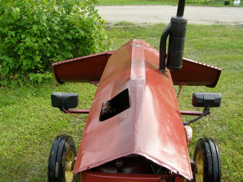

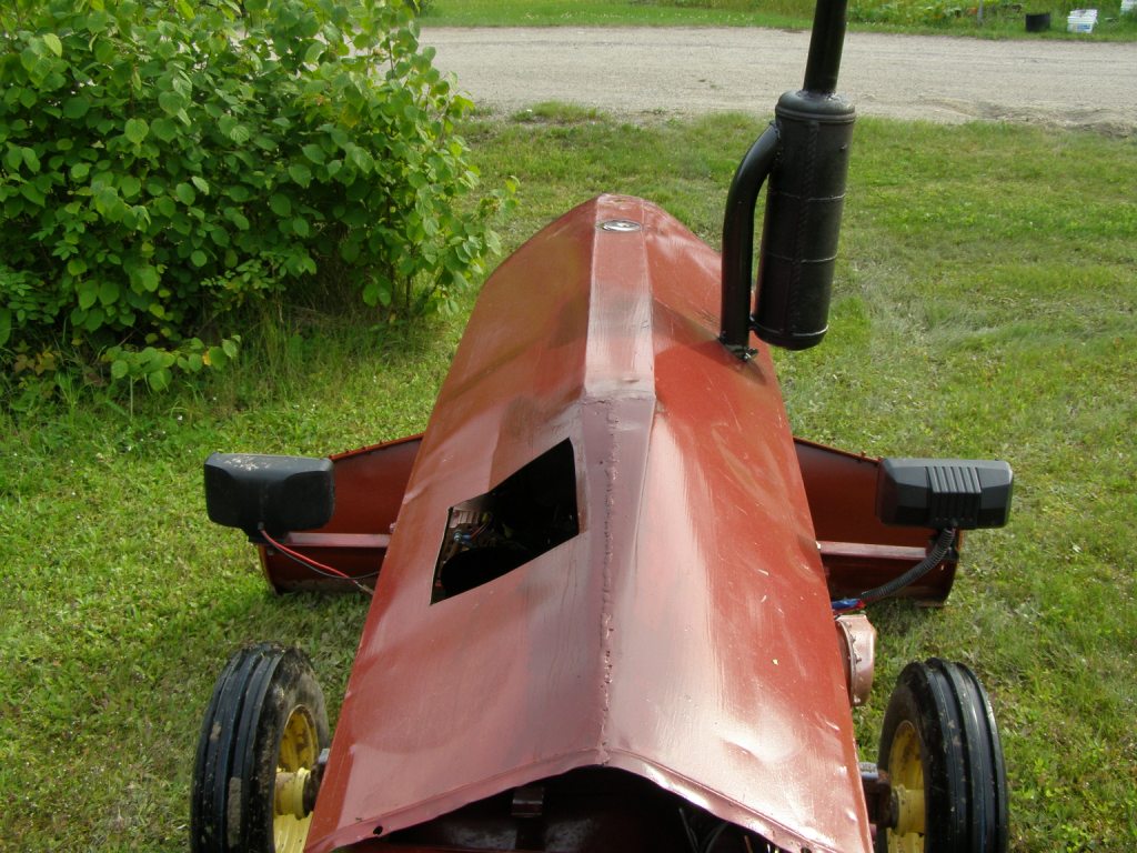

The last major part of the project was to reshape the blade itself to decrease weight and give it a bit more of a "look". I'm no pro welder :( and I've seen much more professional work on the forum. but after trying this assembly out and having it work is quite promising! :D
A few things left to do like add some points for adjusting the blade angle, maybe a quick-swing arm for holding the blade up while being stored, and also to upgrade to hydraulic lift, not electric winch.

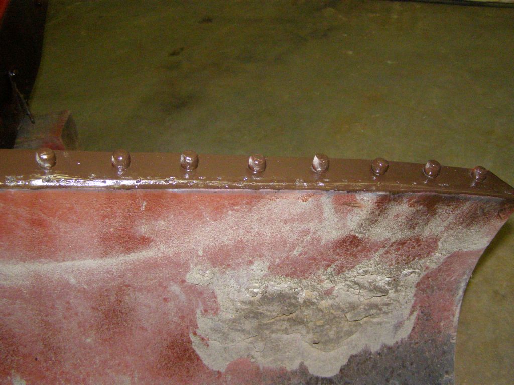

Cool project, looks good and should hold up to most anything your '47 will do.
Rivets along the top edge are great, not many appreciate the practical, strong and functional 'rivet' .

Thanks for the compliments, guys. The rivets are part of a large clamp assembly from a wood-worker's shop. I needed to finish the top edge of the blade itself and that looked pretty "aggressive" to have those rivets sticking out. I used my MIG to weld them into place. The thing is that the edge of your blade never carries much material during a push and if you look at a Caterpillar dozer, there is a piece added at the top center of the blade, giving that similar look.

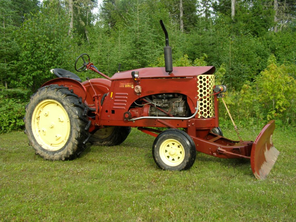

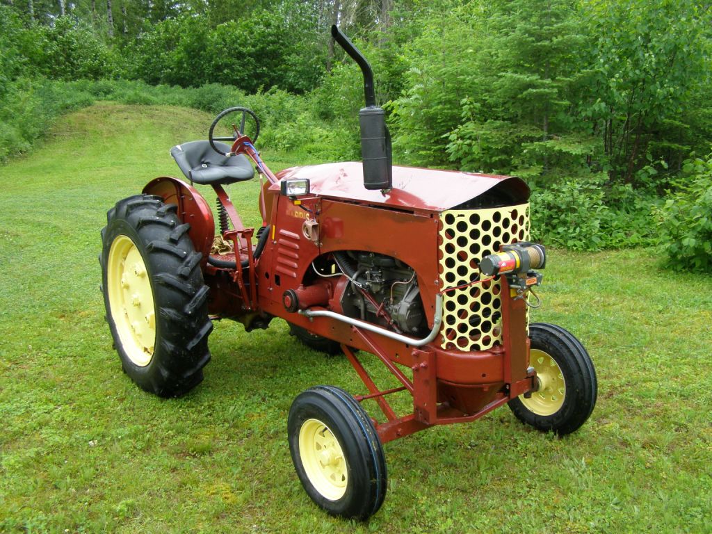

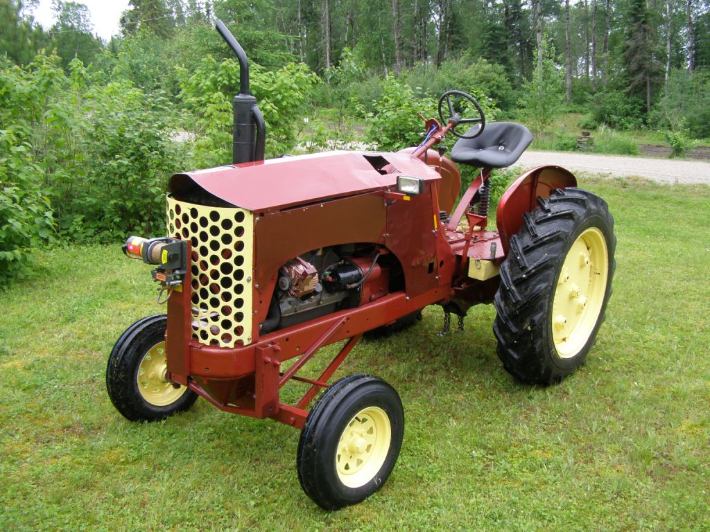

Here's a couple of pictures of the mount on the front of the tractor.
Graham
In case you're wondering, this tractor is a resto and came with no engine bay sheet metal - hence the odd hood.

Graham, looks like you are ready for the snow. :D Great job!
/ Basic pusher blade for my '47 Massey
#9
It's ready for snow, sand, clay, gravel. It works remarkably well! :D

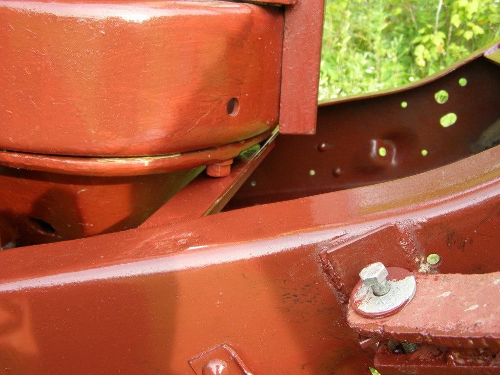

Here's some more photos of the "thing" and yes, it is very satisfying to use the stuff kicking around the yard and get a great product from it! Thanks!
The pivot photo shows the inside construction of the frame mounted part of the assembly, but it is a poor photo re: depth/perception due to the slag and welding burns on the pre-existing paint which is a bit messy.
On the "max travel" photo, it shows the cross member touching the bolts on the tractor frame - I will be adding some sort of rubber bumper there to cushion the upper stop point.

I know very little about cast iron, other than the fact you really cannot weld on it too much, without temperature control on the object (i.e. oven) and some pretty soft mig wire. Is the original front pulley made of cast? Could you center another sheave on it and weld it together?
The photo is the truck spring shackle bushing (cast) with 1 inch conduit welded into it. This worked better than the thermostat housing I tried to repair last year (also cast) by welding the fracture with my MIG. When it cools, little cracks and fissures start to happen as it cools too fast and thus ends up being more damaged. The bushing pictured never did any of that type of cracking at all. Hmmmm....
Yes, the original pulley is cast, and quite thin. There isn't much room in there either. Here's a drawing that I made of the original pulley.
There is basically zero clearance behind the pulley as it actually is inserted into the front of the engine. An oil seal rides on that portion. I just noticed that I left off a bevel that makes it easier to insert the pulley into those oil seals. Overall, I think the drawing is pretty accurate, though reverse-engineering was pretty hard. I did a lot of head-scratching to get the measurements, and I can't really say how accurate they are for sure. Take note of how thin that pulley is though. I've tried to show that with the dashed line on the lower view of the pulley. Those curves are all cast, too. There aren't very many good machined references until you get way to the outside of the pulley.
I couldn't weld it. I'm not a particularly good welder, though either. I find welding to be a very humbling experience, LOL! Though, I am quite persistant and eventually get what I want--it just takes a lot of grinding and "second" tries sometimes. . . .
