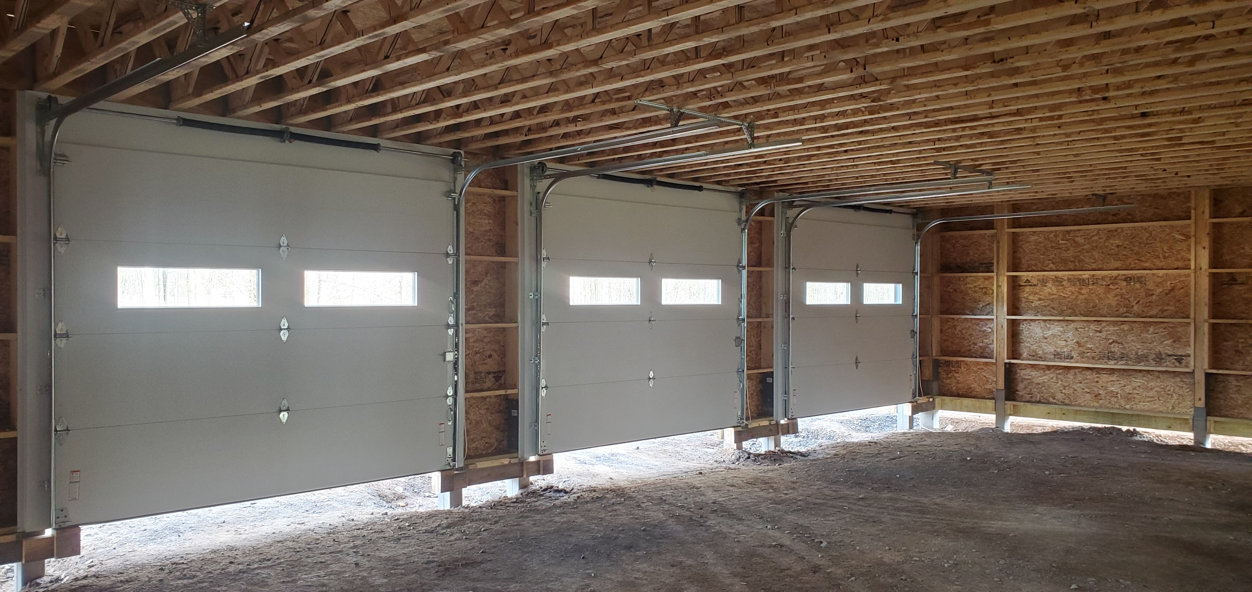

OH doors were finalized today, the building is officially "dried-in".
The weather is still being a pain here, but hopefully soon the under-slab plumbing and electric will be done so I can get going on concrete.
/ Barndominium/Shop or "real" House? #508
They look great. What brand openers did you use?

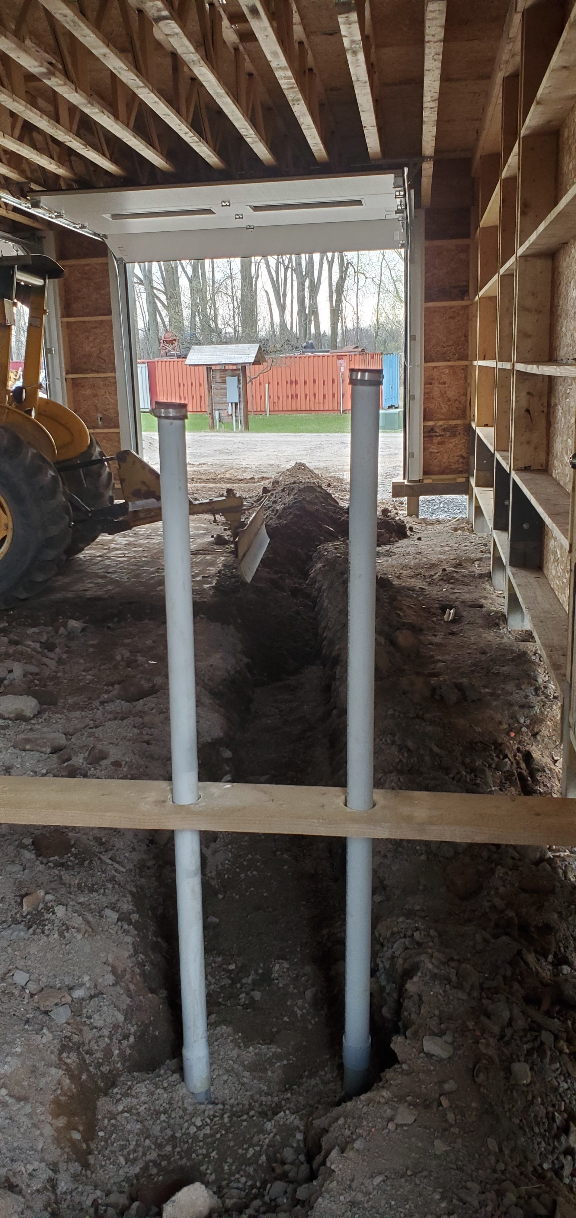

Got the under-slab plumbing and electric done today. Can't fully backfill until inspector has a look at the plumbing.
/ Barndominium/Shop or "real" House? #520
There is something about drain lines that I always find interesting.
I see two cans by the pipes, but I don't see any purple primer on your pipes. Are the pictures just dry fitted in the photo's and you used purple primer after you took them?
