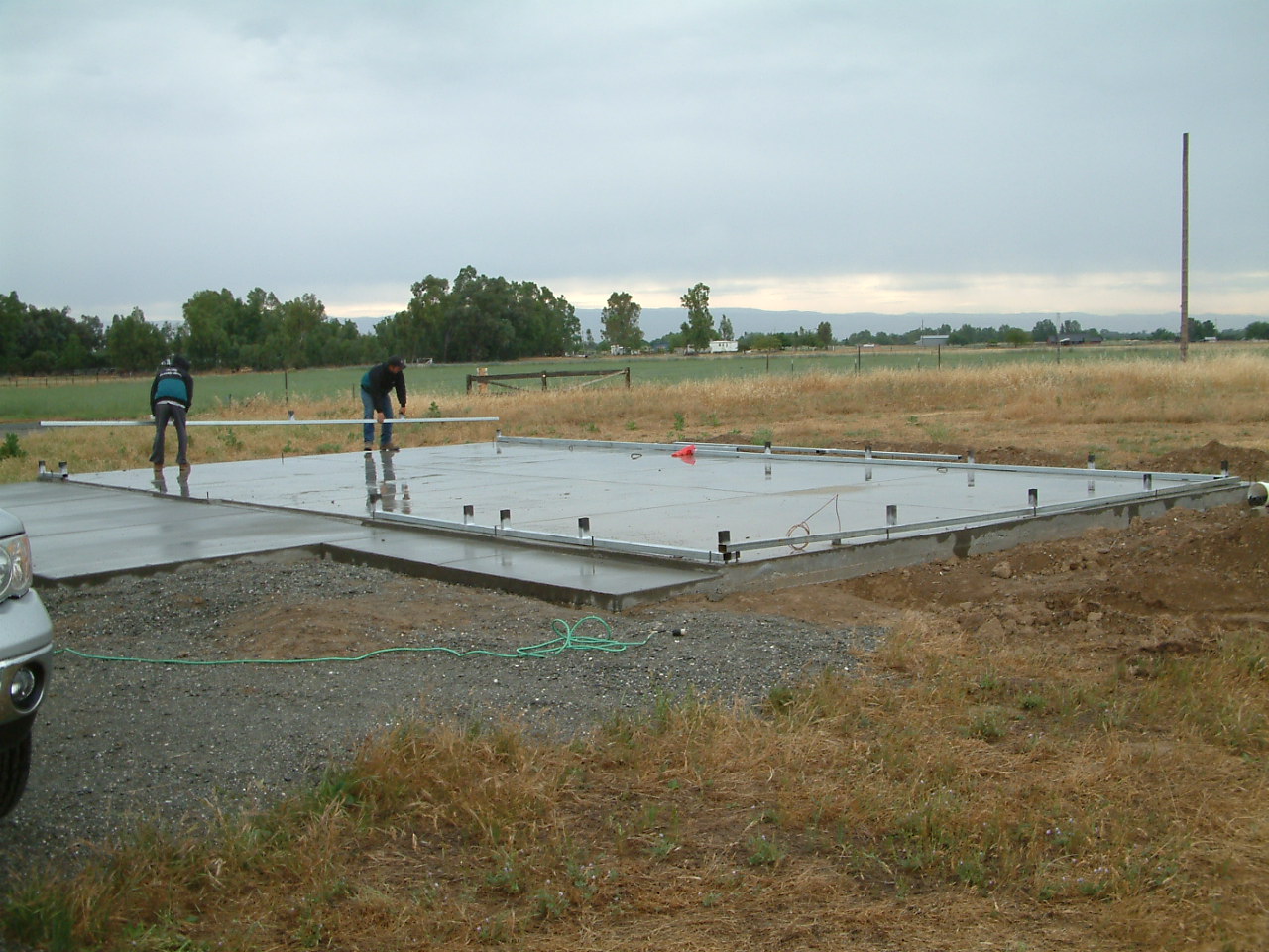

I'm adding a small room and a 3 car garage to my house that's 1,620 square feet. I did the dirt work, set the forms and tied the rebar. Rebar was just under a grand and I put it every 18 inches, on chairs. I hired a crew of 4 to spread and power trowel to a smooth finish for $2,000. It took 26 yards at $185 a yard. I'm at about $4.75 a square foot for the concrete. This was back in July.
