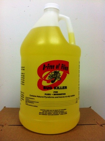

We use a good fly spray on the horses.
B-Free of Flies.
