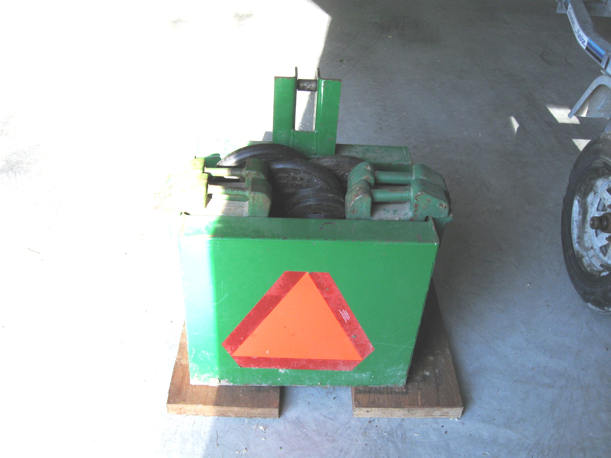

/ Ballast Box #11
Fill it with old weights that people give away. With the box, mine weighs in at just under 1000lbs. I also used my JD case weights.
