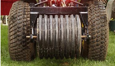

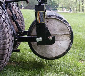

There have been quite a few threads and ideas on ballast box ideas. I built mine for next to nothing, the drum was free and I got the steel rod at work for nothing, only cost was the concrete and I supplied the rocks ! ;) I believe it to be about 700 lbs. It really makes a difference doin loader work !

A ballast drum requires no welding to make at all. Mine has a lid and I left about 12 inches at the top for storage. It is over 800 pounds. I use my box blade most of the time for ballast though. If I am moving stone or doing a lot of fork work I throw the drum on
