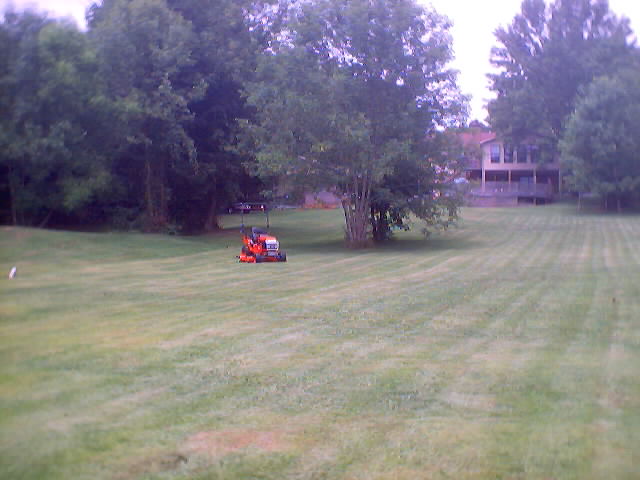

Well paint me in the filled tires corner :D
I primarily mow and the FEL & BH is generally dismounted. I use the FEL quite a bit more than the BH.
The ease of mounting/dismounting the FEL and/or BH makes it so that I just pull up and add them when I need them then drop them when I'm done.
In my situation, when I work the FEL I don't have to worry about adding the BH or weight box or any other implement to offset the FEL as the filled tires do a good enough job of doing so. I've not encountered any problems w/digging nor transporting with a fully loaded FEL.
As for mowing, the BX doesn't seem to mash down the grass too bad and the grass recovers and looks pretty good by the next day.
There is a disclaimer in my owners manual that indicates that the filled tires should be "drained' whenever the BH is mounted. Now this isn't practical so what I've done is lessen the amount of fill in the tires to approx 3/5ths full. This leaves an airspace to allow for expansion for when the additional weight of the BH is added yet still adds enough counter balance for FEL work. So far I've not had any problems living on the edge like this :D
