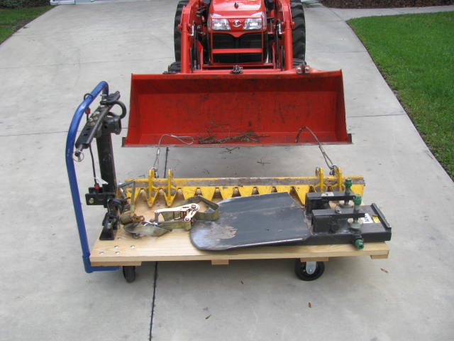

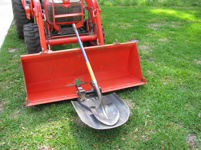

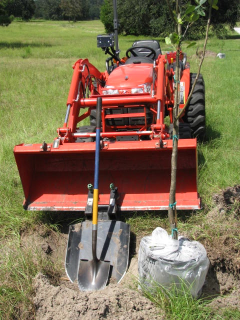

If you want to dig with the FEL, in a somewhat limited way do to its width, purchase a TOOTHBAR or a BUCKET SPADE. The Toothbar brand most frequently reviewed here with high marks is PIRANHA. In rocky soil, you may need to make a pass or two with a Three Point Hitch mounted Subsoiler to loosen up soil agglomeration 12" to 14" deep for the FEL bucket and toothbar.
Piranha Toothbar
Long Toothbars are also highly regarded, perhaps a tad better in rocky soil on medium weight tractors.
Long Tooth Bars
Tractor bucket spade shovel
Many fill their ballast box with sand, then add water to set weight for each chore. Downside is increased humidity if stored inside, rather than outside.

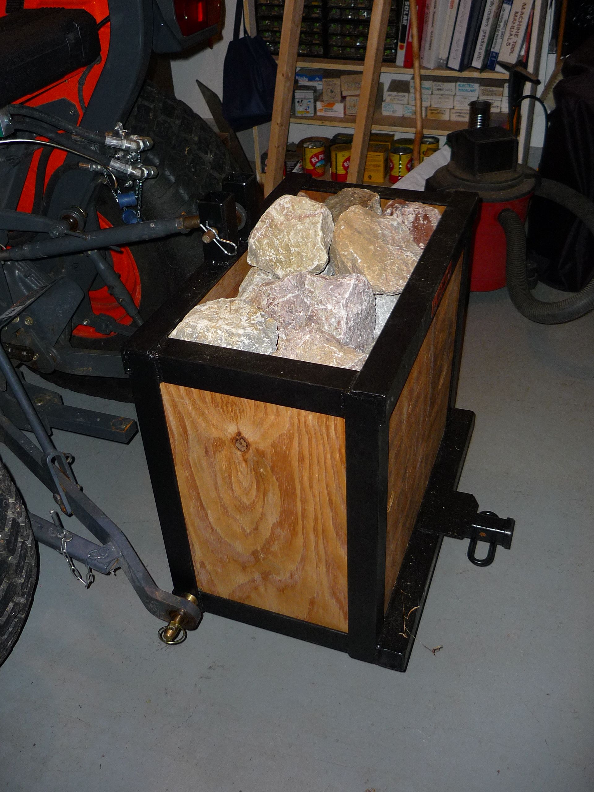

I favor removable weight in my ballast box, rather than permanent concrete... I figure it's about 600 lbs with a full load of rock, which is enough for my purposes. A bigger box would hold more, obviously, if needed. The small, close box doesn't create problems when maneuvering in tighter spaces, like a rear blade or cutter might.
