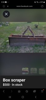

I looked on the marketplace, and the lowest price was $500 for something with no paint left on it and no rippers. Everything else was much more. Seems like people think their used equipment is made of gold. I was looking at used tractors around here and bought new for 2 thousand less after tax than people wanted for a used ck4010 and almost the same price as they are asking for used 2610s. People that paid msrp when there was no inventory aren't going to be able to recoup that money. At least I'm not going to be the one helping them

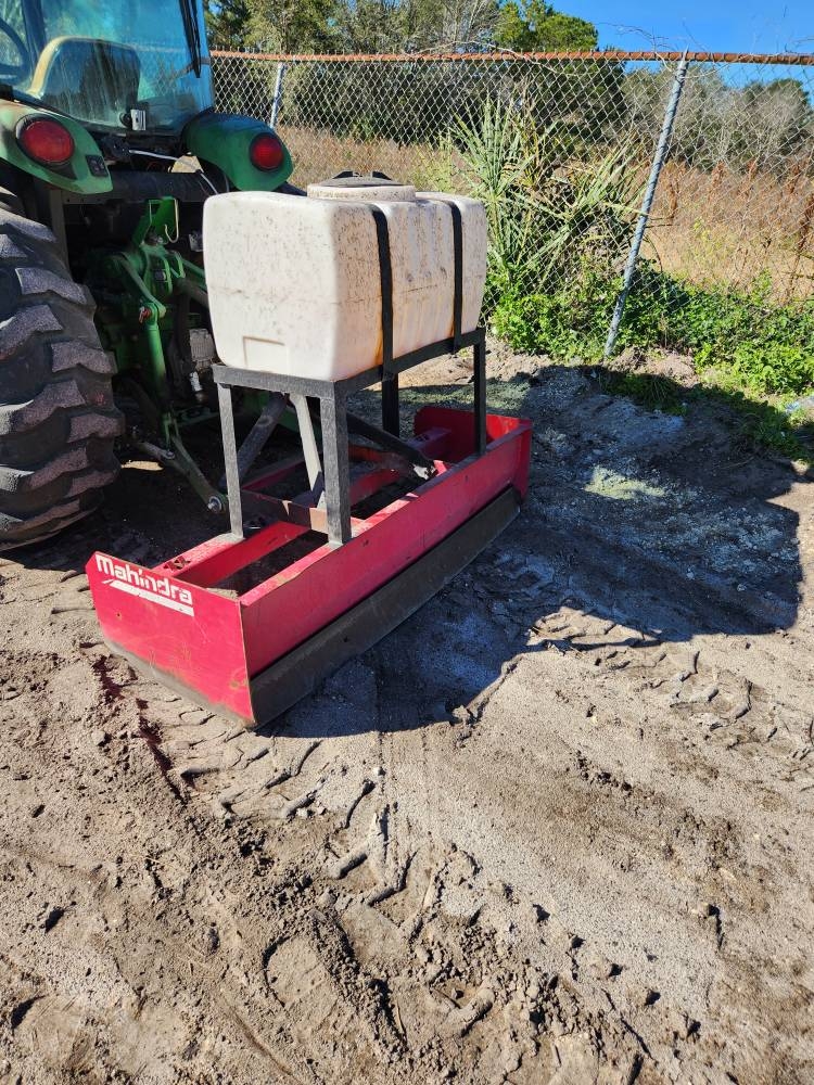

Saw this yesterday at work on a broom tractor. Stupid cheap, 80 gallons of water on that box blade, adds very close to 700 lbs above the static weight of the box blade.
Edit: well, dang, an 80 gal poly tank isn't very cheap. Like $180.
