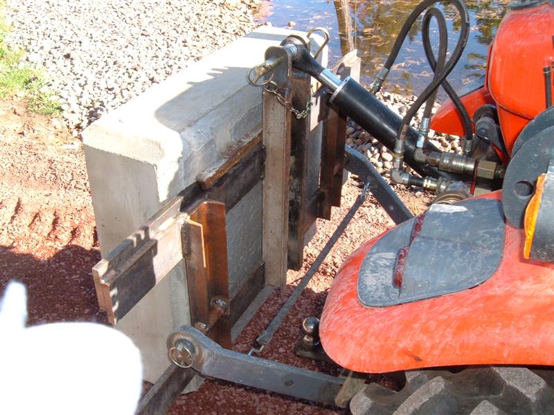

You know, the more I think about it the more I think I should just make a concrete 3ph ballast. That way she is not so heavy when I need to trailer her. I have a ABS drum that would be perfect.
I will make it 5-600 lbs.
This is probaly more elaborate than you want but this is about 900lbs on the back of my CK30. I did make one other the same size with flat bar sticking out to attach to the 3PH for friend of mine. I work at a manufacturing plant with access to concrete everyday so it was easy for me. Just food for thought .

Thanks Steve. It's hard to see what's going on in the picture. It is a block of concrete sitting on forks or is the 3 point hardware imbedded in the concrete?
/ Balast #43
This was the same device I used on my previous CK20 (first photo). It started out as a set of forks on the 3PH, then I built a new set of forks for the front when I got the CK30 with the skidsteer QA (second photo). I made a weight for the rear that just attached the same as the forks (I cast a piece of channel iron in the concrete for a hook). Make sense? Fire with any questions you want, always willing to share ideas.

Ok. Thanks Steve. I get it now.
I have gotten some ideas from this. I am going to fill my tires. That will give me 500lbs total in the rear. The. I may do a 3ph fork with 50 gallon barrel and fill with water. That would be 1000lbs total. Then if I want to float the machine I can bring the barrel empty and full onsite.
