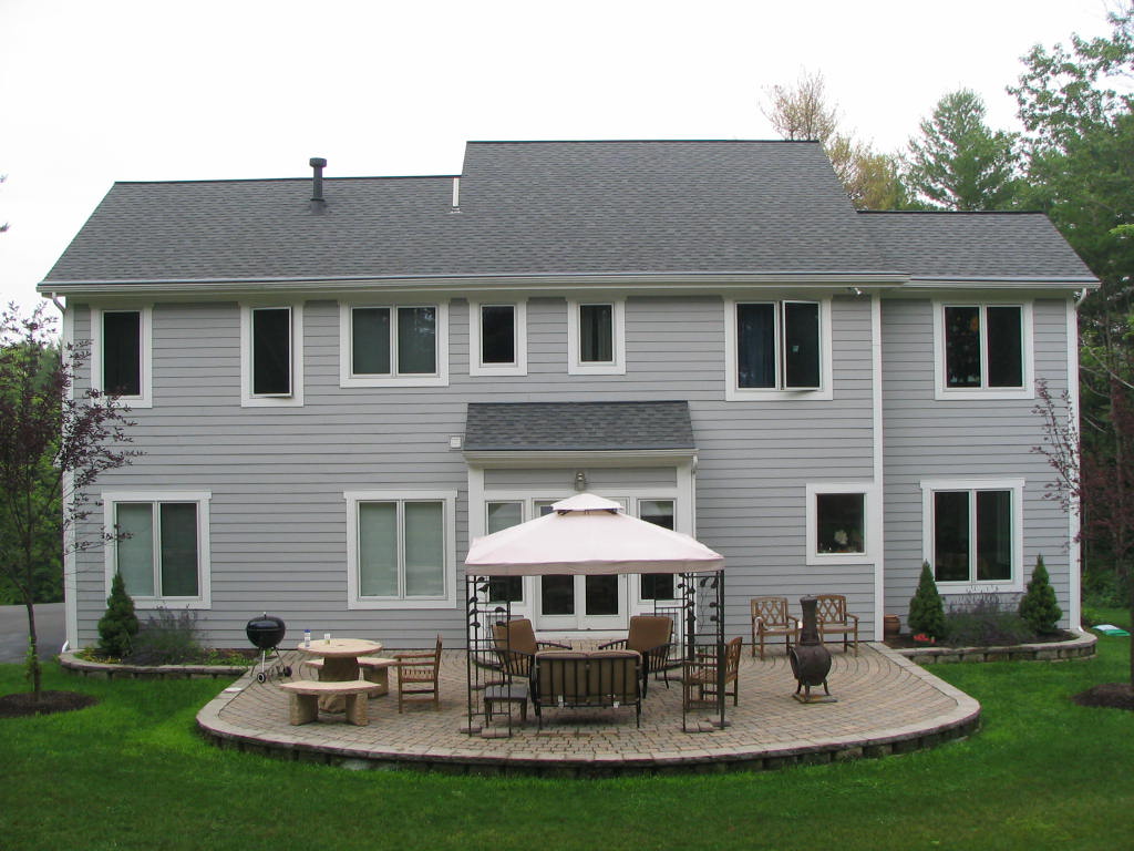

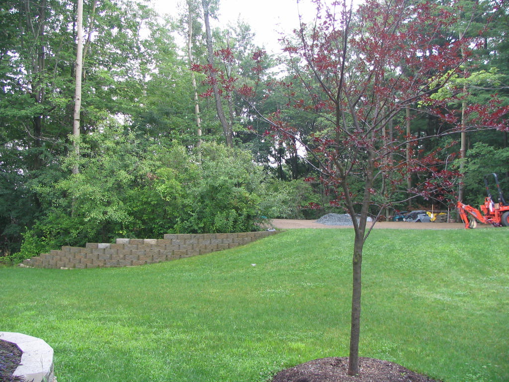

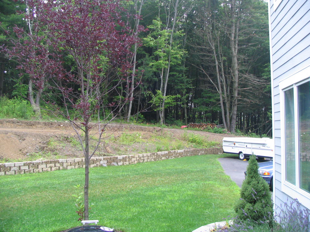

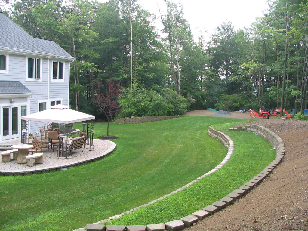

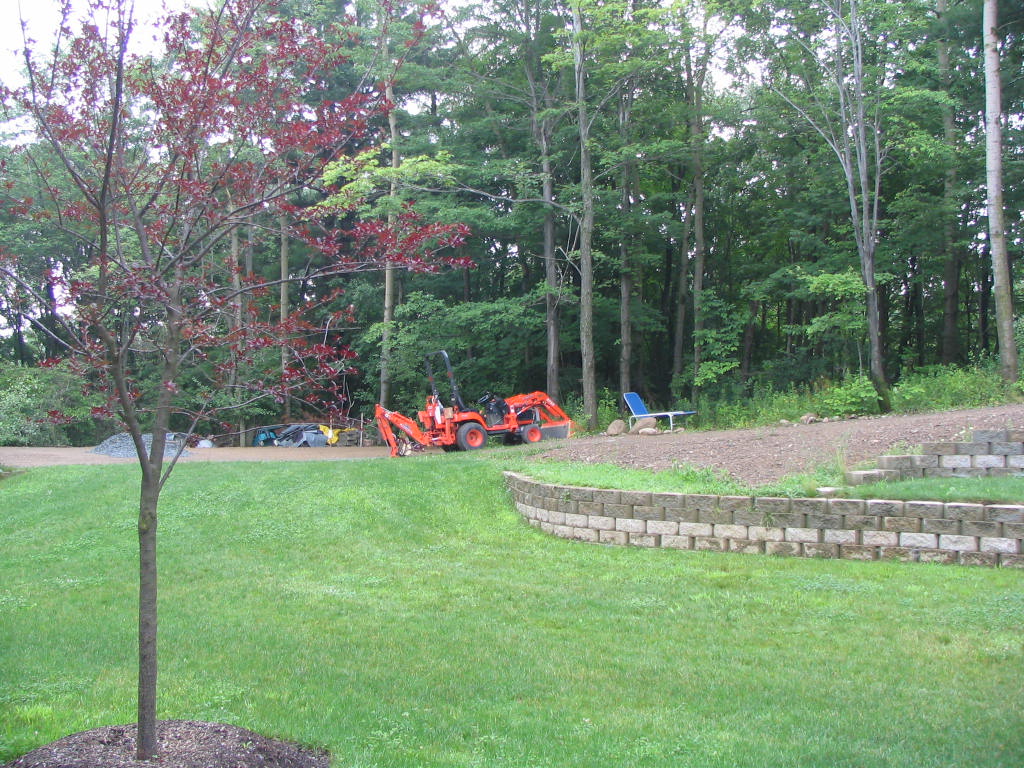

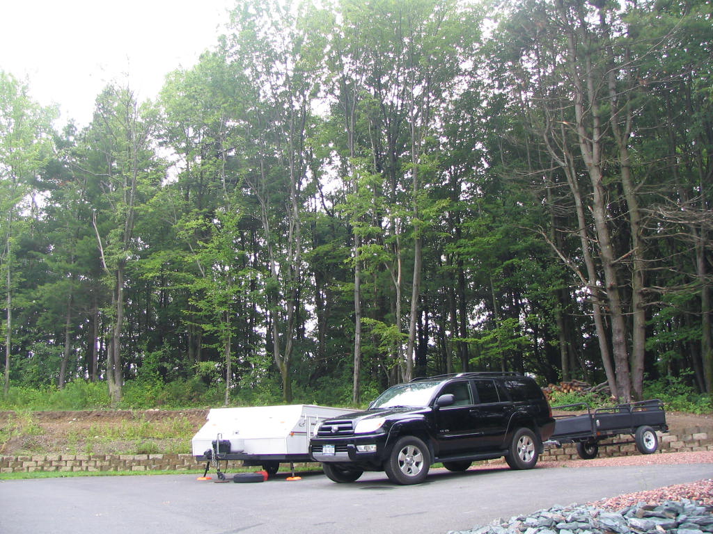

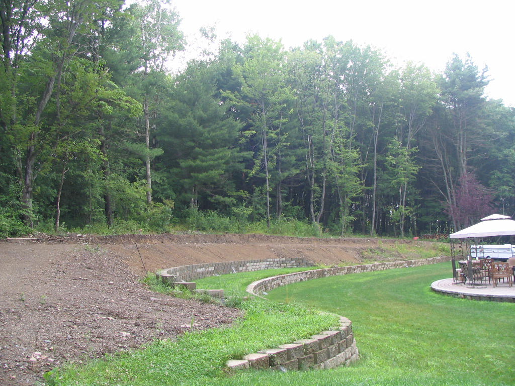

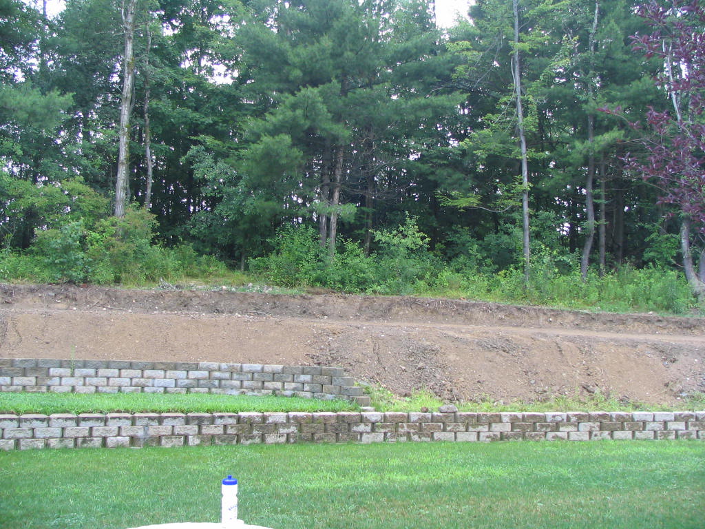

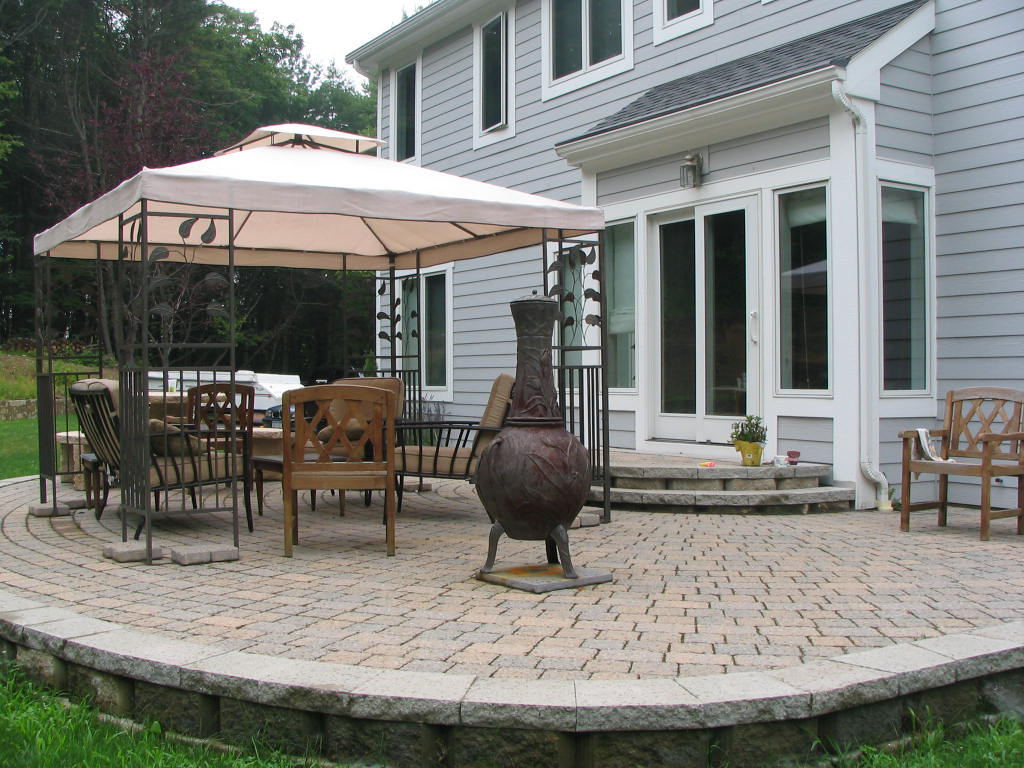

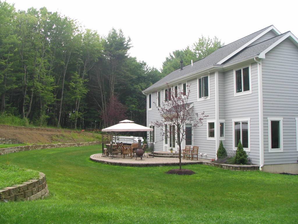

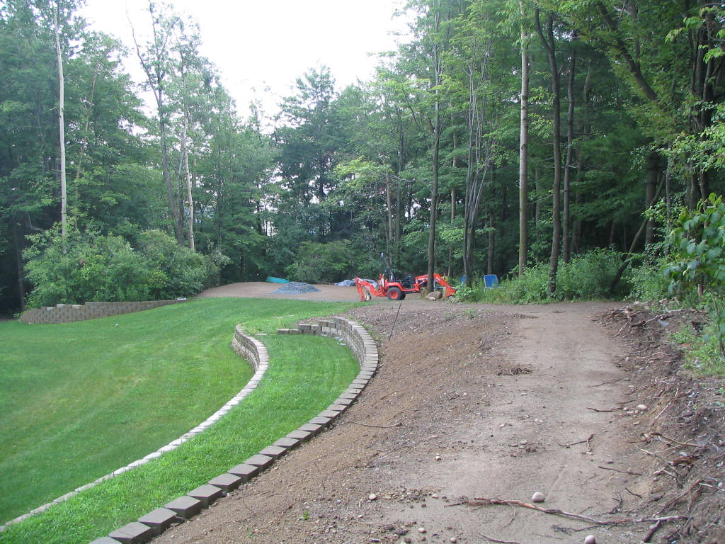

Folks,
Make a long story short. Bought the BX in late 03. Started on the backyard in 04, so far completed the patio in 05, The backyard is taking shape, can't wait till it's done but then again yard's work is never done!!!!
Cheers!!!
Alex

Nice work.
A couple of questions
Where did you get the shade structure? Also - what concrete pavers / wall system are you using?
I'm in the planning phases of a patio (might end up being a deck) but we need some shade...
/ Backyard in progress thanks to BX23!!!!
Thank you for all your kind words. You guys are the ultimate nice people.
I'm definitely not a methodical type of a person or else I would have some pics of the before.
These pics were taken this morning and because it was sprinkling so that make the grass looks greener than it is but thank you for the compliments though.
The shade canopy structure was bought from a landscape place but I think you can get them at Home Depot or Target nowadays.
The concrete stones that I used for the wall are from Home Depot. They are about 52 lbs in weigh for each, and the reason I picked them because of their weigh 52 lbs is more managible then the 80 POUNDER that most landscape places carry, after all I only weigh 115LBS myself LOL. The bad news for me is they no longer being displayed at my local Home Depot.

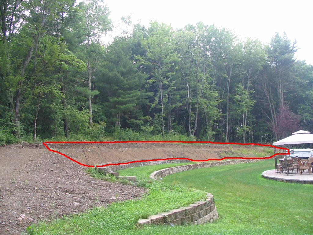

The backyard is taking shape ...
It looks fantastic. Congrats on some really impressive landscaping ideas and their execution. Very impressive!!!
May I offer a suggestion as a fellow TBN'er. I grabbed one of your backyard images and I circled a section in red. Please don't take the tractor into the red zone. That's a very tight and tricky area to manuever, and I would be very concerned about a roll over with that type of slope. Even traversing the slope vertically leaves your well being in the hands of a perfectly functioning transmission and brakes. That type of slope is best handled by an excavator from above, by a small crane boom from below, or by a wheel barrel.

Hey! Thank you for the constructive advices. I don't dare to venture in the RED ZONE, I hate the feeling of being on hairy edge. What I've been doing is just dumped loose soil onto the RED ZONE using the tractor's bucket or a rototiller to loosen up and then hand raked into shape. I know it is the hard way, but sometimes there's no other choices. And I definitely don't want to ruin my lawn at the moment with a crane from below. Thanks for your advices, hopefully there's others out there could use yours also.
Cheer!
\\\Alex

There were a few times that I could use a rake, but that's all. The back hoe does the digging and the front loader does the scooping and grading. However for the wall and patio you need a trench compactor and a plate compactor. I have a Wacker trench vibratory compactor to compact the trench foundation before laying down the first course of the wall.

Wow, that is a lovely looking place. Good work on the landscaping also. Is the 'red area' destined to become grass? Did you have any other machines in to do the first grading or did your BX do it all?
#16
Yes, the Red area ( sloppy area) is destined to be grass area to keep it from running off and erosion. But as time goes I will try to turn it into a some what mixed between flowers, shrubs, ground covers and whatever plants that will look nice, but it will be a gradual transformation because they are not cheap.
I've been using the BX for all of the work so far.........
