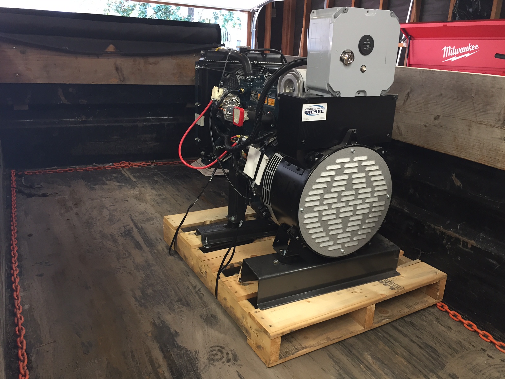

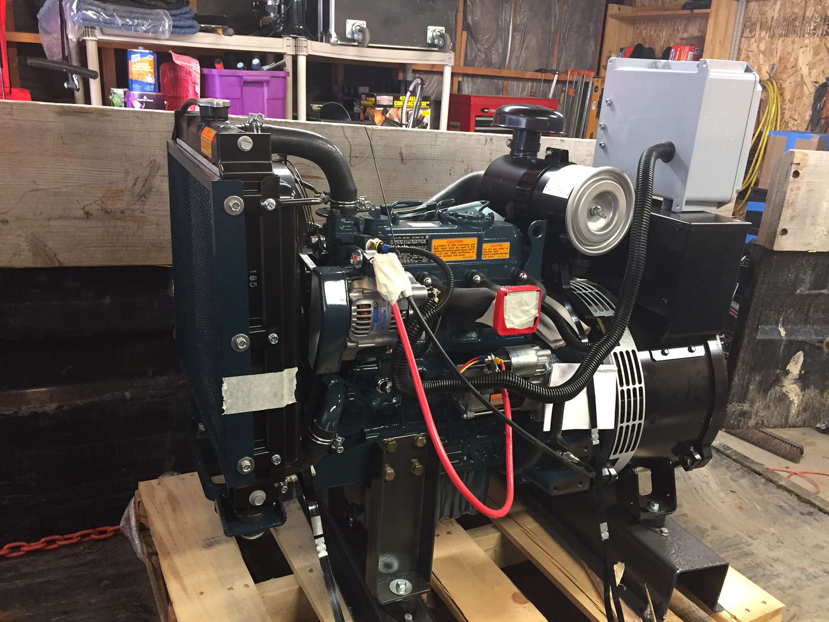

Picked up the generator at the Sacramento Fedex freight terminal today. That is not the pallet it was shipped on. The original pallet was broken into splinters and the cardboard wrapper was ripped apart. Amazingly not a scratch on the machine. Three Fedex warehouse guys spent 40 minutes getting the machine off the destroyed pallet and onto the new one so it could be loaded safely in the trailer. All is well that ends well.
This will have to live in my garage for a while, I have not started to build the enclosure yet. The steady rains seem to be over now so should be able to get going.

Sweet, did it come with an exhaust ?
BTW I called CMD to get shipping cost to Detroit,, $488.00 so $500 for you not so bad.
