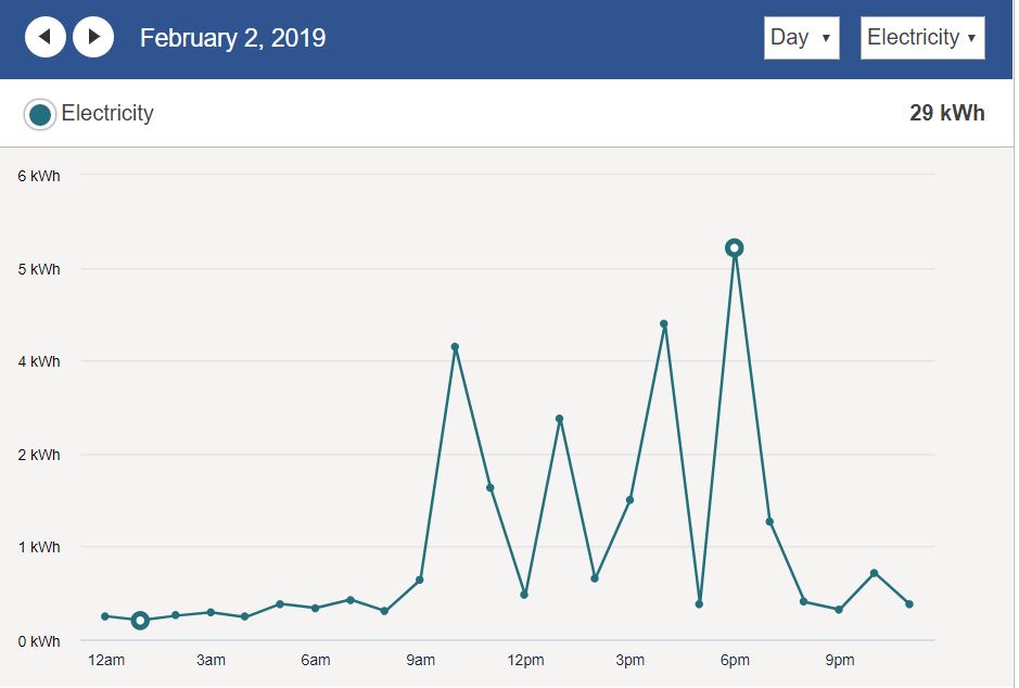

I hope you guys running large generators at night can justify the fuel usage. Check out this this graph from my home:
The 4 spikes are from running the clothes dryer. The rest of the day and night I can get by with a 1600 watt inverter generator that is quiet and runs 6 hours on a gallon of gas.
My electricity usage this day included:
Oil Fired Boiler for heat and hot water
Full Sized Fridge w/freezer
LED Lighting
240V well pump
PC Laptop
Clothes Washer
Coffee Maker
Non-Energy-Star Compliant Clothes Dryer
Woodstove fan
I probably did some light cooking with the electric range, but don't remember.
I am now shopping for an energy star compliant clothes dryer....and my point is: you don't need to run large generators 24x7. Switch over to a smaller/cheaper unit when you can and save your fuel reserves.
Energy star clothes dryer 都aves money by using a lower wattage heating element . Coat per hour is less but the cost per load of laundry is the same .
Just keep your old dryer and turn the heat level down.
