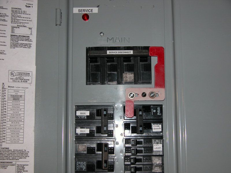

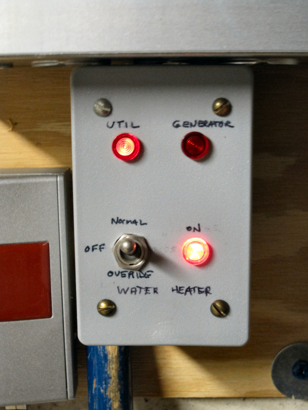

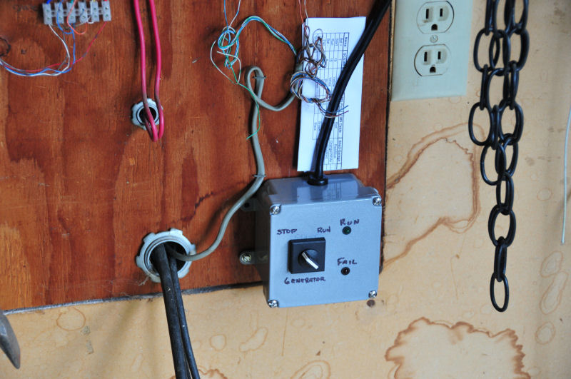

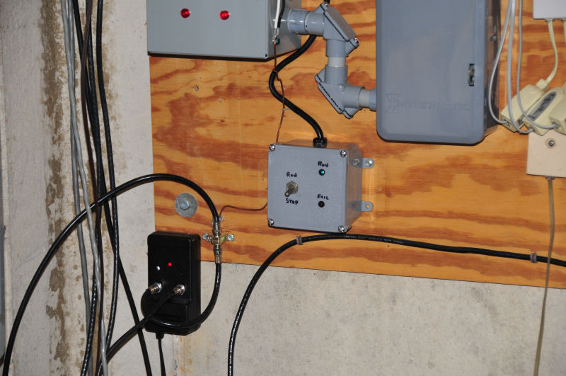

I did not opt for an auto transfer switch since if we were not home I felt I did not want the genset running. I did a manual transfer arrangement. I can start the generator from my garage or basement. I have one light in the shed and one in the basement connected to the generator output, so when the power goes out I can start the genset and have light to do the transfer, etc. Later I built a small controller that switches off the hot water heater (a big load), but with an override switch to "recharge" the hot water as needed. It also has a voltage detector on the incoming grid power and will sound a signal when the grid is back up. Our house is rural enough that we often did not know that the power was restored. It alerts only when grid power is on and the generator is running.
