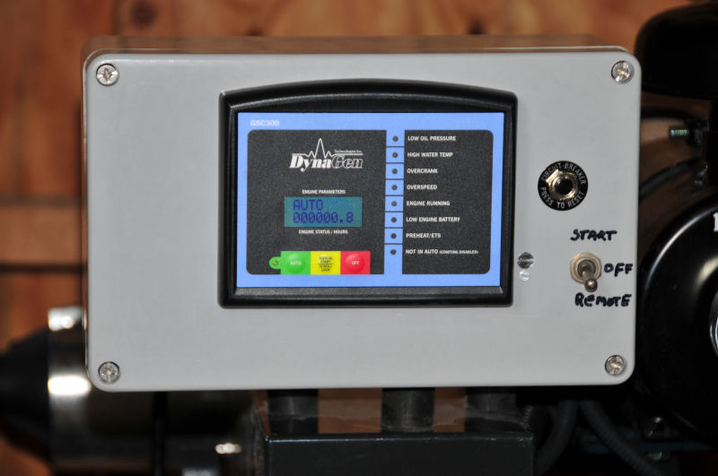

/ Backup Generator #65

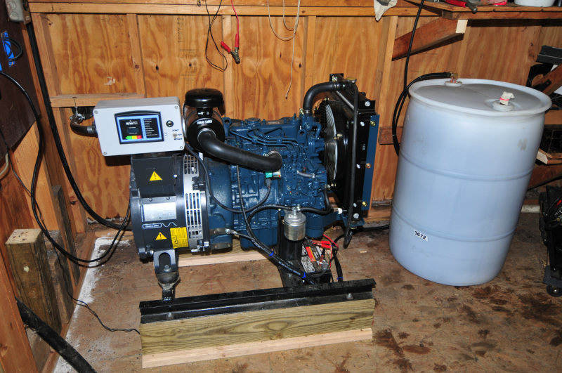

/ Backup Generator #69
Very nice set! People have arguments about not spending the money, but no trouble spending money on ridiculous BLING that adds no value to ones life.
The only thing I wish that particular Dynagen controller had was another output to switch the load on and off so you could have a cool down and warm up. They do have a newer one, but it's more money.
/ Backup Generator #71
That is usually handled by the transfer switch, it transfers load back to the primary source and keeps the generator start signal active for a cooldown period.
