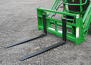

Got this 14 kw generator on a small trailer, hooks to the rear drawbar and PTO of my JD 950 with loader. Provides survival during our frequent winter power outages. Big problem: backing it back into the barn when crisis subsides. Tractor mostly outside to disperse emissions, attached trailer remains behind under shelter of barn But trailer twists sideways and jackknifes during backup return. Tractor and trailer both short wheelbase. I spent years backing a bass boat into launch ramps and parking slots with no problem. The barn door at 8 ft is too narrow to permit much steer adjustment (loader hits frame). Detaching gen and backing by hand is a real p.i.t.a. for these old bones. Got any suggestions ?
Got forks?
RbhAuto Clamp On Forklift Trailer Hitch Attachment 2" Receiver Trailer Towing Adapter with Chain https://a.co/d/1Fxid9J

The neighboring farm has an 18KW trailer mounted PTO generator. They use an adapter to put forks on the 3pt hitch. They just pick up the trailer with the forks and set it wherever they want. It's rigged with a PTO driveshaft so the genny can be used while its on the forks. Makes a great portable power supply.
