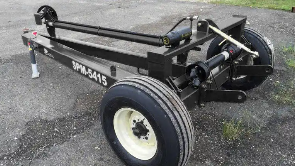

How about this?
It would be a good summer project for ya.
