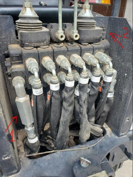

BTW, which one is the relief, the #1 or #2?
I agree with ptsg. Number 2 seems to be the relief value - but I'm puzzled by the location. Still, if you put your hand on that control assembly and do not notice some sort of vibration when the motion of the BH stops, then I'd say that your relief valves are OK. I don't think you would miss the vibration of the relief valve working.

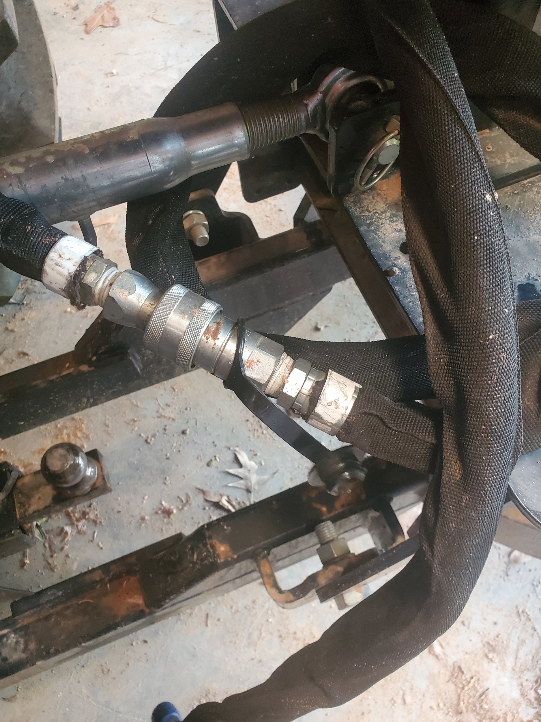

Also, what supports the idea of the connectors, the problem started with 2 stops per swing every 1/3 of the way. After i disconnected and connected the BH it changed its behavior and now it makes 5-7 stops.
I checked the connectors inside, they look like new, no dirt, no rust no anything else.
Hopefully tomorrow i'll be able to get new connectors and install them

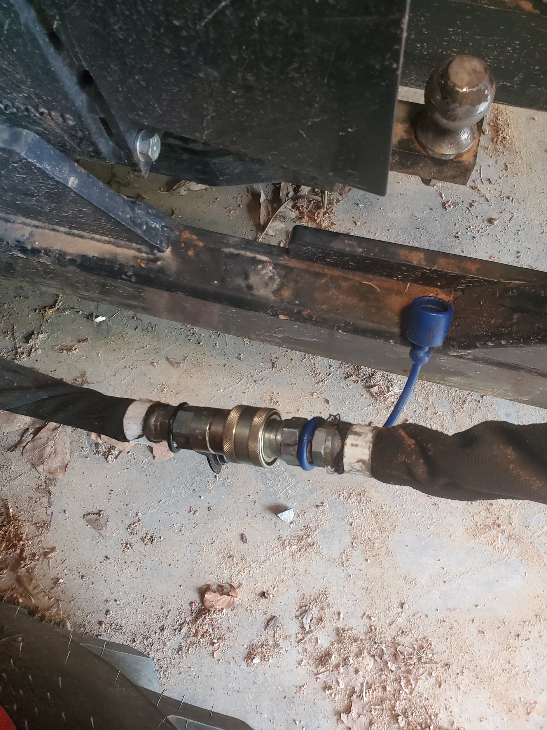

Are you saying that that those ones are not good connectors? Which ones should i buy and how can i see the difference between the good ones and bad ones?

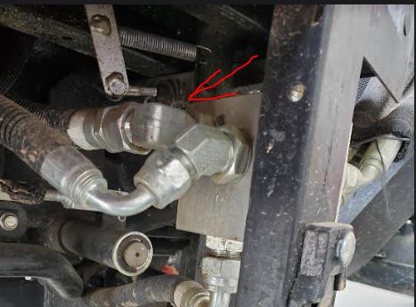

Also, i took a picture of the connection where the hose is connected. I guess it is PB point?
The support for the idea of the connectors is simply that something seems to be interrupting the flow and the connectors do have the ability to do that. The hydraulic force is going to be able to move most anythng else out of the way. I don't see anything that tells me those connectors are inexpensive or otherwise... and don't know of any way to tell. This is just speculation on my part because what you are having happen would make sense if a spring/ball blocking setup went bad.
The fact that it chanced when you disconnected and reconnected them sounds pretty suspicioius too.
BTW, if that device #1 is indeed a check valve as ptsg says.... then we have to include the check valve in the list of possible culprits. First I would confirm that the hose to #1 is the input pressure - if your hoe is plumbed like we think, that hose should come back from the front loader control valve PB port.
If so, see if tapping on the check valve changes things or if you can feel a vibration there.
As much as i understand the #1 is on the return hose, going back to the gear box. The one which comes from the PB is on the opposite side just below the #2 relief valve

1. Removed the check valve, took out all internals, leaving virtually a hallow pipe, installed it back - no luck.
2. The dealer came with new connectors, we installed them, - no love ether.
