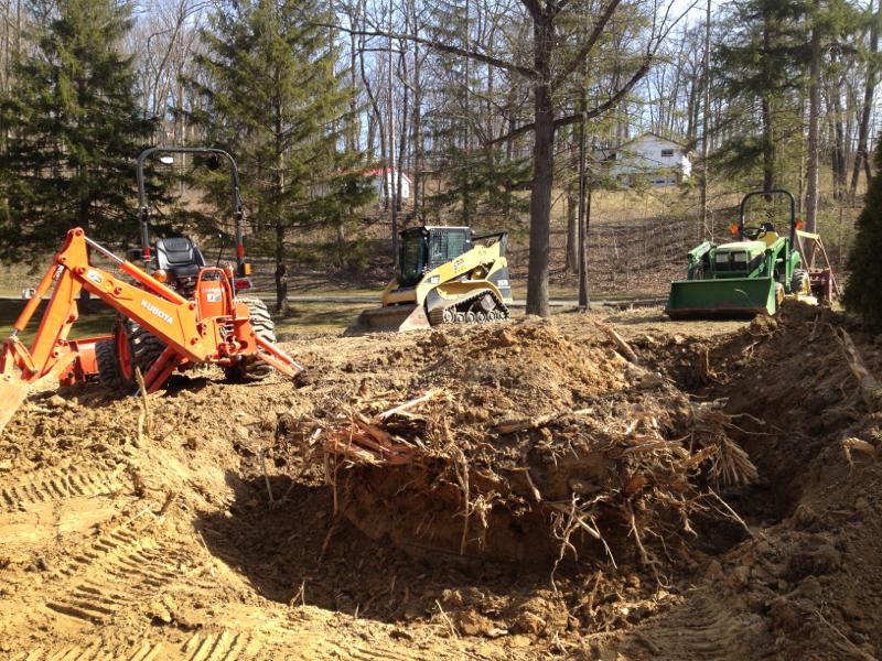

B2320 and BH65 can't make this 100' pine any smaller. Now I need to rent an excavator. The Cat skid steer in the background would not budge it either.

Just a thought. Dig a deep hole on one side and then roll that sucker into it and fill in over it.......

Pine trees can have a DEEP tap root, if you can dig a deep trench on one side to expose most of the tap root you may be able to push/pull it over, then pull it out?

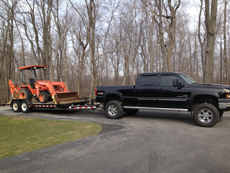

I'm on my way back to the house with this. We'll see how deep those tap roots are.

Had almost the same suggestion... go deeper and wider so you can get to the underside better. With the BH sitting at the edge of your hole, you don't have the reach to get underneath the stump any further, but you're not out of options by any stretch. Make a ramp down into the crater, then drive the backhoe down the ramp so you can dig more underneath the stump. Eventually you'll remove enough material that the stump becomes unstable and you can topple it. That is one big honkin' stump, so be careful where it falls!
Then you can grub more soil away until you can move the actual stump, probably pushing and pulling with your equipment.

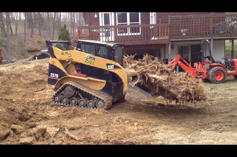

Well between the L35 and the cat skid steer, we got it out. Neither one of them could pick it up so we used both backhoes to clean enough dirt off to lift. The Cat rocked all the way back to the side of my hill where I dropped it.
Then since the L35 was here, we've replaced the 36" diameter pipe that serves as the bridge to my house.

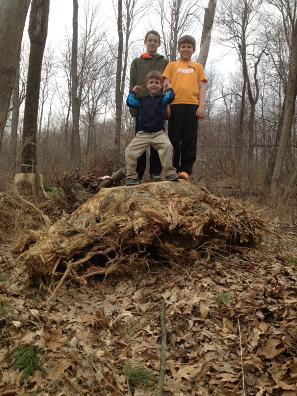

I kept coming in underneath with my backhoe to remove the material. When it finally let go, it took both big machines to roll it over, my b2320 would not have had the power. Once we scraped dirt off for an hour, I'll bet it still weighed 1500 pounds. It went up to the pile of ugly stumps on the hill behind the house. They provide a good backstop for shooting.
Actually all it cost me for the stump was a little diesel fuel and payback a favor to two different friends.

I'm betting a little more digging on one side and chaining up all 3 of the machines in the first pic would have pulled it out, but nice job all the same. Like a few others here, I have a hard time admitting defeat, I'd have probably turned the tractor around and started digging a canal with the FEL!
