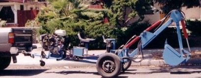

I built the following loader and backhoe combination last year.

Thanks. The tractor is only 12HP. Weighs 2000lbs or there abouts. 6'2 loader lift, 6' backhoe dig depth.

Is your backhoe your own design, I'm impressed with the capacity!!
