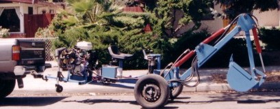

/ Backhoe- Build or Buy? #15
BG:
First, let me say that I don't want to discourage any DIY person from
building a home built backhoe. It is a great learning experience, esp
in the areas of hydraulics, metal fab, machine tool use, welding, and
heat management.
My CADDigger 728 cost me maybe $3K in materials, and the few services
I needed to pay for. (cutting 2" holes in 1/2" plate is hard & that was
before I got a plasma cutter). Back when I did my hoe there were just a
few of the metal parts available pre-cut. Everything was cheaper then, too.
My engines were free.
My time in the project? Easily over 100hr; prob less than 200hr. I sold
it on Ebay for $3050 after I finished the projects I planned for it.
Does it make sense to build one, based solely on economics? No. There is
plenty of fab work involved in fixing up a trashed used hoe (ask JB!), and/or
there is plenty of fab work involved in building a subframe for your
tractor and a used or new hoe you buy. Not to mention customization,
such as a thumb or grapple.
