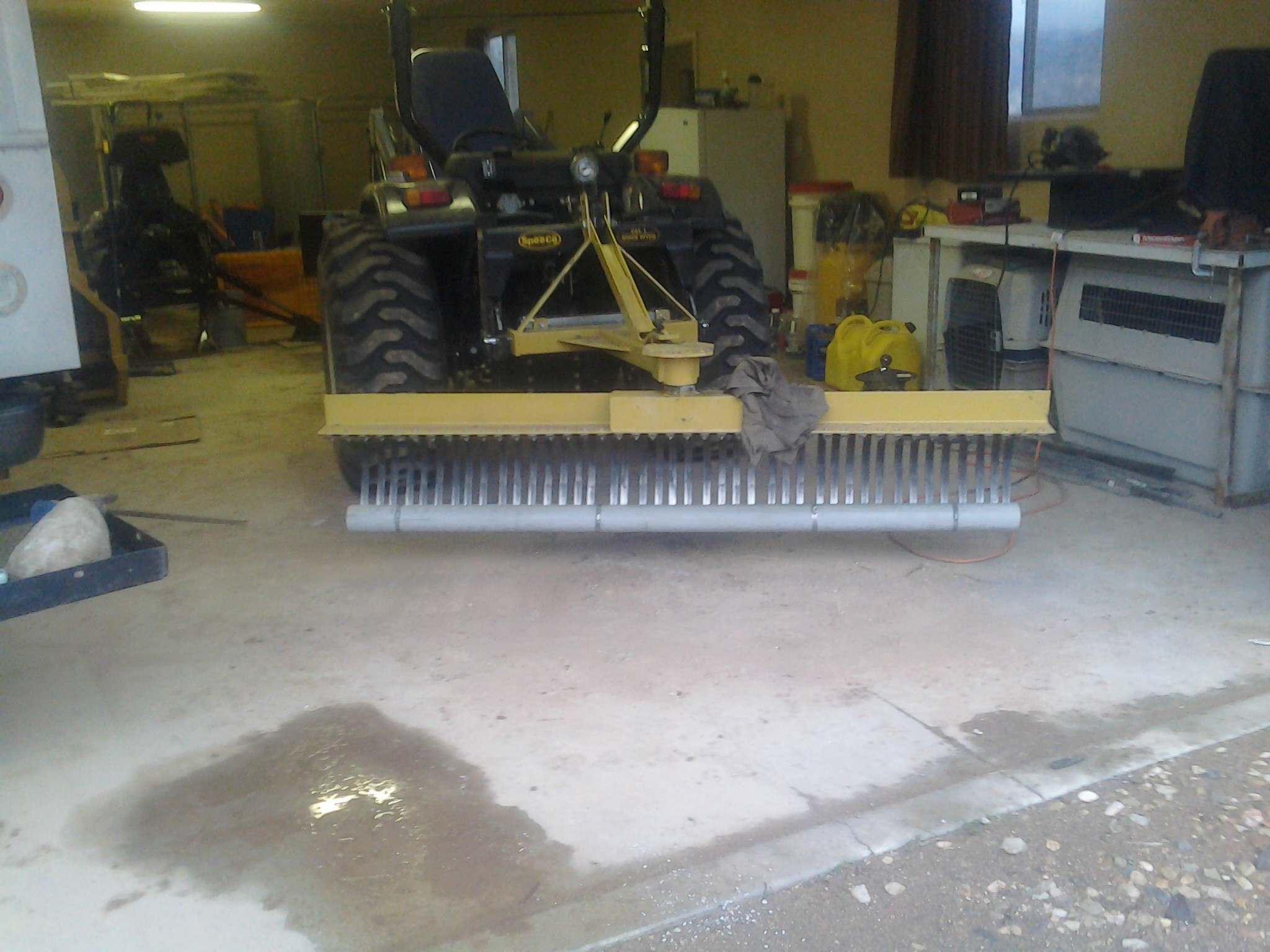

Hello, I live in southern Utah, we get some big dumps, and I use a rake with a piece of pvc pipe on it to keep from destroying my road. do you go forward or reverse with either implement. I do have to go up hill then go backwards. If you say it will be easier then I am in.

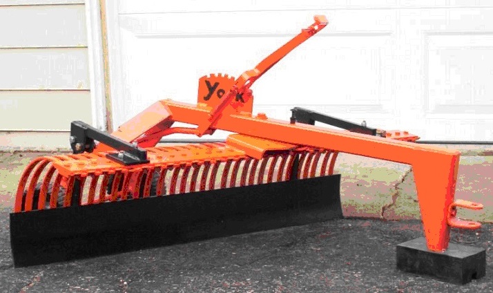

Okay, I get it. For those who want to use their landscape rake, why not bolt a 1x8 board on the bottom and see how that works? This pic is a neat example of a metal strip that flips up or down depending on your needs

Landpride offers a bolt-on blade unit similar to this one for their landscape rakes for about $500. I briefly considered that option for my rake. But, for me the $500 went a long way towards the purchase price of a new blade.
