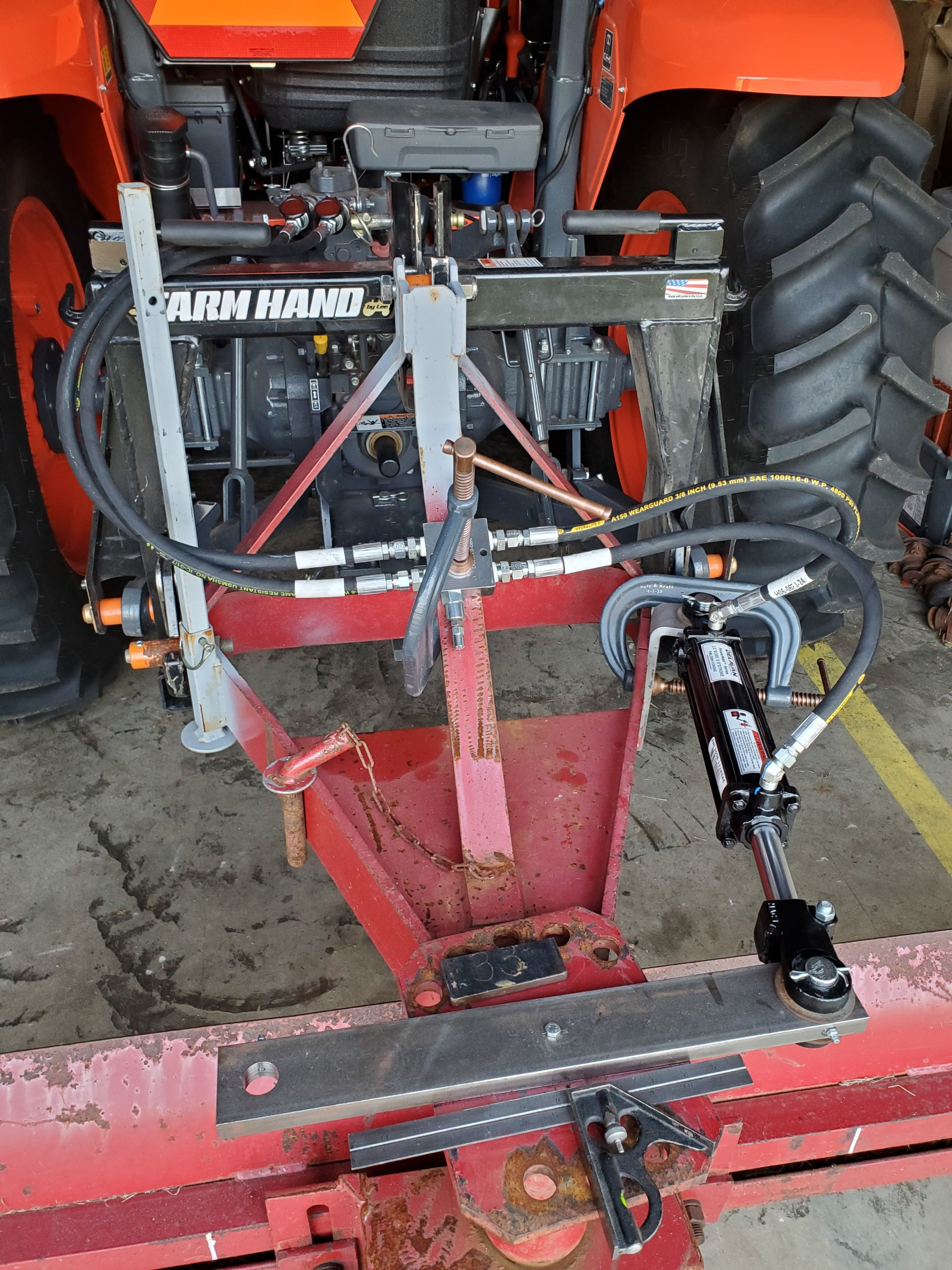

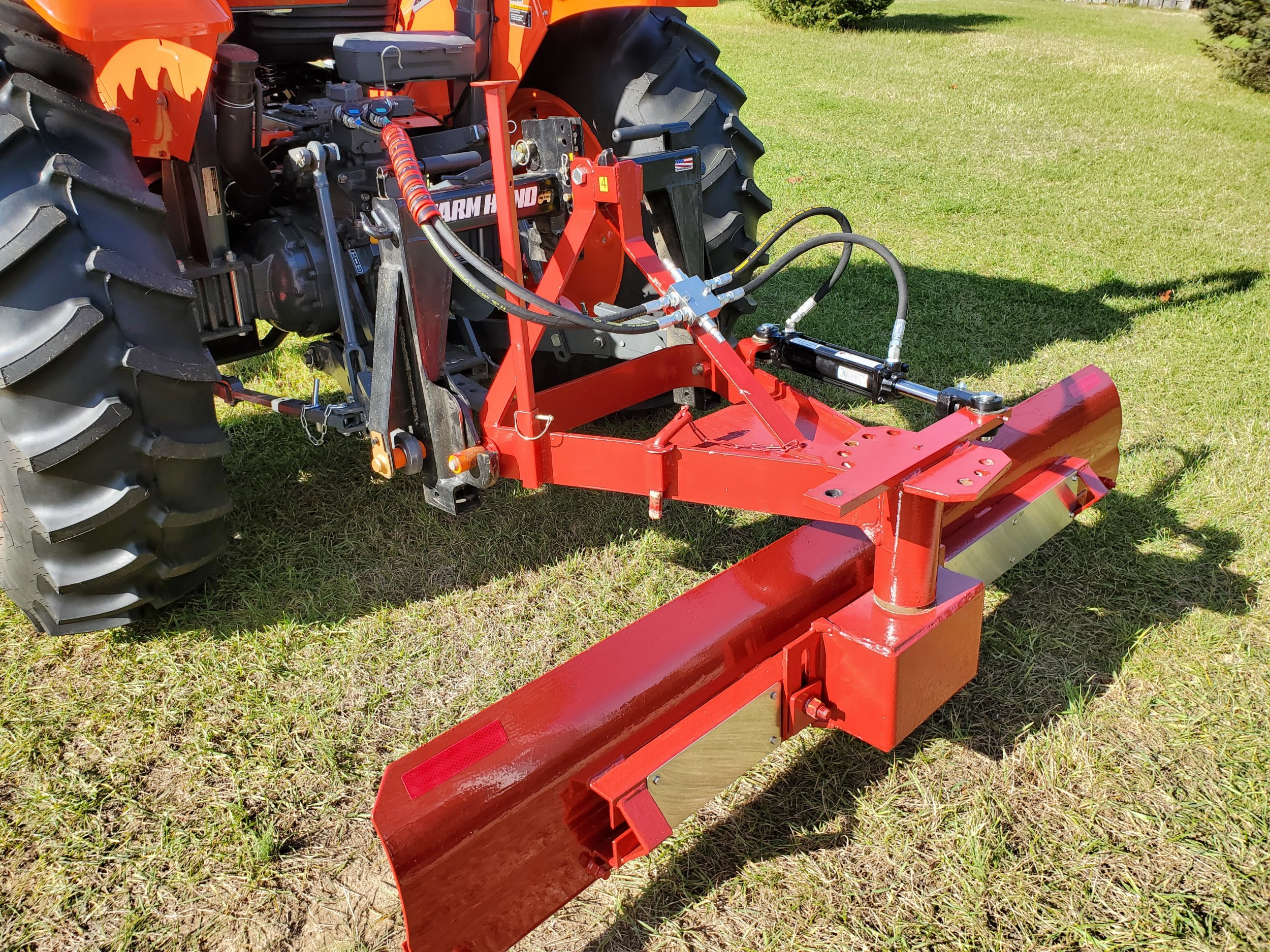

I may have missed it, but has anyone mentioned a crossover relief valve to prevent over-pressure if you hook the end of the blade? If the pressure in either line exceeds the relief setting it momentarily dumps to the other line, preventing a dangerous situation.
Once the pressure goes back to normal levels, the valve closes again and normal operation resumes
I can see the crossover relief working if the cylinder is being forced to extend. In a situation where the cylinder is being forced to retract, however, the volume of oil in the base end of the cylinder being greater than in the rod end would actually intensify the pressure. Right?

Cross over relief only protect if cylinder is trying to extend. Not a good thing to rely on...it is best to just size cylinder appropriately.

I may have missed it, but has anyone mentioned a crossover relief valve to prevent over-pressure if you hook the end of the blade? ,,,,,,,,,,,,
IMHO, the OP DOES NOT want a crossover relief valve,,,
OCD was mentioned, think how crazy he will get when EVERY time he uses the blade, the blade rotates on its own.
The pressure on the cylinder will easily surpass the ~2,000 psi setting of the relief.
When the bypass pressure is reached, the blade simply rotates.
You are looking back, the blade is rotated "right"
Hit a minor "snag", and the next time you look back, the blade is rotated "left".
The cylinder will easily work at ~4,000psi, maybe even 6,000psi.
I used to specify cylinders,
the company that made them stated the minimum safety factor they designed to was three to one.
If the working pressure was 2,000psi, the cylinders were designed to survive 6,000psi.
I think it will surprise you to find out how easily that cylinder will go to 6,000psi.

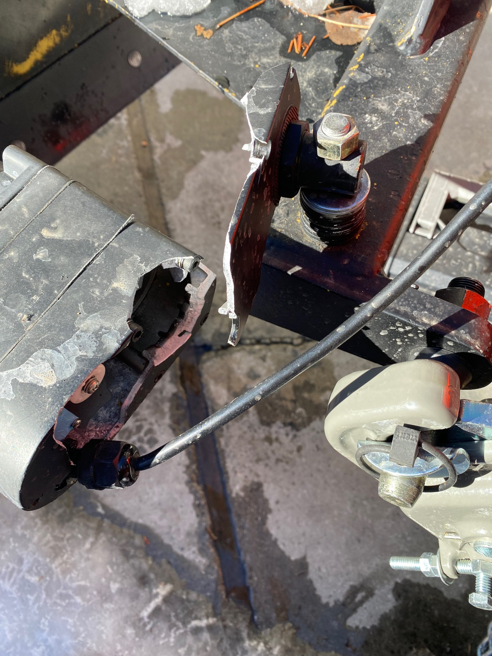

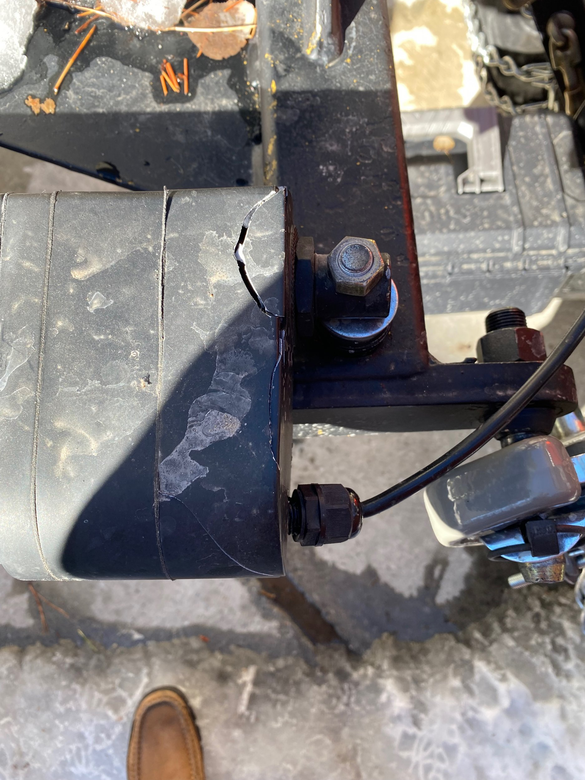

i used a similar setup with a Progressive Automations electric actuator, 2000# load with a 3000# static load. It worked fine till the end piece, which is made of cast aluminum splattered. They are sending me a new end piece, which I have to pay for, and I am going to reinforce with steel backing plates. I am also going to use soft 1/2" bolts for the mounting so one will shear vs breaking the actuator. I wsas using grade 8 which bent.
I do not understand how an aluminum casting can withstand a 3000# load and as the photos show it cant.
Not quite. The crossover on a DA cylinder will only allow it to rotate one way on its own without operator input

,,,,,,,,,,, depending on lots of factors, like air in the system, and whether this high pressure can get oil past the piston seal of a $99 cylinder .
Even at that, OCD will not allow one to have any rotation of that blade, one direction, or not,,
Sure, if there is air in the system can cause a little blade movement. But a proper functioning system wont have air in it, only oil. And it dont matter if its a $99 cylinder or a $999 cylinder.....oil cannot move past the piston if the rod is trying to retract. Not even a little bit. A crossover will only protect when trying to extend the cylinder....but that creates another problem....you are sucking air in the gland seal. Air and god only knows what other contaminates and dirt/dust/water.
A crossover is designed for something with equal displacement, like a double rod cylinder, or a pair of equal sized single acting cylinders...or like trying to run a hydraulic motor with high inertial load off a tandem center valve and not a motor spool.
