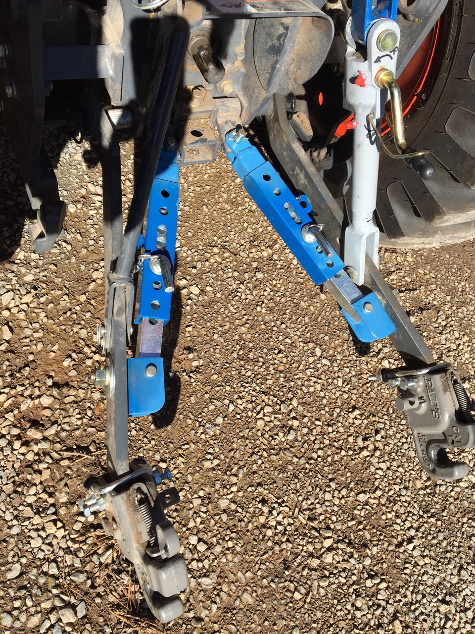

I just got the telescoping links installed on my B7610. It only took about 20 minutes. I've had the parts all summer -- don't know why I waited so long to actually install them.
I'd take pictures, but it looks just like these from peterc38:

I just replaced the turnbuckles on my B7800 with the adjustable stabilizers. It took me about 15 minutes using just a couple of wrenches. Really worthwhile improvement to this machine.:) And I have Pat's easy change system as well!

It's really easy to do. It took me about 30 minutes but I wasn't trying to set any records. There is a long pin that you have to tap back and forth to remove the old brackets and reinstall the new ones. You don't have to remove the tires or anything like that.

It's real easy, although, if you have your rear wheels set narrow, you might need to remove one to get the shaft out that holds the chains.

I installed mine today, pretty simple and I didn't even have to remove a tire. I just slid the shaft to one side all the way removed old turnbuckle style and installed the new. I didn't have to remove shaft at all, just slid it from one side to another. This is the hot set-up, now I see why everyone recommended it.
