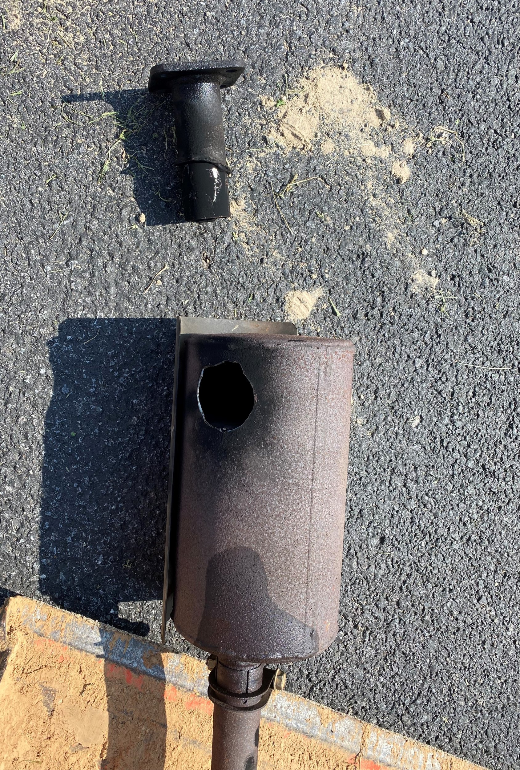

2003 Kubota B7800 (new to me @ 435 hours
The muffler sits up on an exhaust pipe that ties into the exhaust manifold. There is virtually no support for the muffler, so the joint where the exhaust riser is welded into the muffler takes all the vibration. Well, after 800 hours the metal alongside the weld in the muffler failed.
Had my local welder put it back together and add 2 supports as seen in the 1st photo. Why they did not do this at the factory is beyond me....it would have added a couple of dollars at most to the cost.

It lasted 800 hours on a model that is 15-20 years old. Hard to call that a flaw at this point. Could be done better for sure but you’re way past the point where this would escalate.

Good welds don't break. They are automatically stress-relieved. Usually the base metal cracks next to the weld.

If you look at my picture, it was not the weld that failed...it was the metal near the weld.
The good news is that the muffler is easy to remove, and my welder only charged $32 to reweld the muffler and add the 2 braces. If you have welding skills might be worth it to pop the muffler out and add bracing.

Mufflers aren’t necessarily a lifetime device. They eventually rust out. If that’s the worst design fail I’d say they did pretty good.
