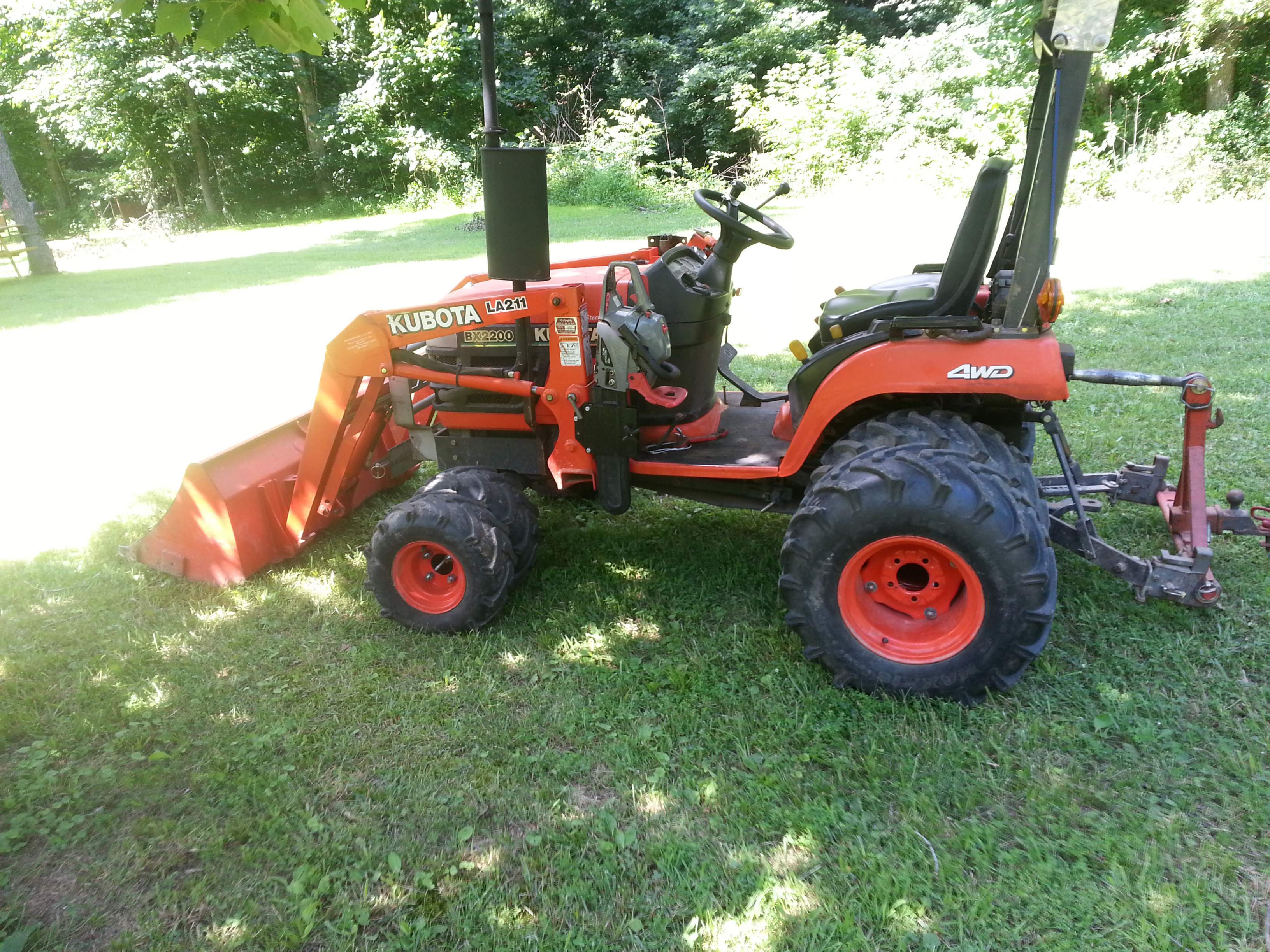

B7800 with exhaust stack, and muffler removed
   / B7800 with exhaust stack, and muffler removed #11
Nice, but.....I have to remove my bucket every fall to install my front-mount snowblower. No way to back out under that crossbar that I can see if you ever needed/wanted to remove the bucket. Wish I could do work like that....Regards, Mike
#12
No problem, you could do the same thing only run the up pipe behind the crossbar... I am in the process of modifying it now to take care of a couple issues. Watch for a couple updates...
#13

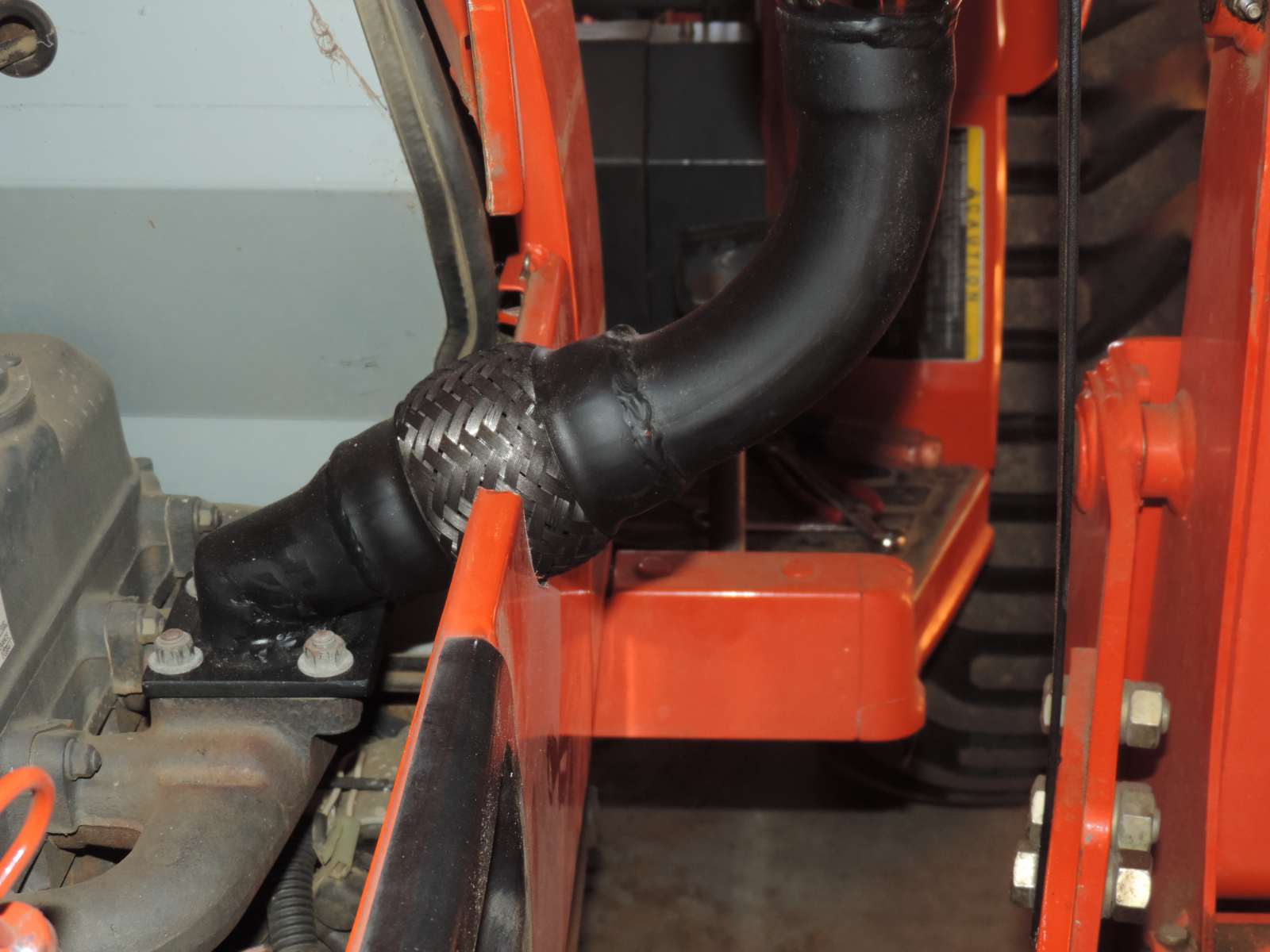

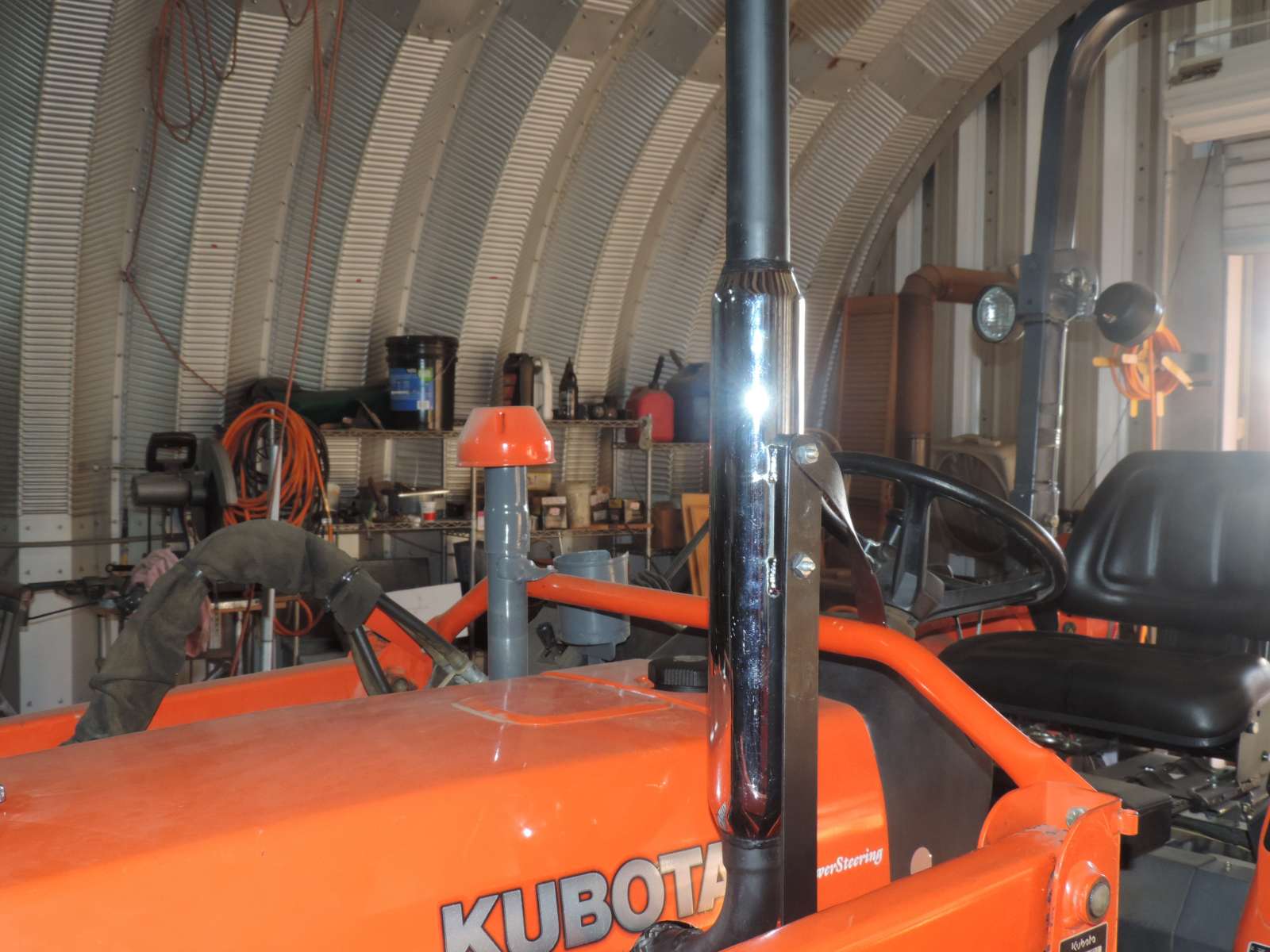

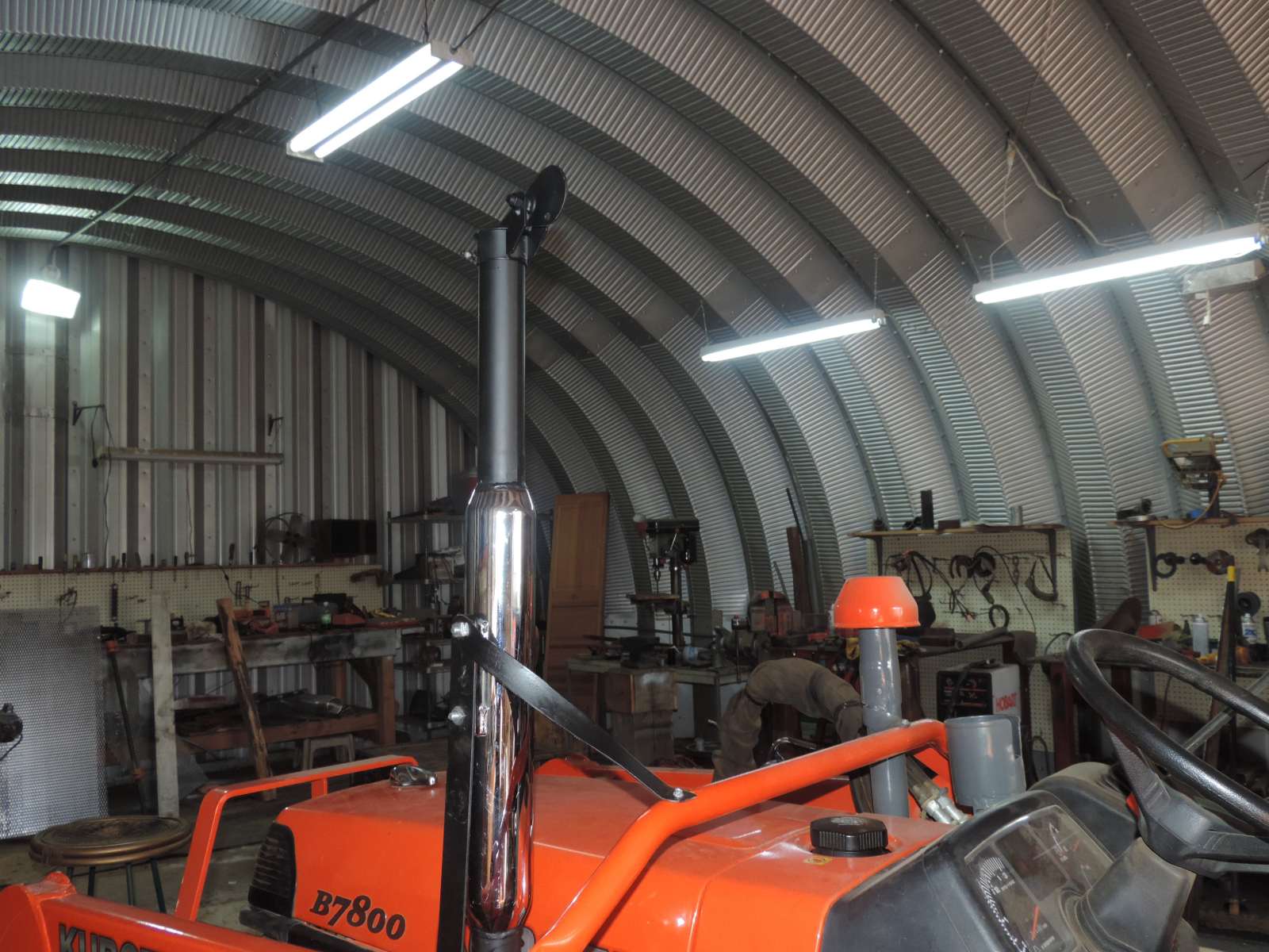

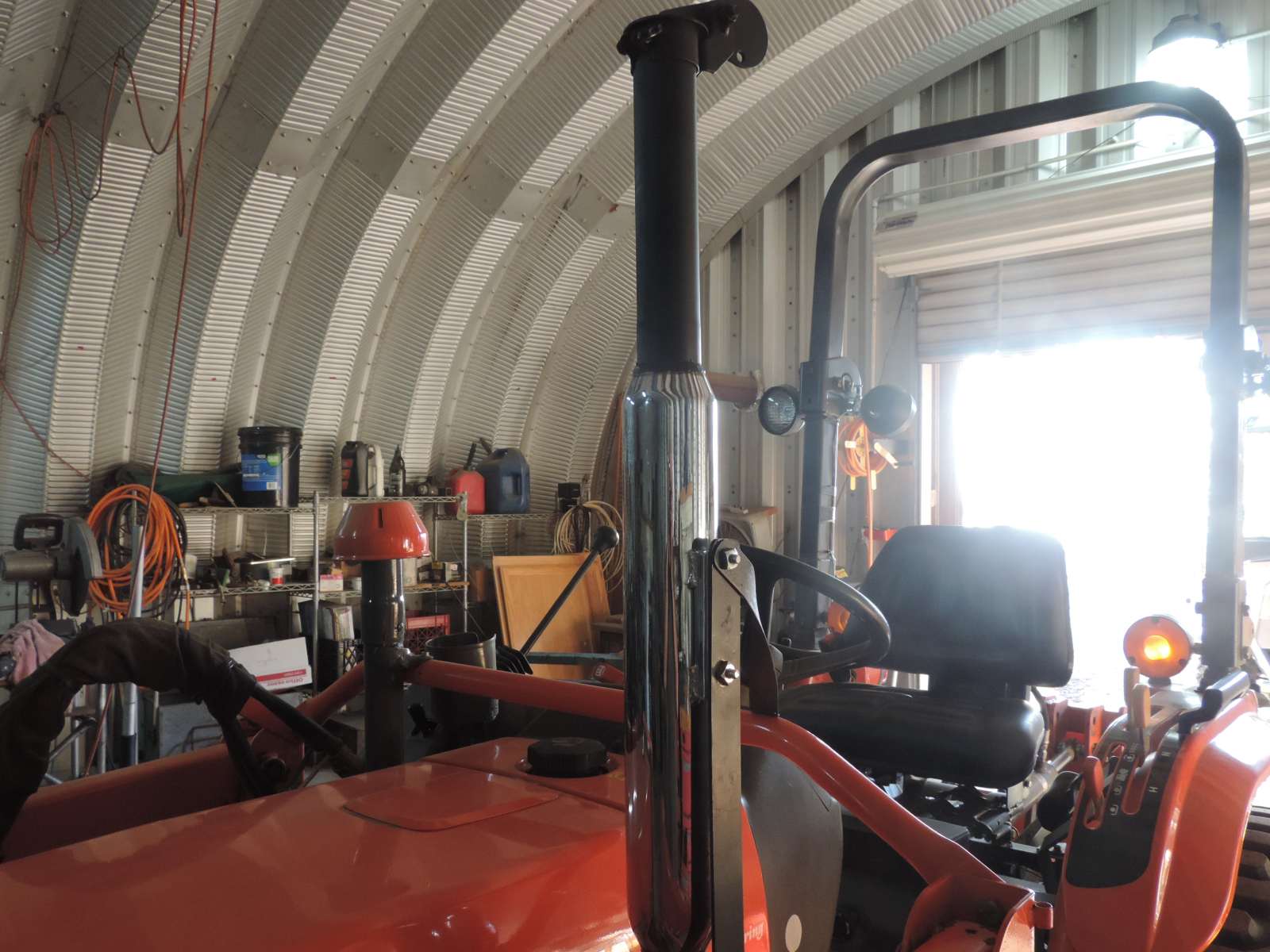

I modified the new exhaust to take care of a few problems like vibration that could possibly crack the manifold and the loud sound... Took my original mods to a muffler shop I had used in the past and he came up with a flexible connector and he had a used muffler off of a Harley, he modified every thing and I made new bracing for it and added a rain cap, I think it looks great and sounds good now. Very happy with it... I guess I will have to change the RTV over next...

Thats really nice, I love it good job.

Looks good! Cant beat the old school tapety tap sound of a rain cap at idle.

How does that motorcycle muffler sound? I had an IH Cub muffler on mine for a while and it was too loud, then I found an oval muffler that fit 97 Civic and sounds much quieter. Good idea on the flex joint, looks just like the one I got, just haven't installed it yet.
Oh yea, we need to know about that breather too, have you done a thread on that?
Yes, have done thread on breather, I posted it a couple of days b4 this one, the Harley muffler sounds great, but not as good as the old J.D. one lungers, (pop-pop) and not as good as my Harley sounded when I had one (sure miss it). I have noticed a little more power and it is not using as much fuel..... Don't know what it will do in the 1/4 mile, maybe 17 mph!!!! :laughing:
