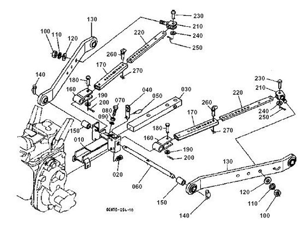

This is one of those questions that comes up every so often. To bad there isn't a way to have a page with a chart where owners could go to get parts numbers and look at pictures where it has been done. Like now, Charlie could really use the numbers to give to his dealer and pictures with the tractor model showing wouldn't hurt either. A data base like that for each brand would be nice.
/ B7800 3 point turnbuckles #5
Something like this?

Yea that is them Charles, They wanted over $500 for the parts so I just orders another set of Turn buckles for now. I'll live with it, on a grand scale it is a mild irritation. I have to many other things to deal with these days

For what its worth, I changed out the turnbuckles on my B7610 for the telescoping links about a year ago. I believe the lower link arm geometry and size is similar between the B7800 and B7610. Since I am always changing 3PH implements, it was one of the best upgrades I have ever made!
Paid about $130 for the telescoping parts from my dealer. Very easy change over.

I changed mine a few years ago. All together the parts were under $150. I figure that I would have spent that replacing turnbuckes by now.
