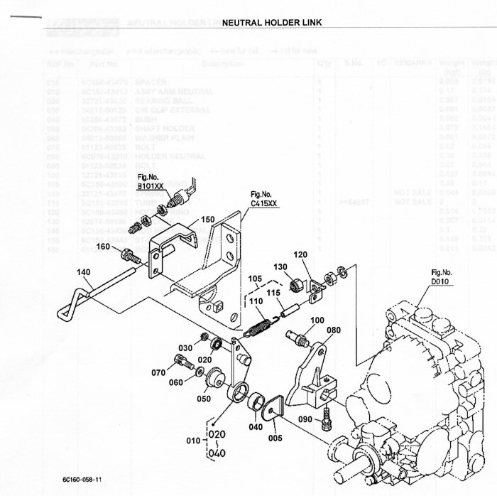

For sometime, my 5 yr old B7510 HST would continue to move slowly forward when pressure was taken off of the pedal, and often would have to tap the reverse pedal to stop it. Sometimes, the tractor would not start until the pedal was re-centered. This happened yesterday and again I tried to exam the pedal linkage cluster under the deck.
For the first time, I noticed the Zerk fitting on the HST pedal housing and greased it. I also sprayed some Blaster lubricant on the other linkage parts. No the tractor sits in the same spot because it wont start. Turn the key and "click" is the only sound. PTO is off.
The forward HST pedal now seems to sink to the deck and the reverse pedal is higher. In addition the inherent pedal friction seems to be absent. I checked the fuses and they all appear OK. I have not yet jumpered the seat shutoff switches, but will try that after I leave this note.
I ordered a shop manual, but that won't get here for 2 weeks. It's very difficult to see and understand how that linkage works. I called a local dealer, but he was of little help and no ideas.
Any suggestions?

Bttery, fuses are all fine. There must be a cut off switch for non-centered HST Pedal, because it won't start if not centered, but I don't know where it is.
I tried jumpering the under seat switches but to no avail. I don't see a "V notched plate." When it stops raining, I'll post a picture of the cluster.
Here's an update,
I took the right rear wheel off and can see where the rod that comes through the bracket, doesn't anymore. Thus the cut off switch is in the open position. I managed to remove the pedal return spring or shock. I can't tell which because it's covered in corrugated rubber and now the pedal had no resistance at all. But there is so much brake linkage and stuff that I can't see how the rod even connects to and is activated by the linkage. Anyone have knowledge or diagrams?

I have to go out now and try and get part of the deck off etc. It is NOT the cut off switch. I pushed the contact in with a screw driver and my wife could turn it over.
Look at the first pic I posted above. The rod that comes from the pedal assembly has either broken or come out of the top of the pedal. I hope it's just a broken cotter pin,
but can't see or get in there behind the brake linkage. I did remove a part called the "HST Damper" which my also be bad, but that's a spring or gas shock like part.
That's another reason to buy a tractor with a left sided brake!
more later.
Steve

It comes down to something in the "Neutral Holder Link" mechanism being broken. It appears that I can **temporarily** bypass the switch for now and get the tractor to run, since it's stuck in the driveway with mowing deck and FEL in down position. He explained that it's a safety mechanism so that it the tractor is NOT in neutral and you get off it stops moving.
Problem is I don't see any access, but the tech says you get to it from underneath.
I really need this on my Vacation, while trying to get things done.

/ B7510 HST won't start #11
Well it looks like 10 has sheared the head off and 70 is hangin in the wind. Although with all the grit & oil it's kinda hard to tell.
