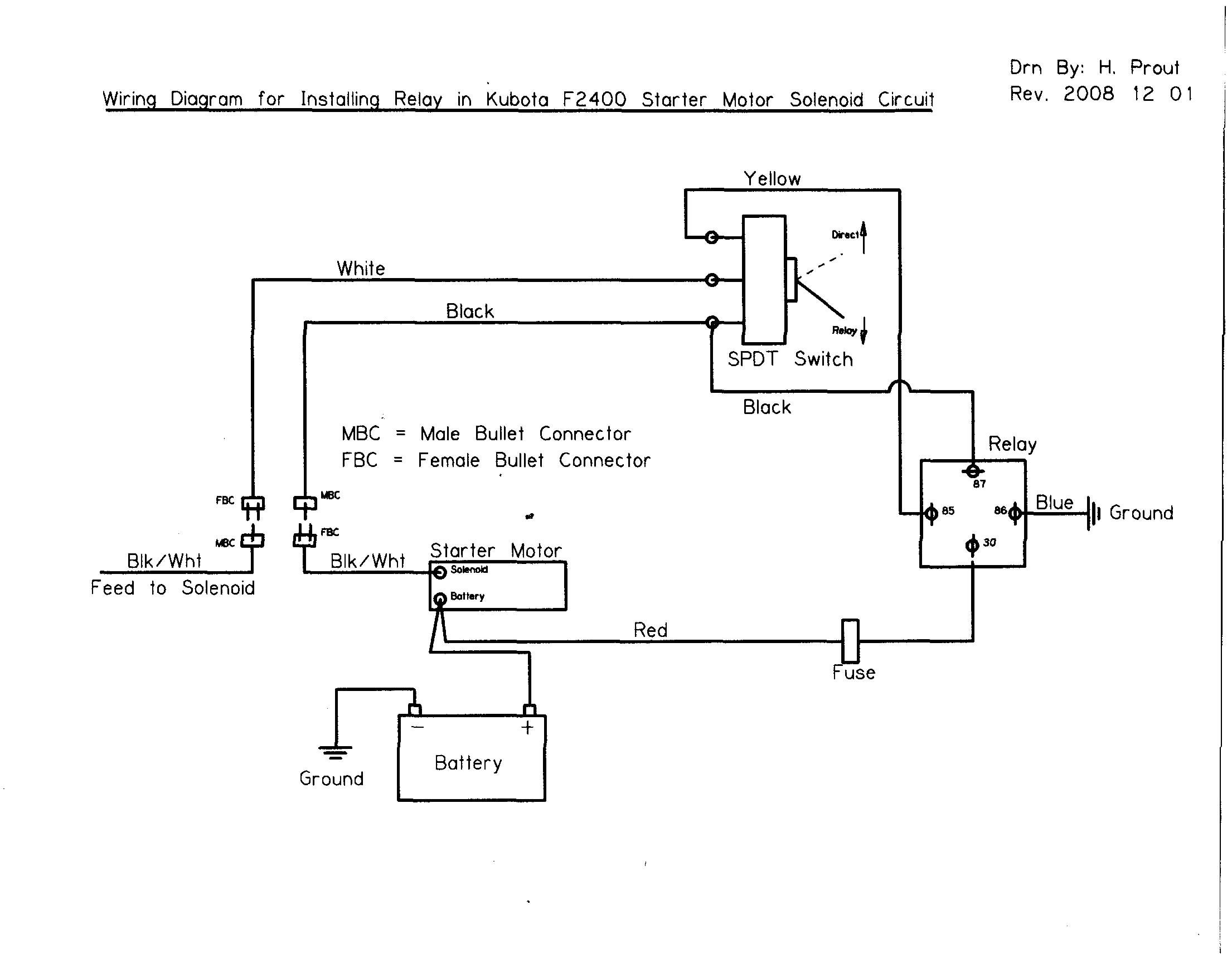

I assume it started when you used a jumper wire from the battery to the solenoid. If so, then it could be low voltage to the solenoid. That was the problem on my F2400. I put a relay in the solenoid circuit and the problem was solved. The SPDT switch is optional. Relays and sockets are available at most auto electric stores.

Try grounding the battery to the engine block. My L3650 had the same problem and it turned out to be that the usual ground to the frame was not solid enough. Try it with a jumper cable first to see if it make a difference.

Okay,
I'll try that tomorrow and see if it helps. If not, I'll look into the relay.
