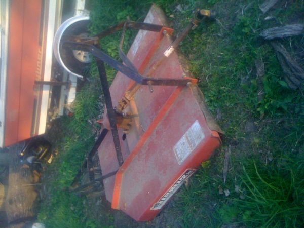

Not sure the model number but I have a chance to buy a 5' bush hog. PTO will match up but will this be ok size for my B7500 tractor? Also, check out the photo, how much do you think it is worth?

Maybe, it is a little big, but depending on what you are cutting it may be OK. Some guys do use them, but it may not handle the heavy stuff well with your 17 PTO horsepower. When I had a B7500 I used a 4 footer. Also consider keeping your loader on the front for front ballast.. While you 3pt will easily lift it, the weight is stuck pretty far out there, and will start to make the front end light. Since there is not a guard on that PTO shaft, you need to be extra careful to never get near it when the tractor is running. I am not sure what it is worth.

My opinion is to go with a 4 footer. I feel a 5 footer on your tractor is going to want to wag the dog too much.
The one pictured is actually in alot better shape than I see them around here on CL. Real rough ones start around 3 - 4 hundred , and go up from there.

4' would be a much better match. But a lighter duty 5' would work, you would just have to slow down more and use caution when raising. You have HP and weight both working against you.
Price is really regional. Around me, rough ones are $100-$200. And nice units like the one pictured are in the 3-4 range. If the one pictured were around me, I'd expect it to go for ~$400-$450

We have a 5' one that was made by Central Tractor which I run behind our B7500 and our L3830 (pictures here).
I have run into 2 issues with it:
1. Not enough HP in heavy grass, it does good in light stuff, but when it gets heavy you have to almost crawl (makes the HST on the B7500 come in handy)
2. The mower is heavy enough that you get a "teeter totter" effect when driving. This makes the front end almost come off of the ground when you hit a bump. This would probbaly be lessened with some weight in the bucket, but I haven't tried that

I bought my 5' (Land Pride) cutter from a dealer who sold Kubotas. I had a Deere 670 at the time which had comparable power to the B7500, but the 670 weighed a couple hundred pounds more then a B7500.
I went to look at a 4' cutter initially. The sales person said they sold the 5' units to B7500 owners frequently.
I was skeptical, but the cutter did work well behind the 670, even in very heavy brush (a powerline right of way that hadn't been maintained for years). Most of the brush was as tall as the tractor's cowl, some as tall as the ROPS.
So, I think a 5' cutter will do quite well behind your B7500. There will be areas you'll be going very slow, as one or two of the previous responder's wrote.
Also, when transporting (cutter raised), you really want to watch your turning. What I did (with the 670) was to loosen the top link enough so the cutter's tail wheel bore some of the weight...basically towing the cutter rather then transporting it. Worked for me, but I wouldn't suggest towing more then a few hundred yards.
