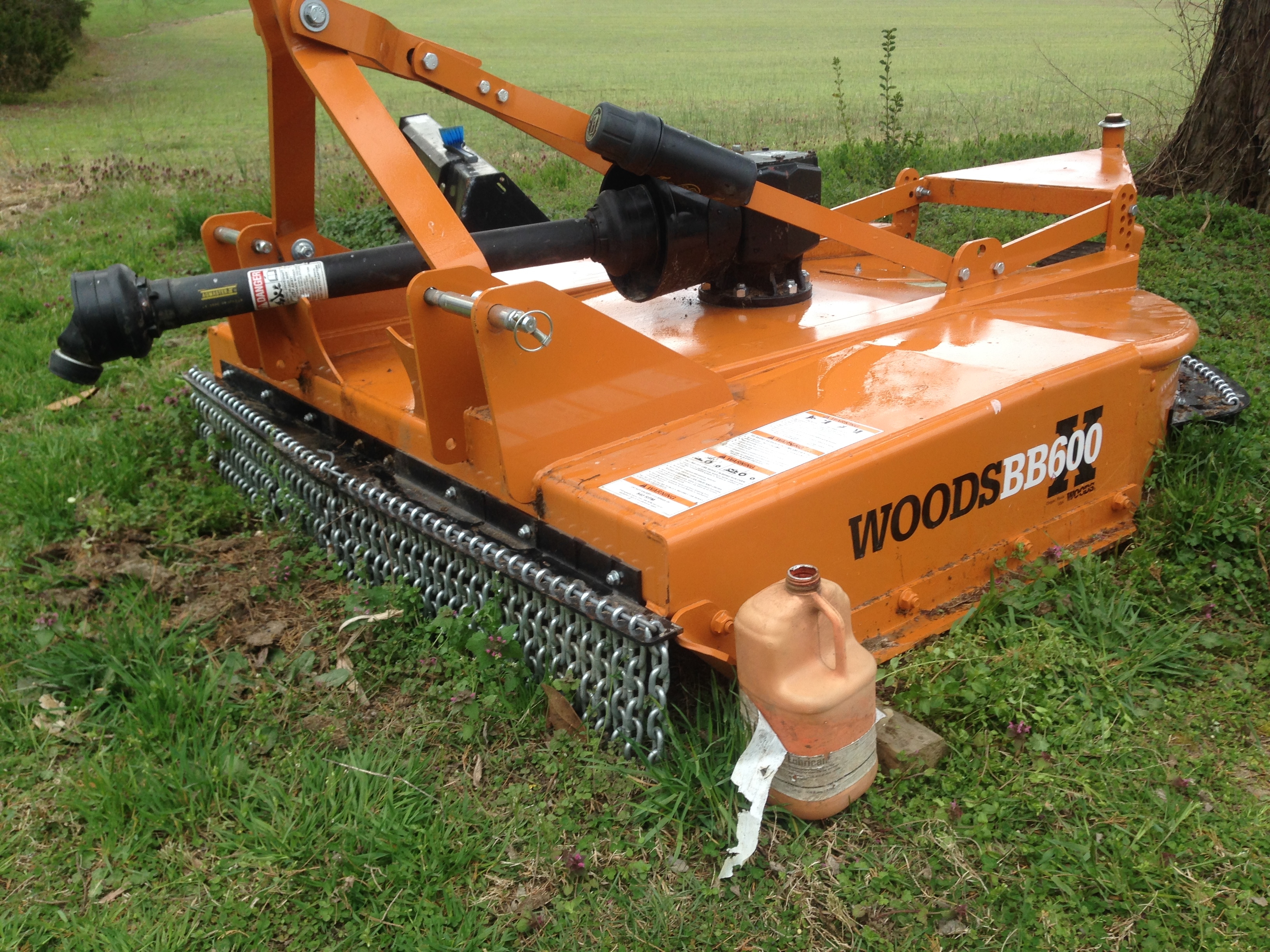

I had a Woods BB600X. Bought it for small pines and brush. It was overkill and Heavy Duty for what I was doing. It was really too much for my New Holland TC40 but it turned it and worked. Gearbox was rated for 120 HP. See pic below to get an idea of how big and heavy it was. I set a big chainsaw lube container next to it to show how big it was.
I eventually sold it amd bought a Woods BB72X. Much better and cuts up to 2 inch. It is medium duty and handles everything I throw at it. Just make sure you are aware how heavy some of these units are and make sure you really need that capability.
