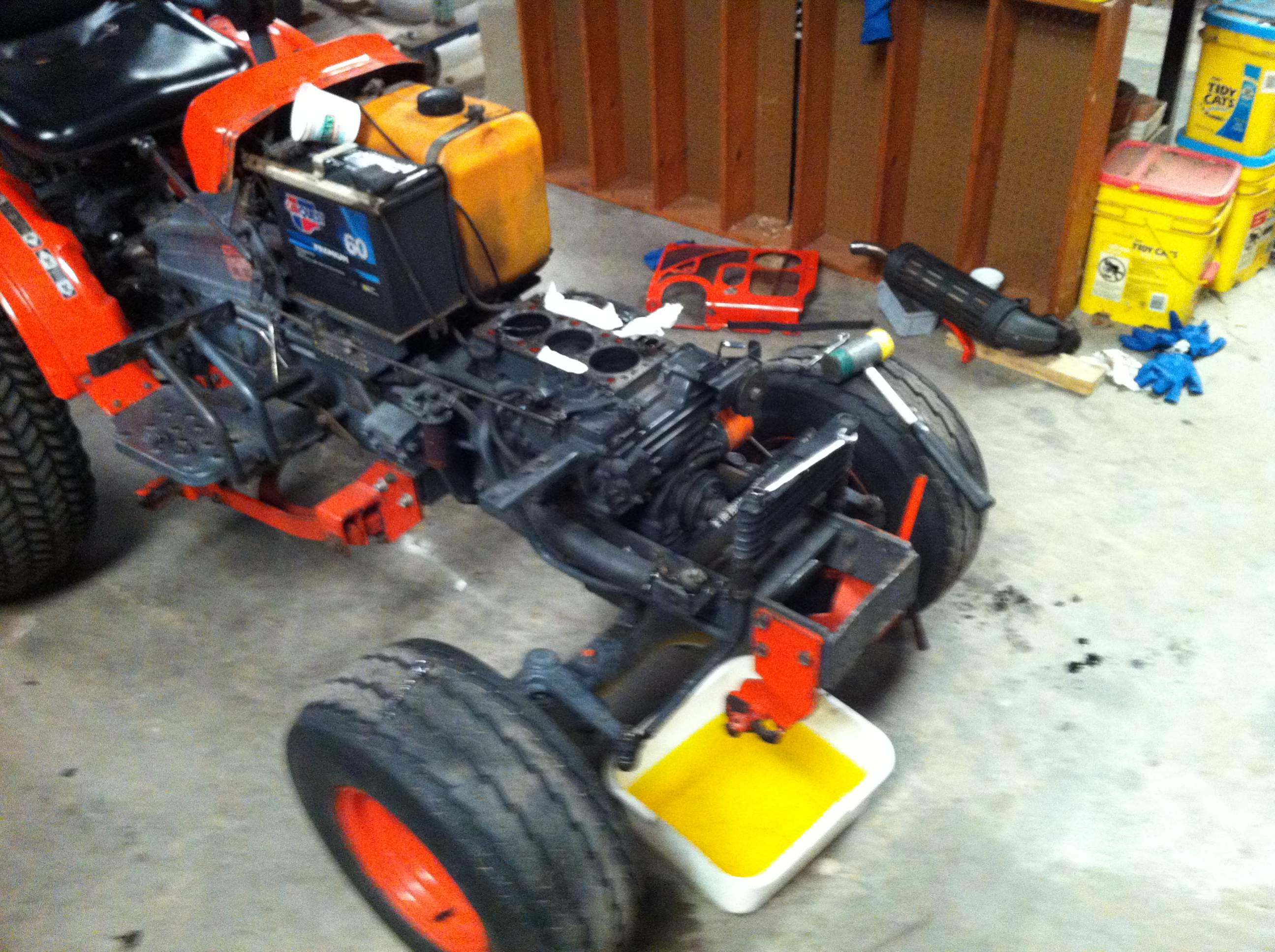

Hi, I have a second series B7100 with 3000+ hours, and I am getting bubbles in radiator.
I did a quick search and did not find much. Can I get a few suggestions or some advise, I have not done a head removal yet.
It was over heated 7 plus years ago but the radiator has been overflowing for about 4 months.
That sounds bad but, it has not really been run much this summer maybe 20-30 hours with over flowing radiator.

Replacing the head gasket is Not a bad job, relatively easy...
it will prevent any additional damage that will happen as coolant is pushed into the oil and you will have the opportunity to adjust the valves as you finish the job...

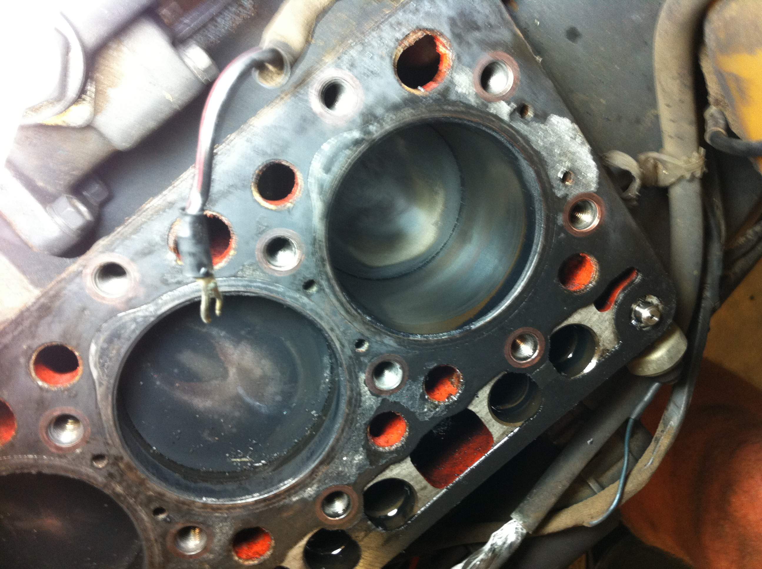

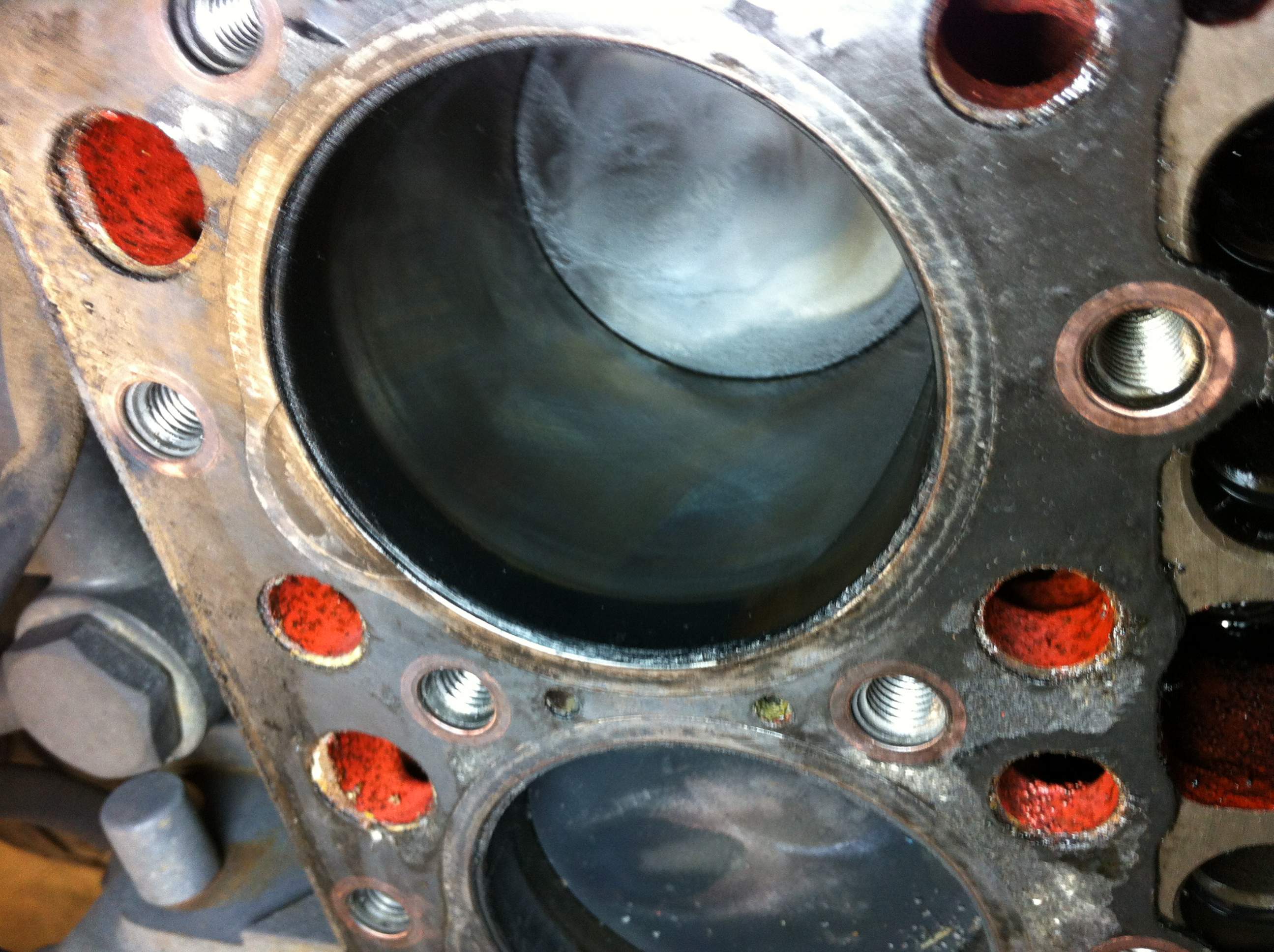

The Head is off, the cylinder closest to the clutch #1? topped out at 300 PSI with out oil, and after a few cc of oil per the WSM it went up to 405psi. the #2 and #3 went to 400 psi clean.
I hope this it the one that is leaking. I used 15w 40 oil so I hope it plugged up the leak a little. The liner looked clean and smooth not sure what i should have been looking, for but I think i might have noticed any problems.

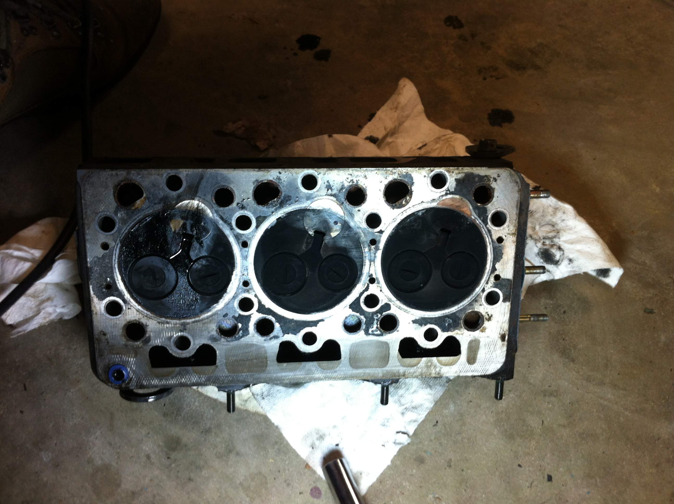

Off to engine shop on Tuesday to have the head inspected.

From the pics it looks like the middle cylinder might be leaking toward the coolant holes.

A quick test of valves is with the head upside down pour a little fuel into one combustion chamber at a time and look in the ports to see if there is any seepage down the valve stems. Leakage would indicate worn seat or clearance in the guides, needing shop attention.
From the pics, if it were mine, I'd shine up the block and head surfaces, check the head for flatness in all directions with a good straight edge, and, if it looks ok, put it back together with a new gasket with permatex copper gasket spray. As further insurance pour a small bottle of Bars Leaks aluminum into the radiator before its full.

The machine shop has the head now, seems like the head has hardened injector shields, so I needed a shop that could grind instead of cut, if necessary to flatten it.
He could see where the leak was, between cylinders 2 and 3 from the discoloration on it.
