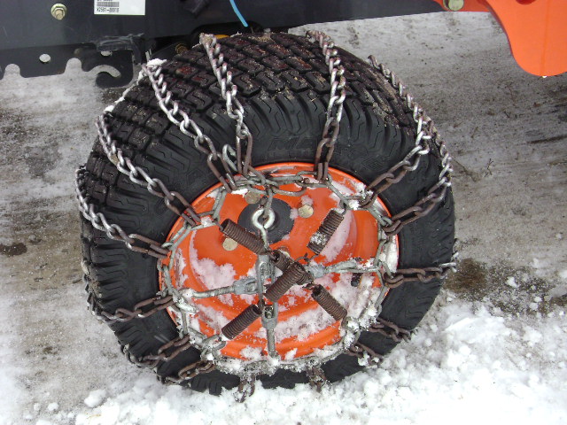

I would think that with a little extra tightening they will work just fine, just make VERY sure that there is clearance on the inside of the wheel. You really don't want those chains snagging on the tie rod ends.

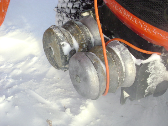

I know there will be those who will tell you not to put chains on the front wheels for whatever reasons that they will have but I have put front chains on for the past couple of seasons and I can tell you that the difference in traction is simply amazing. I have a BX2350 and I have rear plus front weights, the rear wheel weights are cast iron which I made the patterns for and had cast at the local foundry and #in at 225#'s a side, the front weight is lead and weighs around 225#'s and is bolted to the front bumper.
I haven't found the snow drift yet that I haven't been able to push my rear mount blower into and through.
