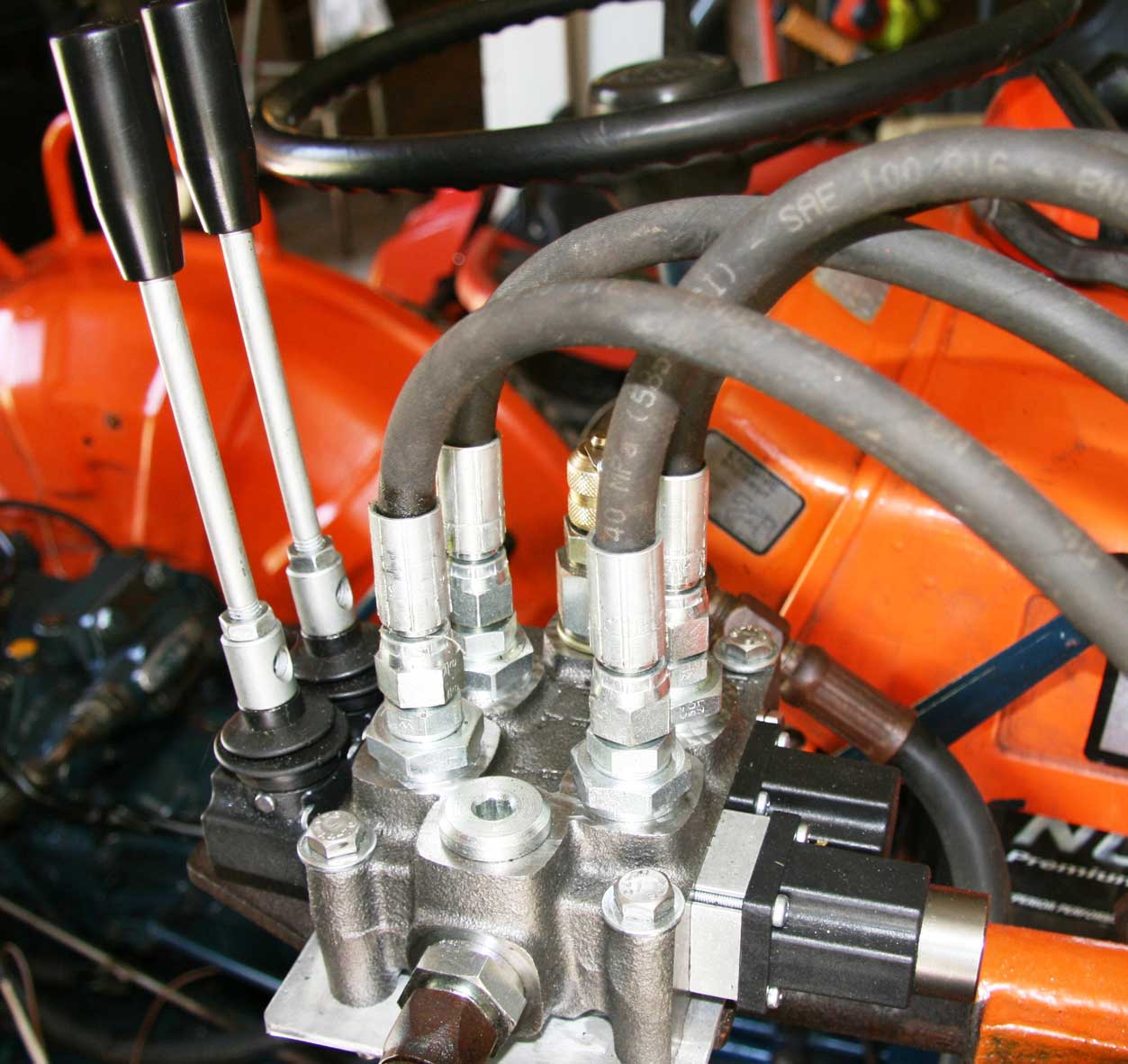

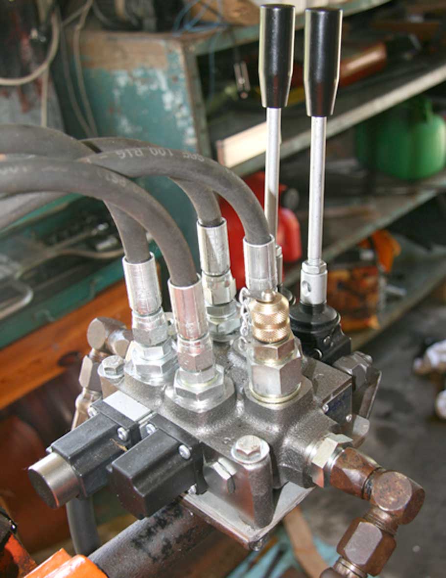

On my Brantly FEL I had an old AICO that didnエt like. So I got a new with float and it seems to work really nice. There is also a connector where I can hook up i pressure gauge. I have set the pressure to 11,7 MPa
This is how it looks:
