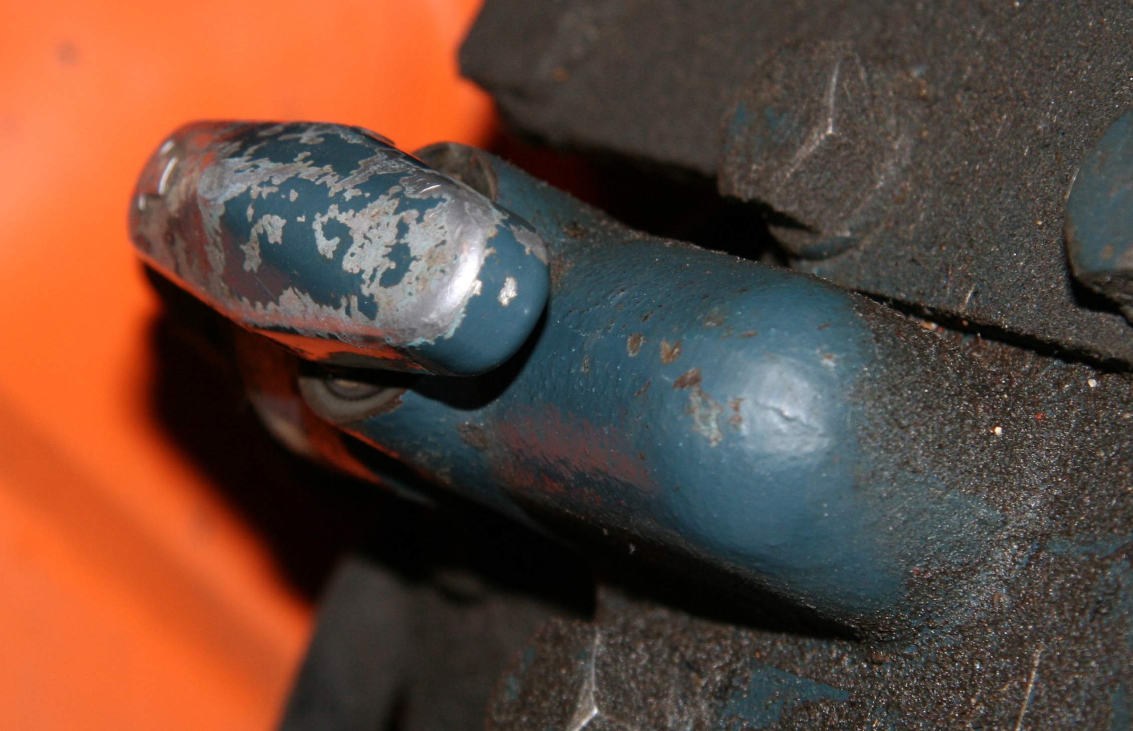

Some pics of my B6100 with a Brantly SL 500 FEL.
The hydraul FEL runs of the "ordinary" hyd pump.
Switching between 3pt and FEL is done by the diverter vent. That is my headache today since there is a leak inside the vent. This makes the 3PT to slowly sink during ordinary operation. I guess I have to disassemble the vent and swap O-rings...

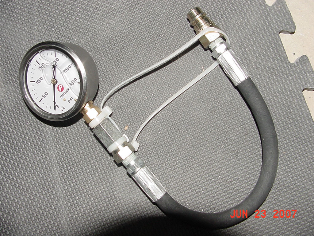

Ah ha. Well those actually do sound like useful functions. I'll have to see about getting a gauge set up....I have a couple gauges around, what pressure range gauge would I need?

A 3000 psi hyd gage set, something like this.
