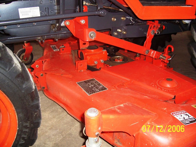

I'm not sure about the B3030, but on my B2910 with 60" MMM, the manual suggests how to adjust the front linkage so the deck will raise high enough to pin without having to lift it much by hand. After adjusting mine, I still have to raise it ever so slightly by hand to get the pin in. Maybe 1/3 of the pin diameter distance. To make the deck lift higher, you shorten the front linkage. I'm including a picture of my deck. You can see the drop bracket hanging down from the frame bracket and also see the saddle bracket sticking up from the deck. Sorry I don't have one in the up position.

Your deck looks similar to mine.....at this point, I'd have to raise it more than an inch......I'll have to look at the front linkage and adjust accordingly.
