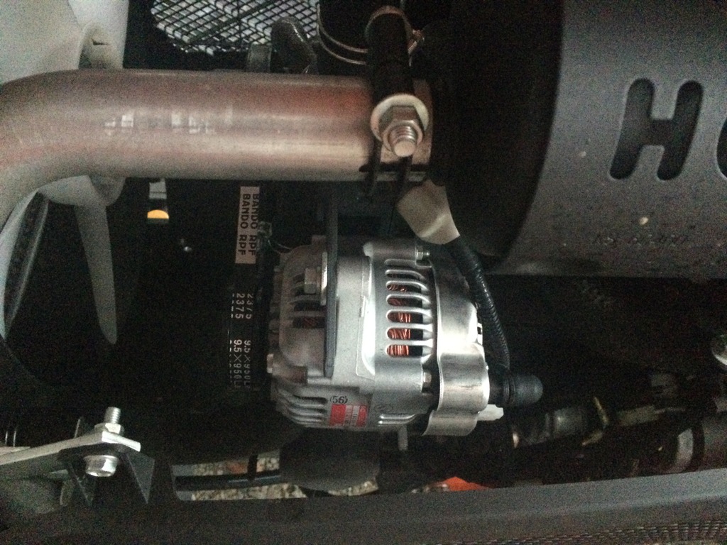

If you get a chance, snap a pic of the alternator mounted up, and a close up of the alternator data plate.
   / B2650 Question about Charging after Light Bar Install #24
Not sure what data you would like, something specific?
It is a pretty common alternator, used on a lot of applications, but for $230 CDN it made more sense to buy the kit from Kubota since it included the alternator, bracket, wiring, belt, and fasteners to do a very simple swap.

Pretty easy kit to install, maybe should have taken pictures or did a video to show how easy. It must be for a few models as it comes with extra pieces like bolts, and a dipstick.
Hopefully everybody else's install goes as smoothly as mine did, post your results.
