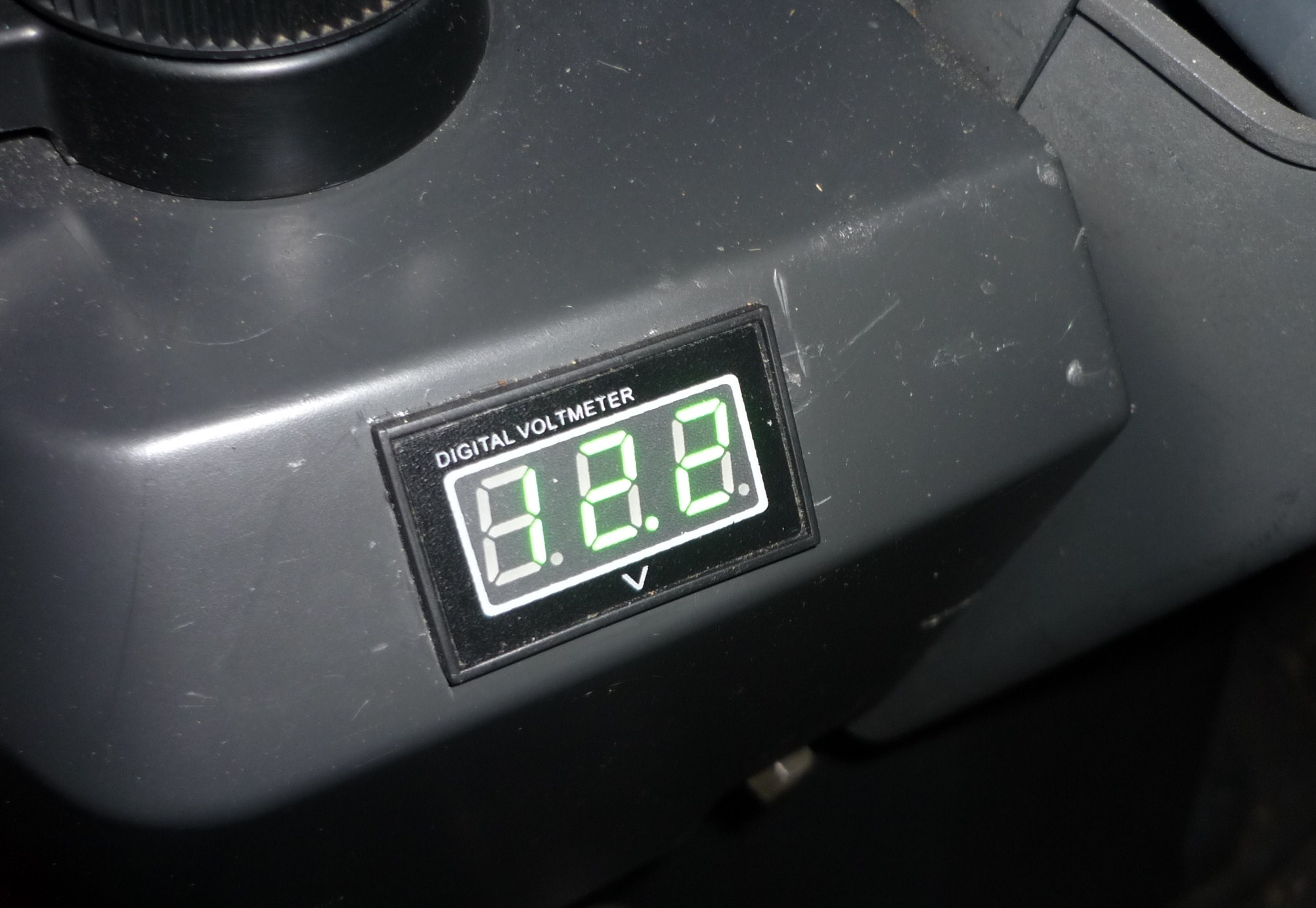

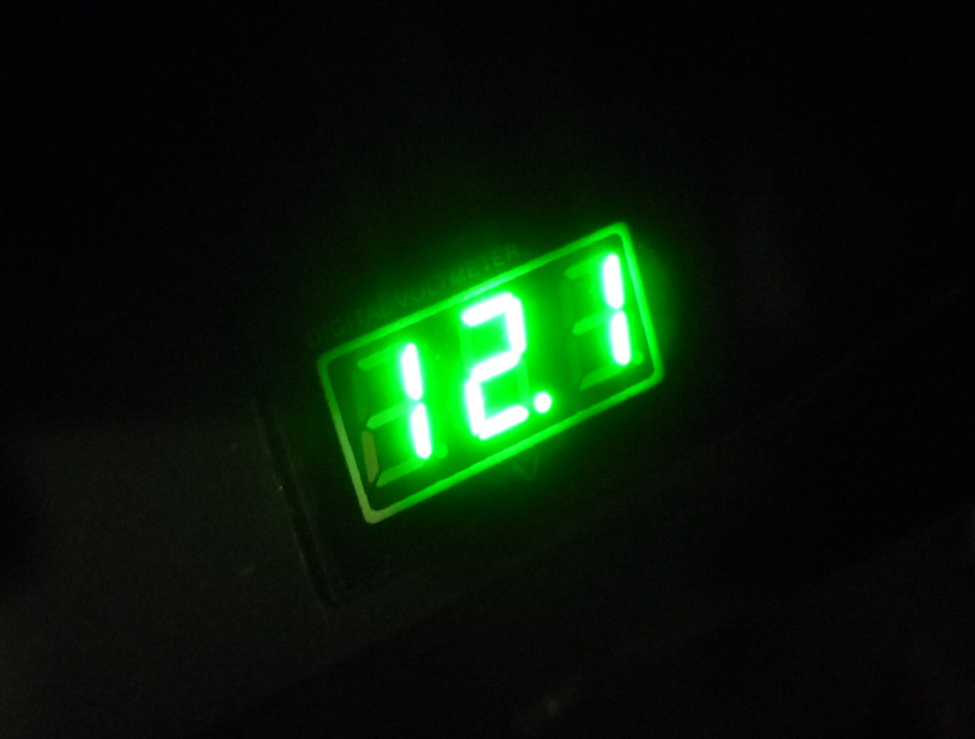

Get on of these from ebay for $4 and install. I watch my volts all the time when running with lights on. Most of the time, at working RPMs, I am fine with two 55w halogen lights, headlights, blinkers, amd LED rearward facing lights. At idle, about half the lights can still get me a charge, but not all of them on. Makes me less nuts to be able to glance down and know I am 13v+ and not worrying about the battery.
This is with the key on just to show placement, so don't mention the 11.9v. I wasn't going to start the tractor just for a picture. Easy two or three wire connection and maybe ten minutes time.

I was going to mention a voltmeter, as well. I am not sure that just because you are showing 14.2 volts you aren't over-taxing your dynamo or alternator? Still, the voltmeter is a simple and handy way to monitor your tractor's electrical system. His owner's manual should tell him what sort of charging system he has, but I looked up my L3400, and they list a 40A alternator, so perhaps the 60A I guessed at would indeed by for cabbed tractor!
