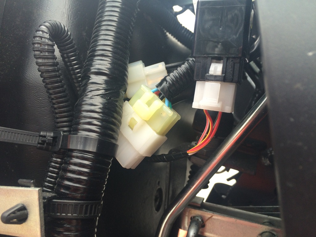

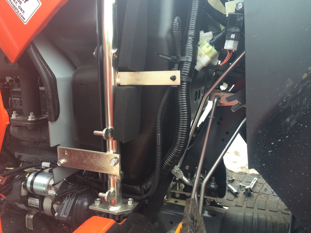

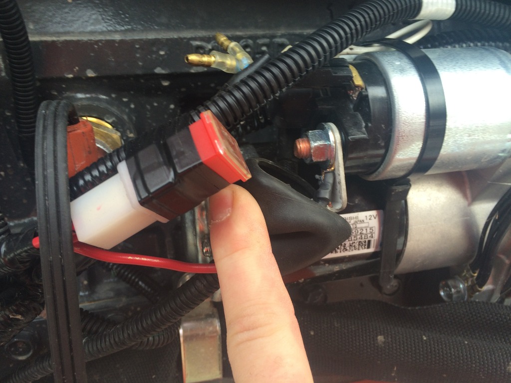

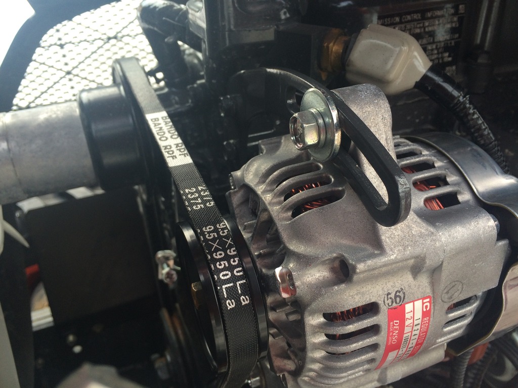

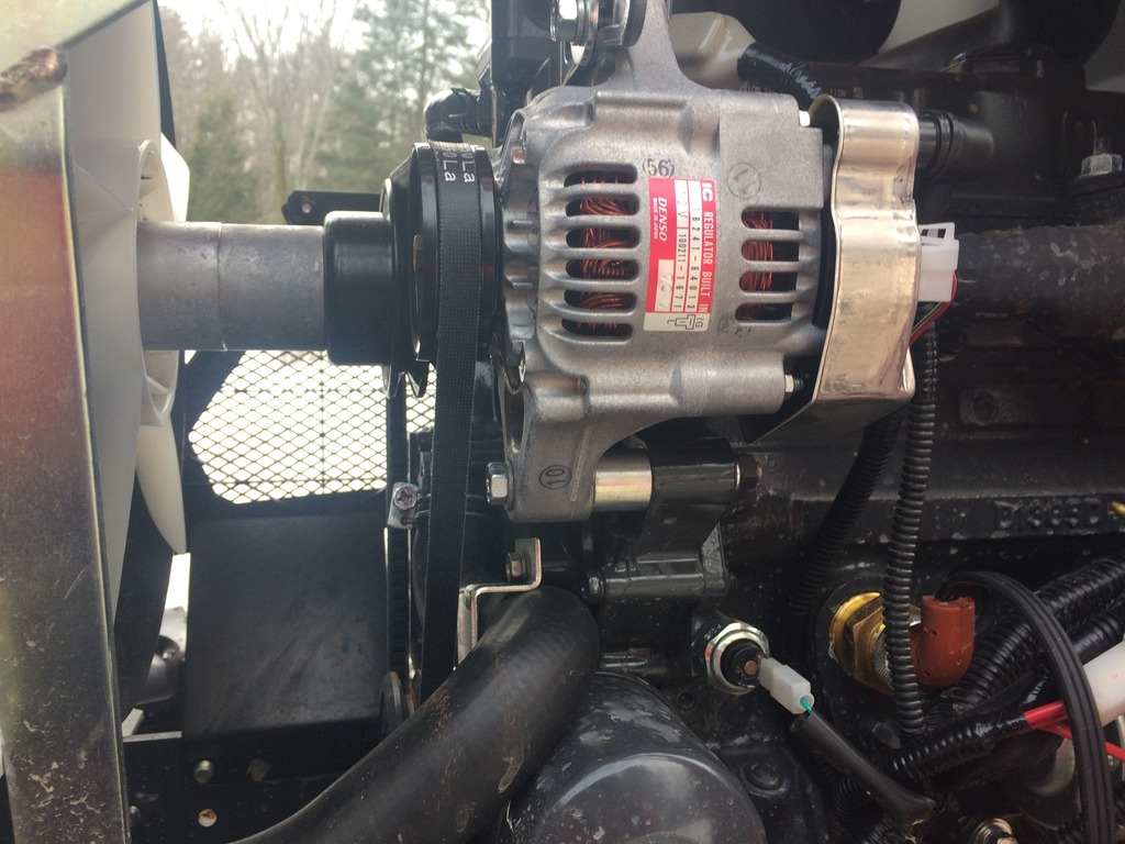

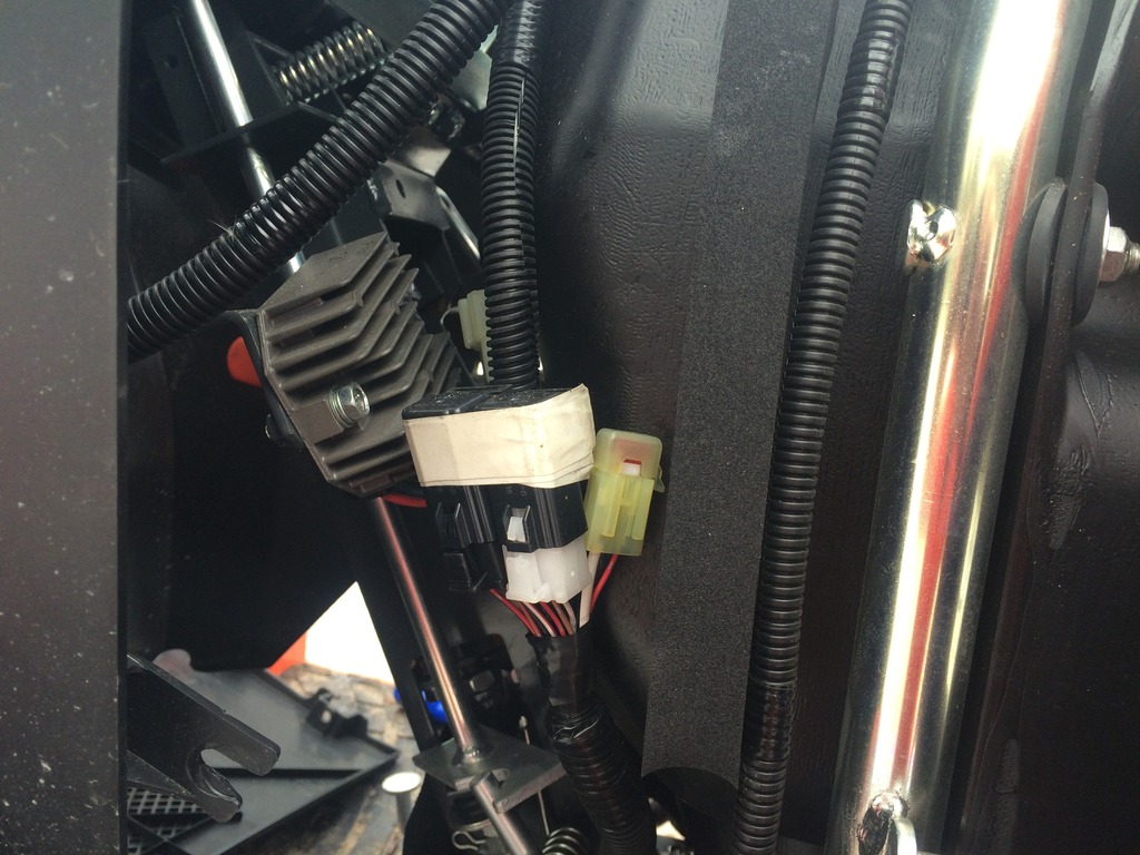

Had a few minutes and some decent weather so I pulled the panels off to get some more pictures for those that asked.
Here's the alternator and you can see the spacer on the lower bolt.
Here you can see the upper bracket, only slightly different than the factory one that came on the tractor.
Here is the wiring going to the positive cable stud on the starter, it has a 50A fuse inline to the alternator.
This is from the right side of the dash panel, the regulator is unplugged and the wiring is passed over to the left side to be plugged into the new harness.
This is the new harness routed up inside the dash panel.
Here you can see the connector that plugs into the harness that was going into the regulator. There's also a relay on the new harness that gets bolted down beside where the connector is, just to the right in this picture.

Sorry to get back to this project so late. I did end up getting the kit in back in April so my dealer was right on for that ETA. I just now had the chance to get it installed. I'm happy to report that this is as easy to install as KyleH described it. The directions aren't all that great but it is pretty much common sense. There are extra parts left over and I needed to use the washer and nut from the lower mounting bolt but it all went in smoothly. The only confusion I had was where the red wire gets connected to. The directions show a bolt with three other wires and there are three different bolts that have wires attached like that picture shows. I looked at Kyle's pictures and went off of that. The irony is that connection looks the least like the picture but it works great. Everything tested great so I am happy with the results. I would definitely recommend this upgrade and can assure you that you can do it. Thanks again to Kyle for his input.

Good to hear you got it installed and working. The red wire you are referring to is the one from the alternator to the starter? If so, it just goes to the starter positive stud which also has a wire coming from the battery.
