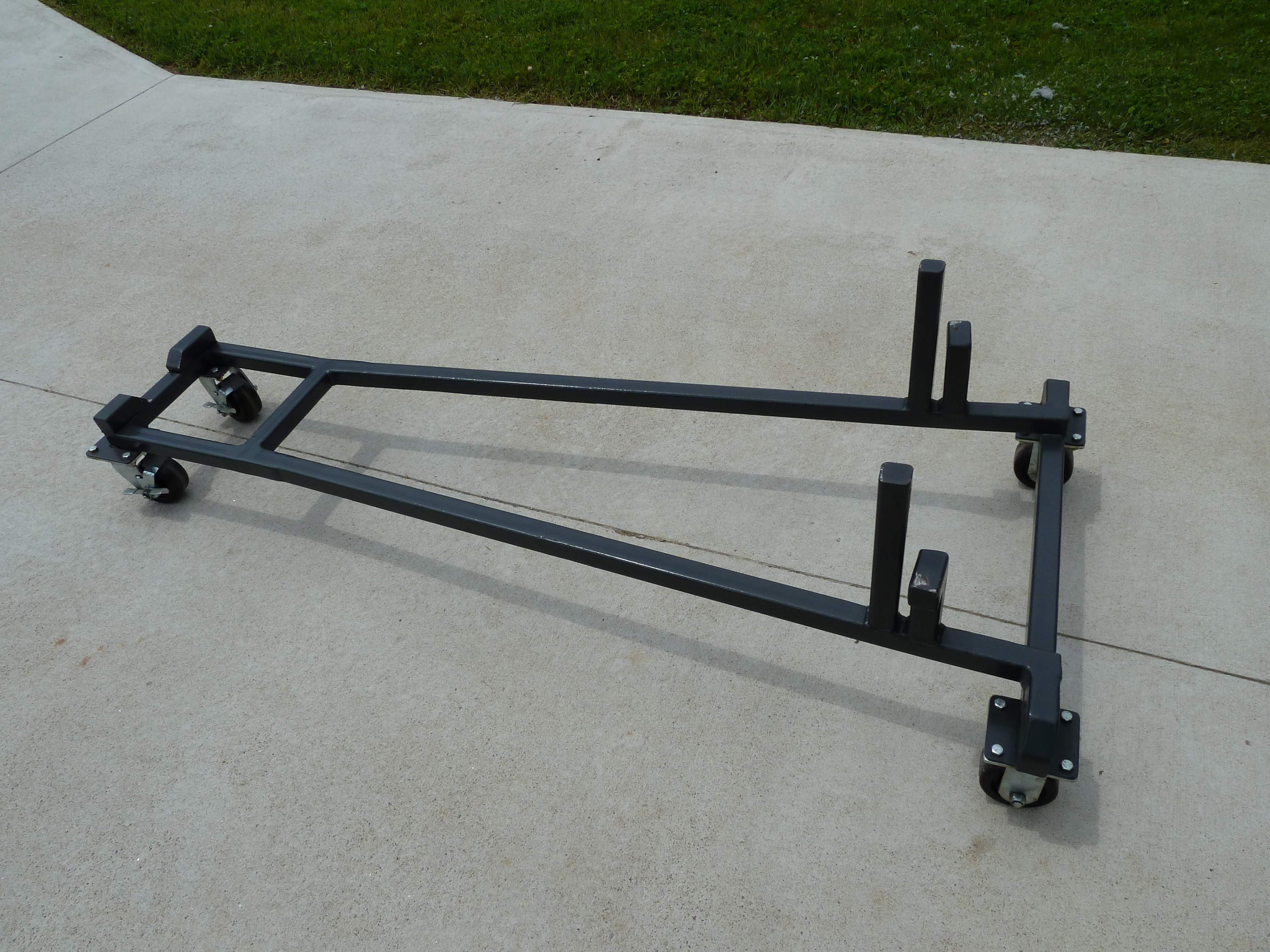

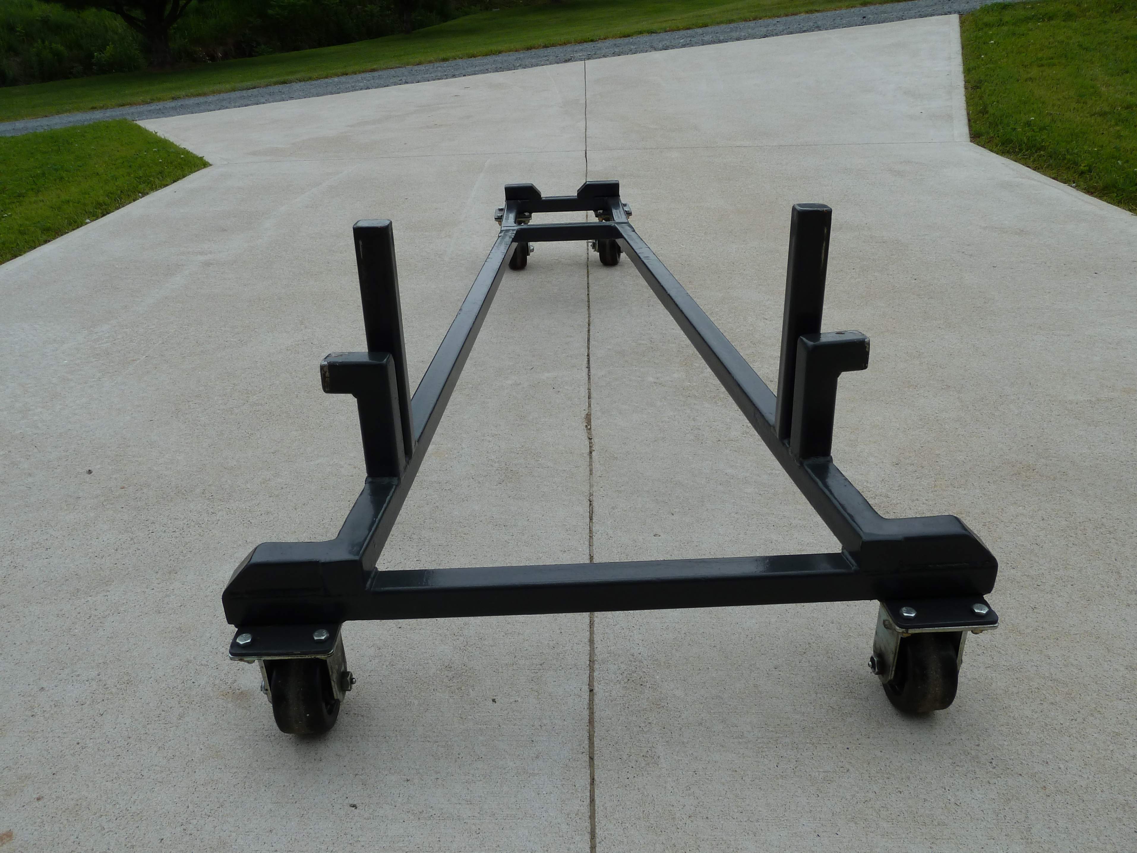

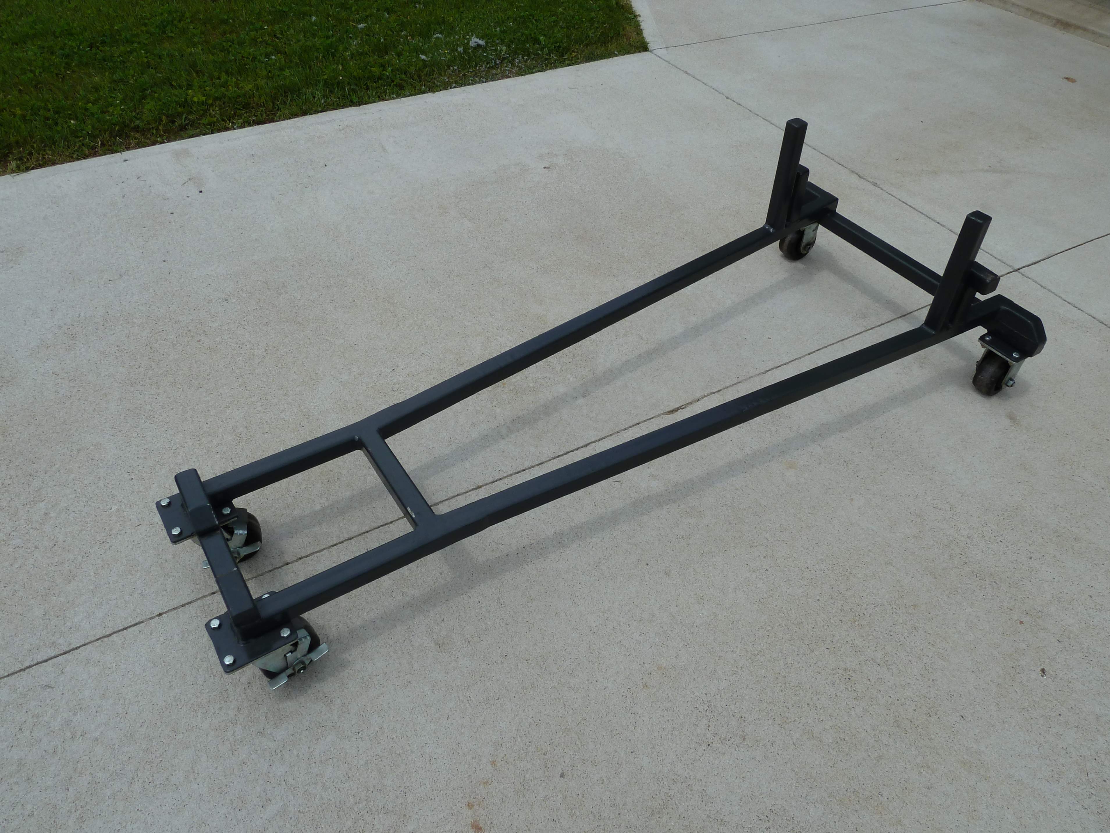

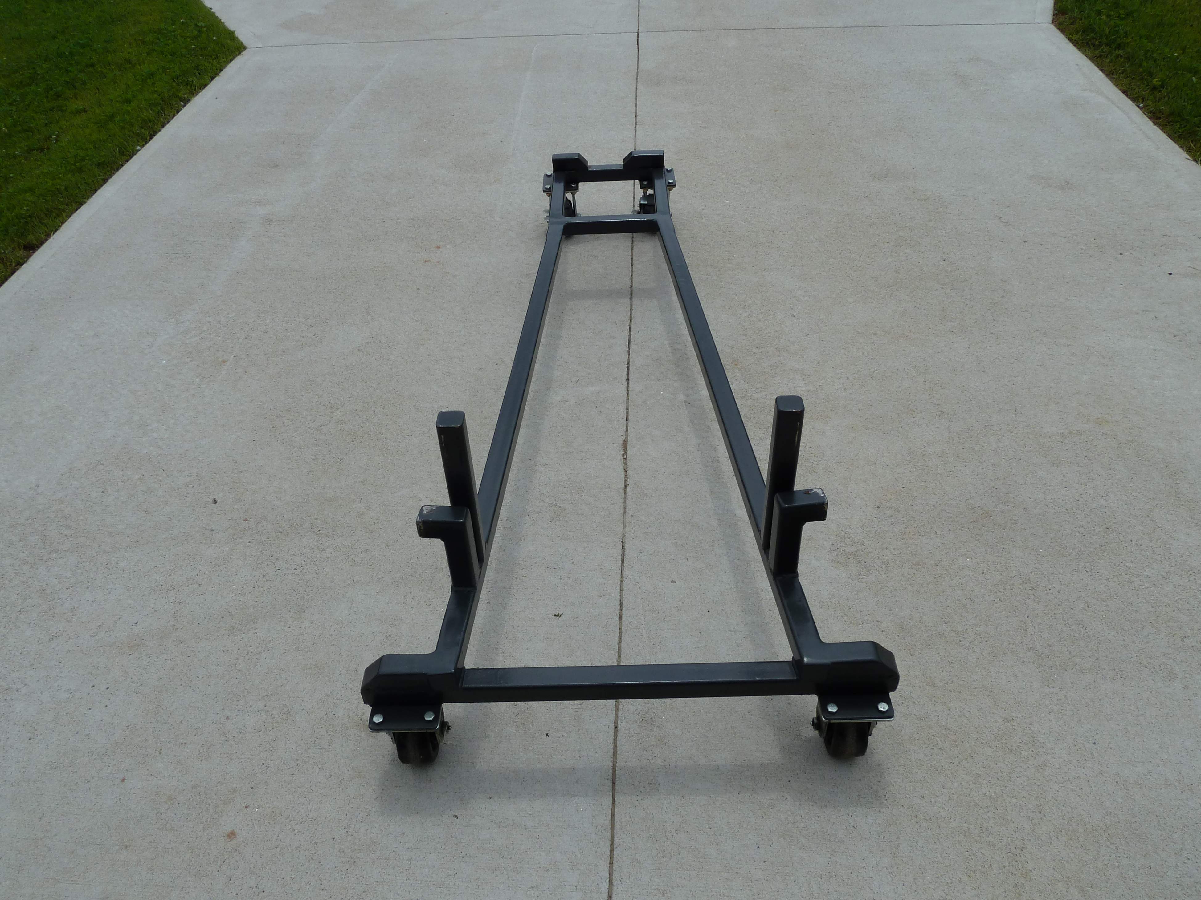

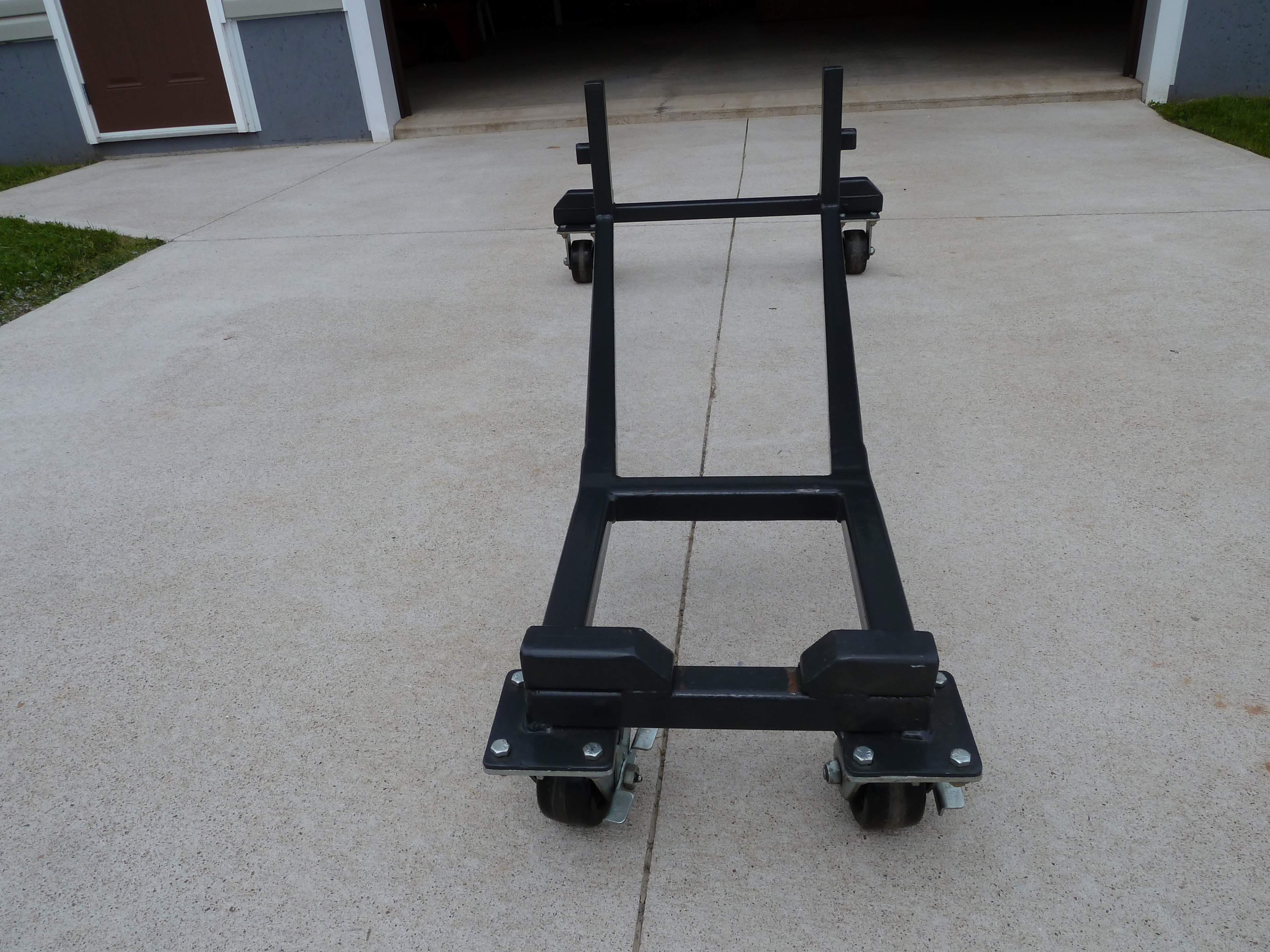

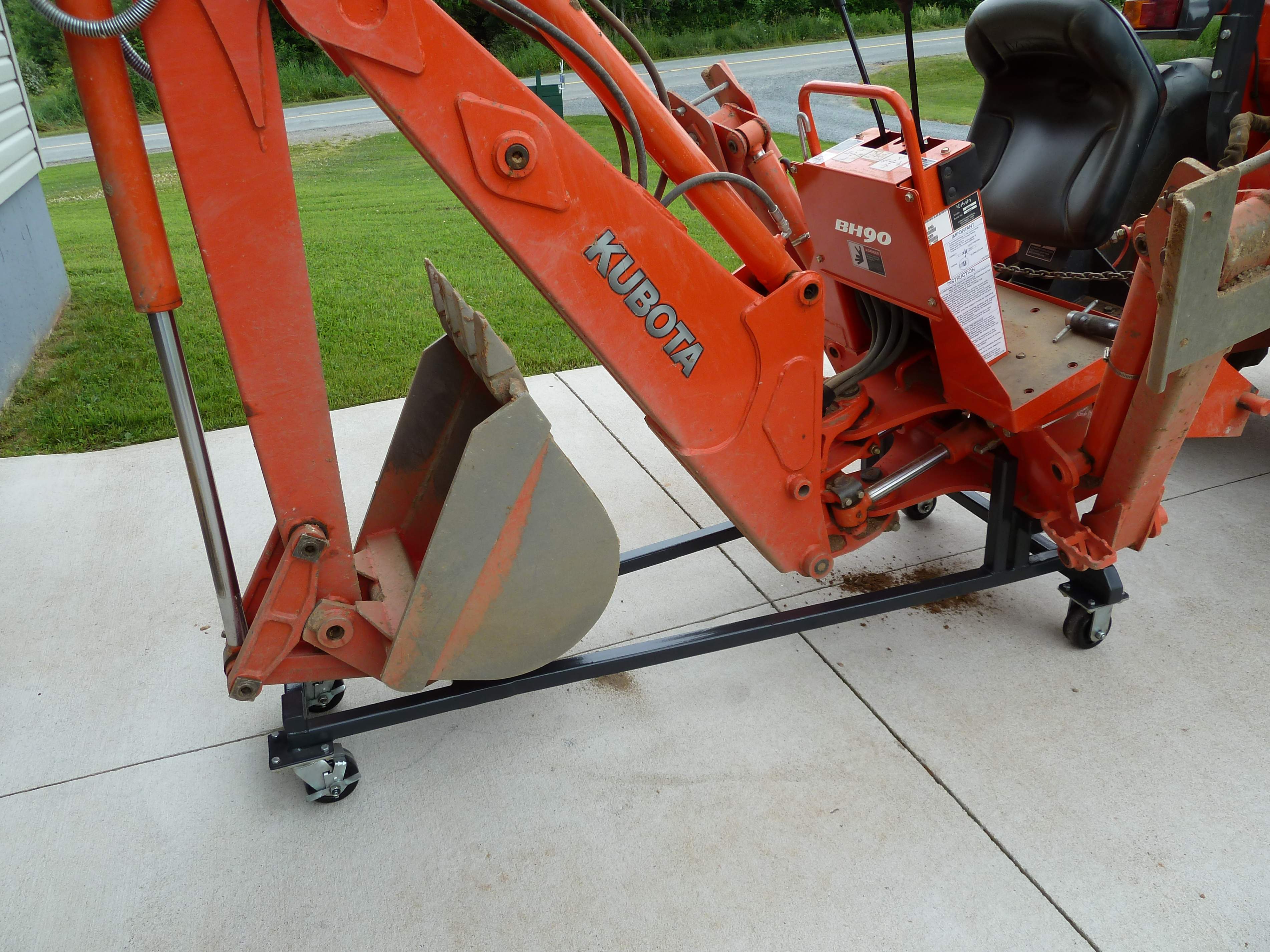

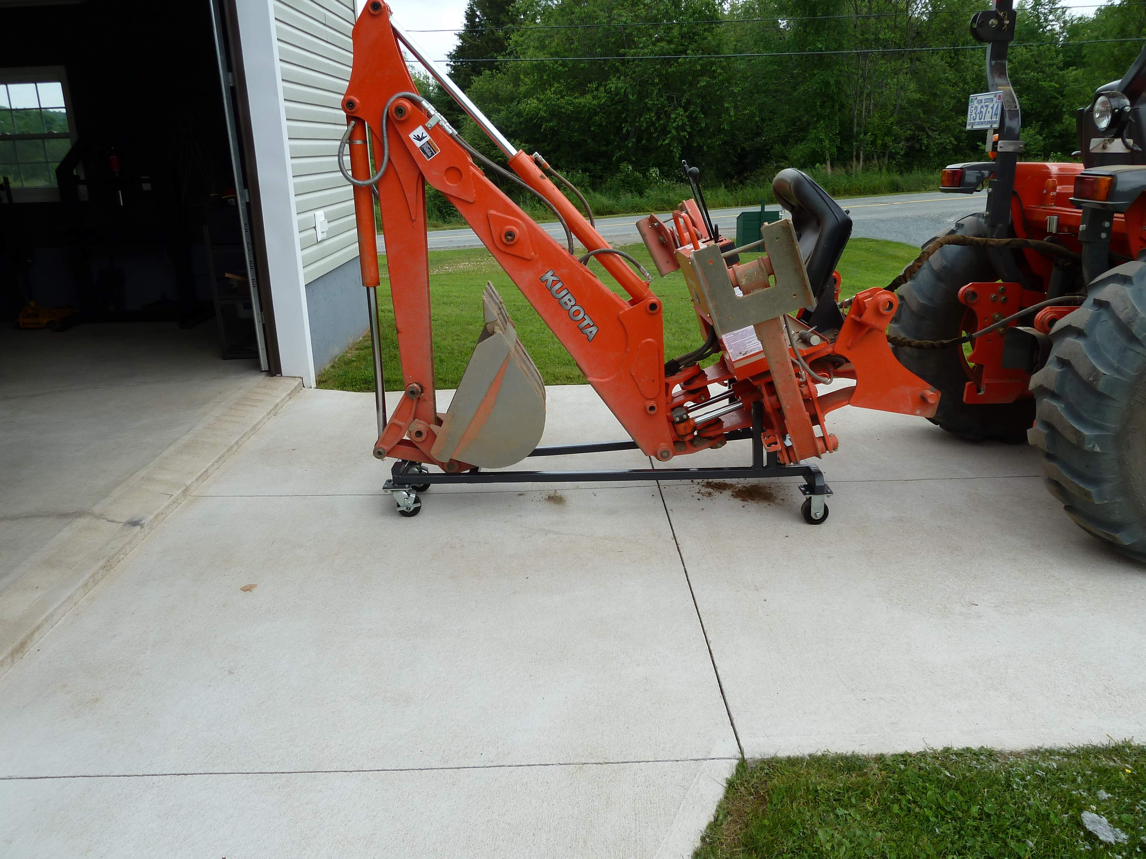

Here are a few pics of my backhoe dolly.Originally I made it for my BX25 but modified it to use with my L3240 and BH90.I find removing the backhoe with the dolly to be very easy,it is more work to attach the TPH. P1000154.jpgP1000153.jpgP1000152.jpgP1000151.jpgP1000150.jpgP1000159.jpgP1000162.jpg

Thanks for the photos. That looks like a Factory made product. I'm not a welder so in my mind I'm picturing 4"x4" wood as my material unless someone did it with 4"x4" and theirs didn't work. It looks like the weight is fairly well close to over the wheels so maybe won't use 4"x4".
I guess I can measure my BH at the contact spots to get the dimensions.
Every time I see some great welding/metal made item I almost get drawn into buying welding equipment but then I realize I've never welded and know zero/nothing about how to do it so guess it's one of those things I'll wait and learn in Heaven when I get there.:cool2:
