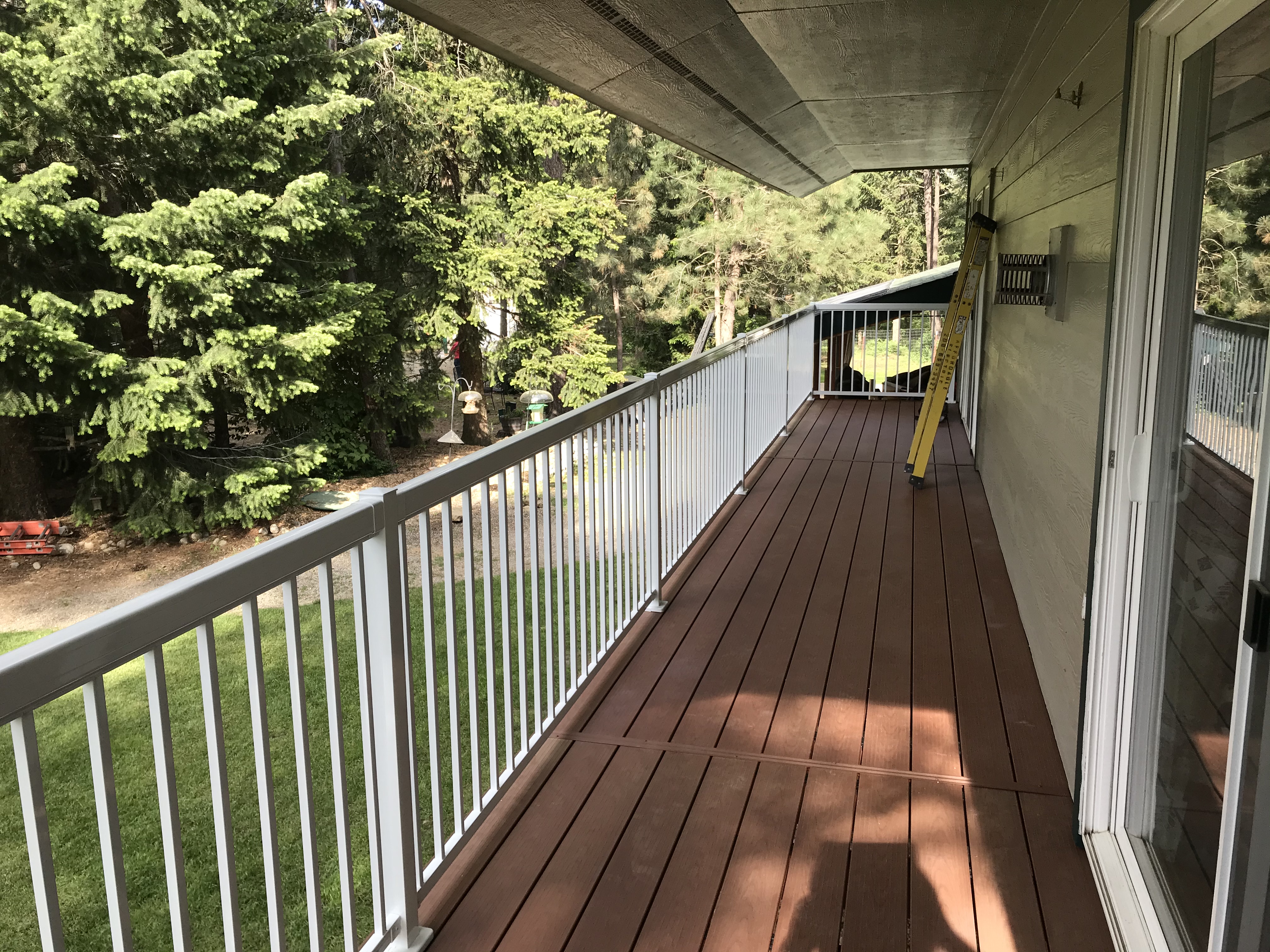

If you get lots of heat.... look at aluminum decking. I used nexdeck aluminum. Non slip, stays cool in summer. Powder costed. View attachment 664401. I was going to use trex till i talked to a few locals here that had it. They all complained about super hot in summer and slippery in winter. Also some buckling issues.
How does the price compare to trex? What spacing are your joists?

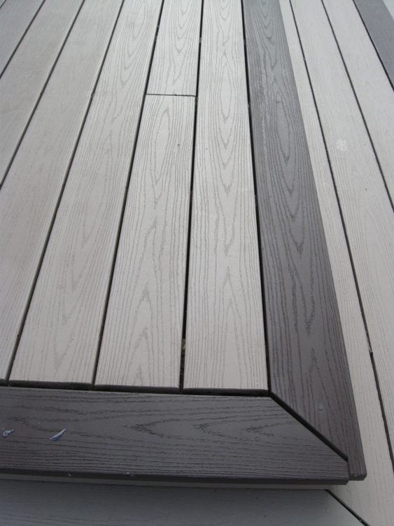

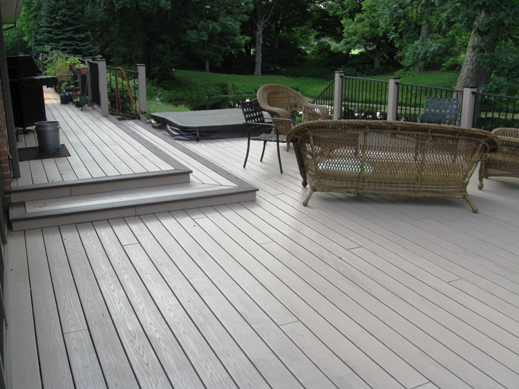

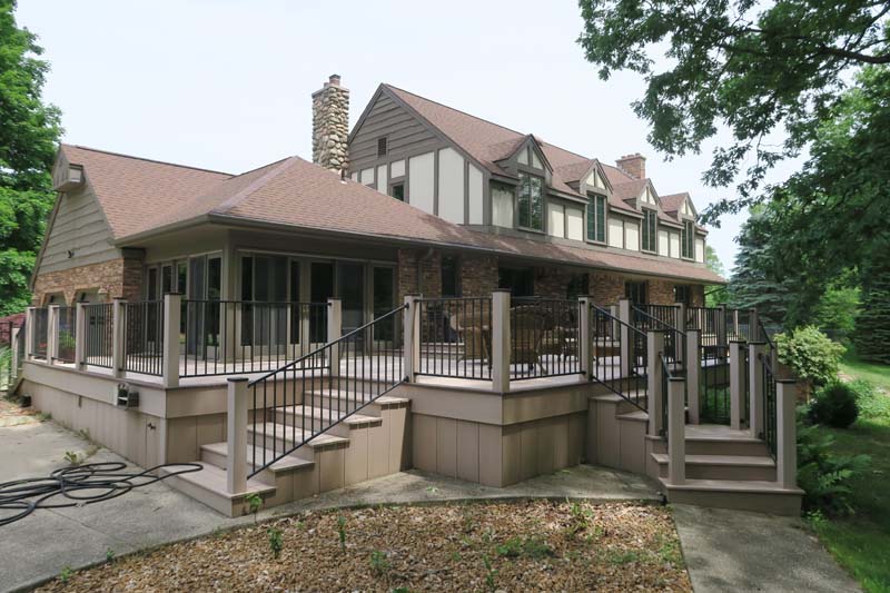

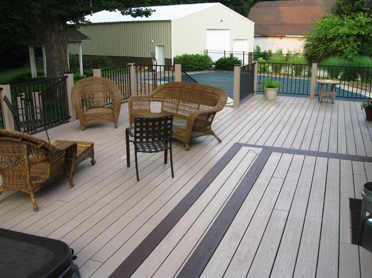

Here are some photos of my Azek deck. Note the use of contrasting colors at the edges of the steps. I think this has turned out to be a valuable safety feature in the design. The posts are 4 x 4s that are covered with the Azek post covers and topped with a section of decking that was painted black.
View attachment 664427 View attachment 664428 View attachment 664429 View attachment 664430
Kenny that looks very nice.I see your from Michigan,where did you purchase your azek from?Thanks.
