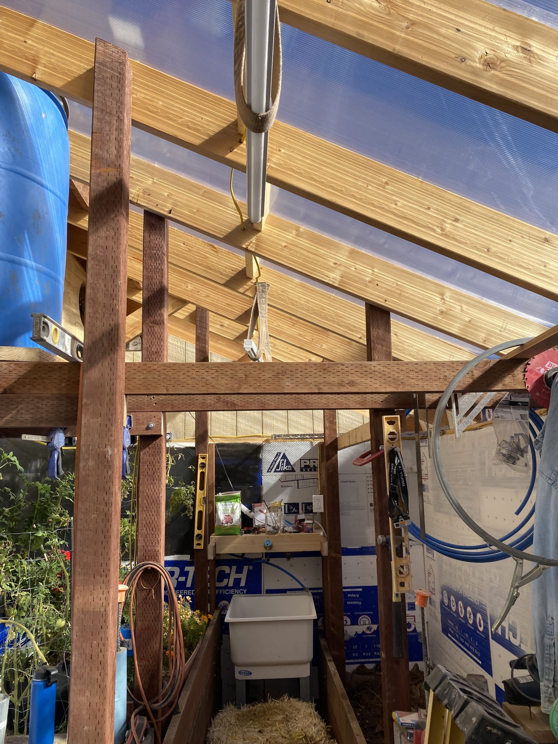

I finished the electrical and the plumbing. The blue barrel I painted black today and filled it with water. The plan is that it will absorb heat during the day and then release it during the night.
/ AZ ranch
#1,485

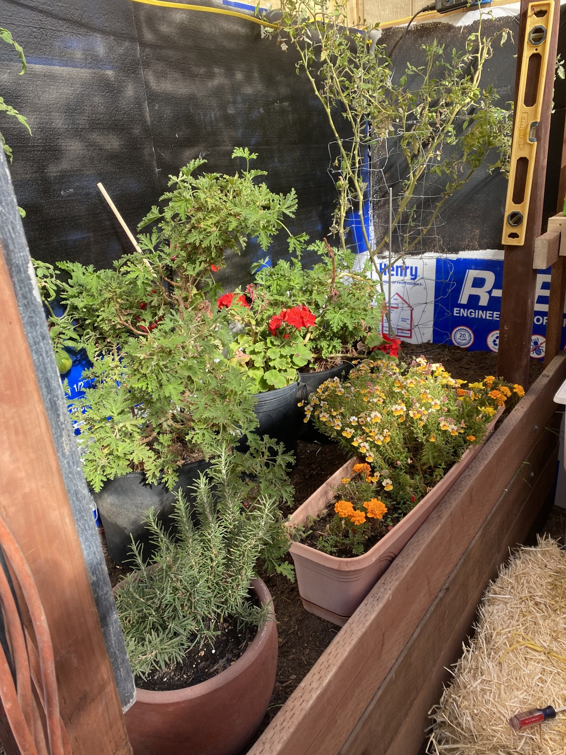

I transplanted my tomato plants into the green house and they are doing way better than they did all summer.
Last week I planted kale seeds and beet seeds. Both are coming up in the last couple days.
its been getting down to the mid twenties at night but it hasn’t gotten below 42 in the green house so far.
i might need some supplemental heat if we get down to the teens.
The. Daytime temps have been around 54 degrees lately. I have the exhaust fan set to kick on at 90 degrees. Otherwise it will get to over 100 in there.

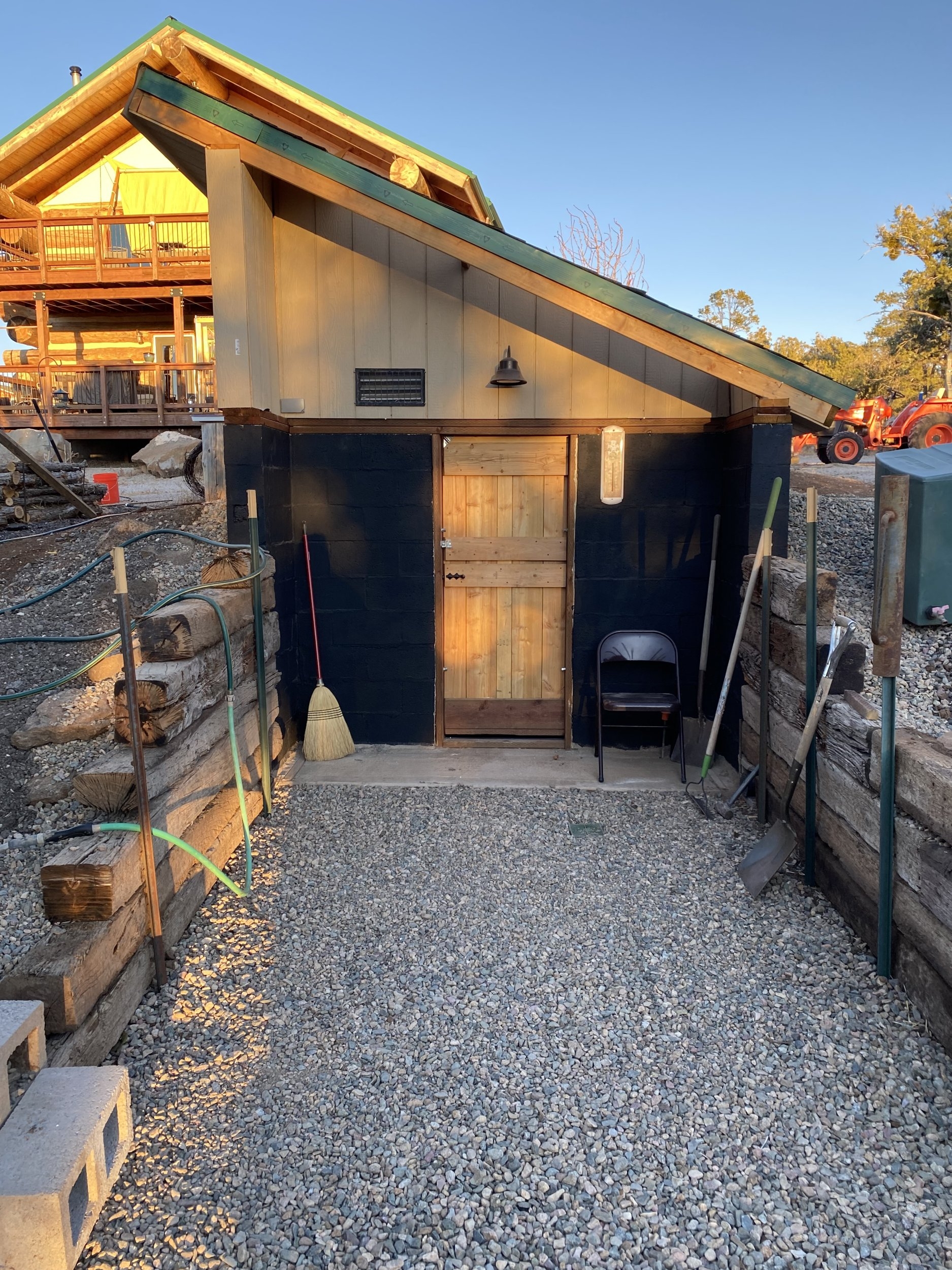

The water barrel and a piece of insulation over the inside of the door made a big difference. Last night it got down to 22 degrees outside. In the green house it bottomed out at 52.
