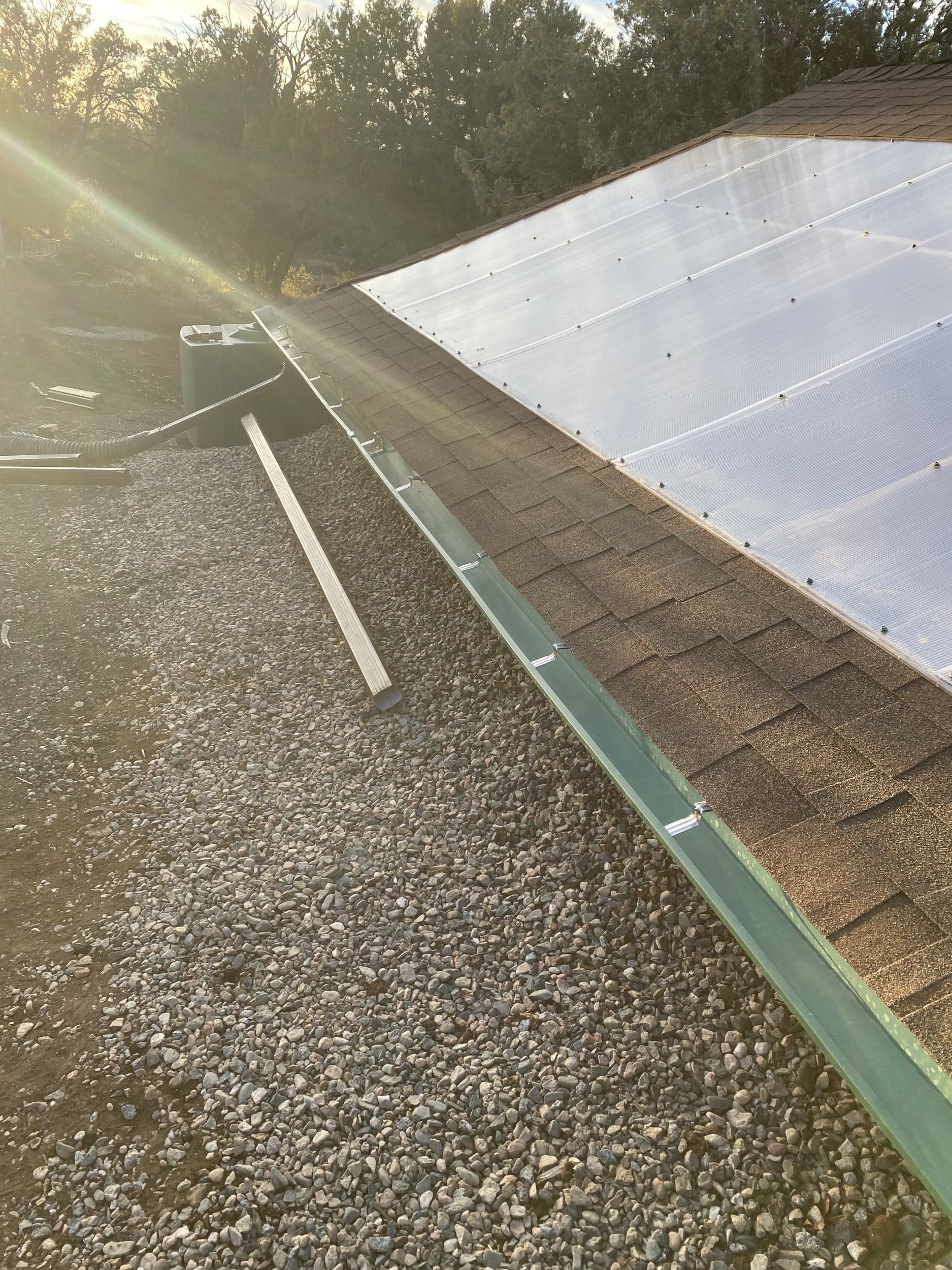

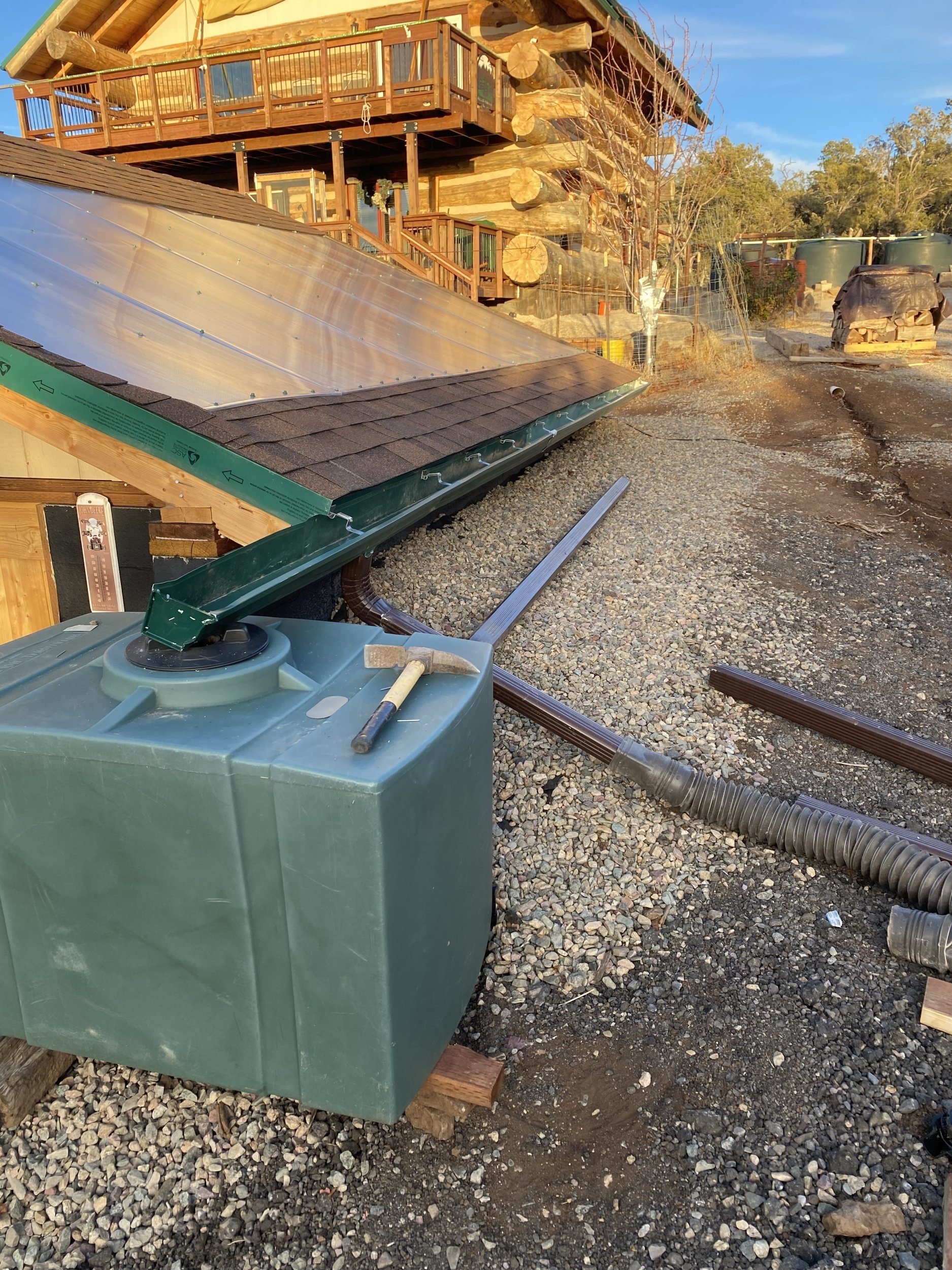

Installed gutter today. For now the water will run down the downspout and away from the green house. In the Spring I’ll block the hole to the downspout and drill a hole near the end so the water goes into that holding tank.
/ AZ ranch
#1,500
I’m very happy with the Walipini so far. Temps at night have been in the mid twenties and it is staying about 45 inside at night, with no heat source.
Daytime temps have been in the upper forties and it gets up to 100 inside.
I have kale about 4-5 inches tall; beets about the same; romaine is about an inch high; and I’m still waiting for my carrots to break through. The tomatoes are doing great. I expect to be doing some harvesting by the beginning of Feb.
